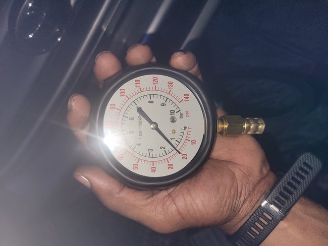

I was finally able to get the pressure tested. I have attached a picture of where the reading finally settled at idle after warming to temperature. initially, it was a high as 40 PSI according to this reading at startup. I have a BlueDriver OBD Scan tool as well as using Torque Pro on Android so I'm going to see what kind of readings i get on the oil pressure from those.
Hopefully, the great ideas are abundant! Thanks again for your help.

Okay, 20 is low. Now, with the gauge still installed, put the truck in gear to lower the RPM and see if the pressure drops.

been a while, with no issues I might add, but I'm circling back to this issue. According to the specs:
Oil pressure
at idle speed .................... 29 kPa (0.3 kgf/cm2, 4.3 psi) or more
at 3,000 RPMs .................... 294 - 588 kPa (3.0 - 6.0 kgf/cm2, 43 - 85 PSI)
isn't my 20 PSI reading (see pic above) quite high for idle? Am I misunderstanding the specs? I have a helper now who can hold and read the gauge while I run the RPMs to 3,000. According to my understanding, the psi should increase when I run the RPMs higher, correct?

If you are getting 20 PSI at idle, that is fine. The minimum is much lower.
As far as your readings at 3,000 RPMs, you are correct. As the engine RPMs increase, the pressure will also. The oil pump is mechanical, so as it turns faster, the pressure increases.
What pressure did you get at 3,000?
Let me know. Also, let me know if this is what you needed to know.
