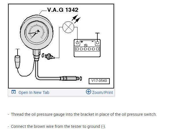

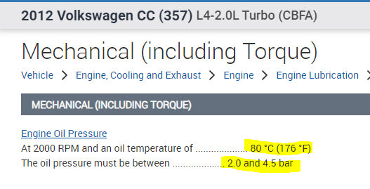

Pretty much most of these VWs and Audis have same issue of this message. Some i am aware of are due to engine parts clearance, others are oil and filter while others the sensor. How many volts should i get at the sensor with ignition on and engine off? And how much should i get for oil pressure when cold idling and then at 2,000 RPMs?
Dec 2, 2023 at 6:11 AM
  • 110,241 POSTS

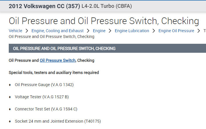

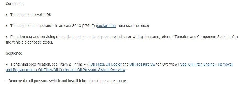

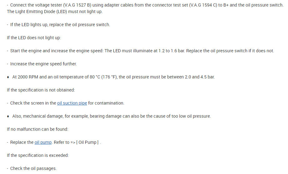

Have you checked for diagnostic trouble codes? Also, they don't provide us with the specific voltages for testing. Instead, it requires a specific fuel pressure gauge.
As far as a power signal voltage is concerned, I would suspect it to be 5v.
I attached the directions below for testing. Take a look and let me know if you are comfortable performing them.
