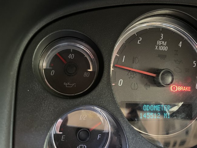

Dear Experts,
I have the SUV listed above Denali. I noticed that my oil level gauge drops below 20. The truck is running fine with no lifter or any other engine noise when revving.
The oil pressure easily goes up to 40 while accelerating.
Help needed. Thanks in advance.

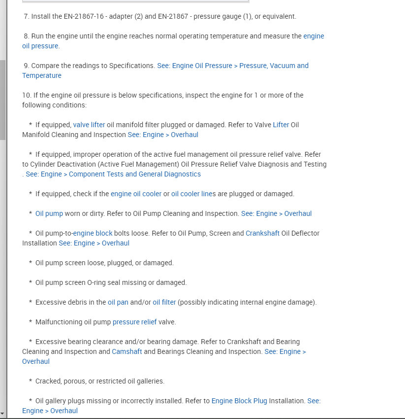

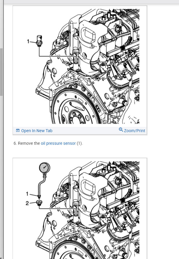

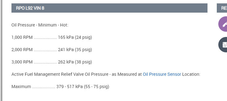

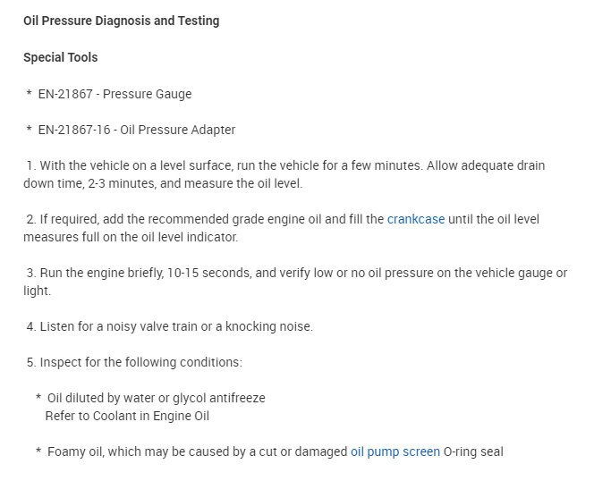

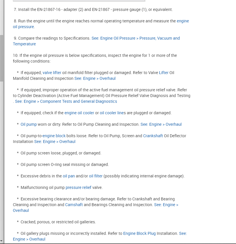

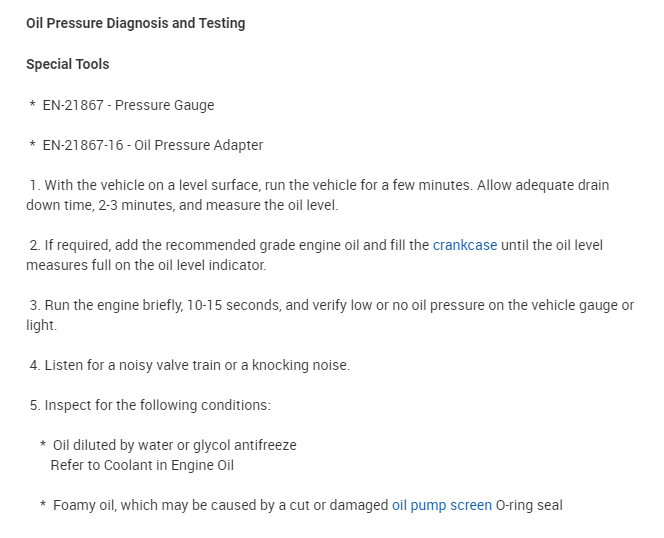

Let's start with checking to see if the oil pressure gauge is accurate.
To do that we need to follow the info attached below to check the pressure.
If this is accurate than the typical causes are a pump issue, increased tolerance in the bearings.
Here is a guide that talks more about this:
https://www.2carpros.com/articles/high-or-low-engine-oil-pressure
At this point we don't need to worry about it if there are no noises, but we need to start by checking this info and not wait for there to be a noise.
If the pressure is low, then we can add an additive to thicken the oil and that will help get the max life out of this. I would not use a thicker oil, just use an additive like Lucas Oil.
Let's run through this info and let me know what questions you have.
Thanks

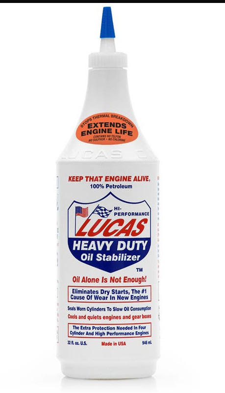

There are a ton out there, but I have used Lucas oil before and I like it.
Take a look at the picture below of what I am referring to. The way this works is you substitute this in for some of the oil in the engine. So read the bottle to see how much you need to use based on the amount of oil the engine uses.
Let me know what questions you have about this.
