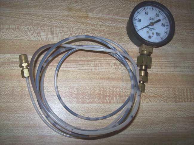

Maybe the first thing to do is to remove the oil sender, install temporary mechanical oil pressure gauge. you can make one like mine (picture below), or buy an under dash mount unit (do not mount it). Run it out from under the hood and into the cockpit. This will give you a "real" pressure reading to compare to what you already have. This might affirm your pressure is fine and maybe your sender or dash gauge is bad.
