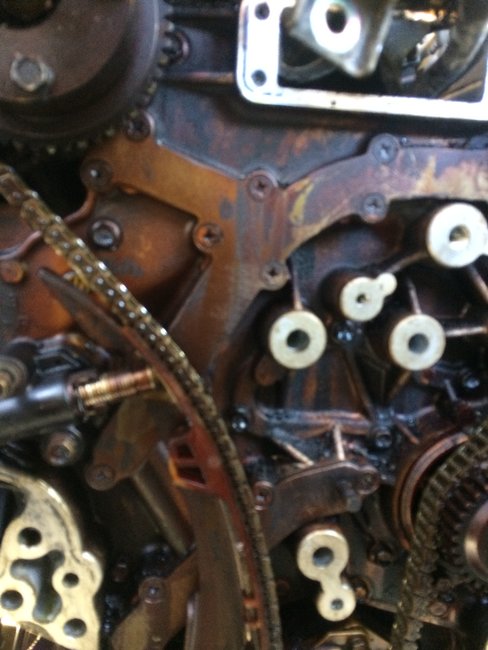

My timing case had oil (see the photo) in it and didn't look like everyone else's online, which is why I thought that it was the main oil gallery. In addition to the low oil pressure and the loss of power, It seems that my noise occurs when it is warm and I hit the gas (with a slight delay). I think i'm hearing slack in the timing chain (which is why I think that the timing chain guide broke originally). Here is a photo of the timing chain case prior to when I repaired the main timing chain guide. You can see there is dried oil in the case. I thought it was really odd when I had it open. This is why, more recently, I thought it might be an oil gallery leak causing my pressure loss.

what you see is sludge and varnish and can be from oil used or how often changed etc. also re reading you rfirst question it says after you replaced timing chain so I would suspect either a pump problem or partial blocking of pump pickup or an air leak there.if you take the pump off pack gears with Vaseline prior to starting as well and make sure pickup has good connection to pump. but i'd try 20w oil first prior to taking pan off see what you get there, if it still drops then it may very well be a bearing problem.

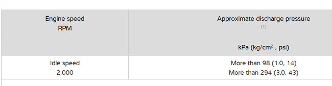

I tested the car with the 20w non detergent oil. When cold, I got about 40 psi at idle and then it dropped to about 30 psi as I was testing. When cold at 2,000 rpm it was 60 psi and then dropped to 50 psi as i was testing. The oil pressure seemed to bounce a little.
After warm up. There was 0 psi at idle and around the same 3 psi at 2,000 rpm (same as prior to the oil change). There is a hesitant buzz/rattle after I hit the gas when warm and the psi is low. The sounds seems to come from the passenger side rear exhaust pipe before the muffler. I thought it might be an exhaust item, but it really only appears when the car is warm and when I have low psi, so I'm more suspect.
Overall, I didn't really notice a difference from my last test. In both situations the psi drops lower and lower as it warms up. I'm not sure how accurate the gauge is if we are trying to notice a slight difference, it is a new 8milelake Oil gauge- it had fine reviews for a $55 gauge online.
I see a common problem w/ this engine (VQ40DE) on Nissan and infinity is the rear timing cover gaskets leaking and causing an internal leak. I'm not sure if that is something that you have heard too. There was that timing cover sludge in the engine as I made the initial timing chain guide repair. As I was cleaning some likely drooped into the oil pan. Could that cause a blockage and this issue?
Please let me know the next things that I should test. I'm really determined to solve this. I've been at this for about 7 months. Thank you for your help.

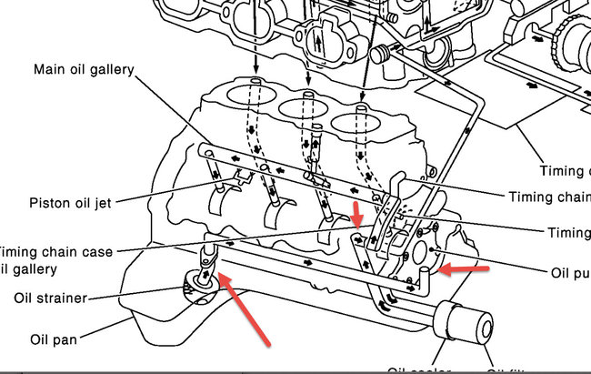

I am really out of ideas from the diagram i'm sending the oil lines go no where near the rear cover so I would rule that out and I see no tips from other mechanics for this problem. If I were you and you REALLY want to put the time and energy into this then where arrows point I would look for a problem there or partial blockage. because if it's cold and has good pressure then gets warm and drops but from your testing the second number is warm i'm assuming so with heavier oil in it drops about 10 psi so it leads me to a bearing problem. or leaking where I've pointed out that is all I can think of. from the factory chart shows only 14psi at 2000 rpm when warm and ALL oil will drop when warm see pics

Please see this article regarding leaking oil from the gaskets in the timing cover and pressure loss.
https://www.motor.com/wp-content/uploads/2016/01/4_FOREIGN_SERVICE_0116.pdf
I did notice that there is a bit of smoke at warmup from the tailpipe when i had the 10w-30. I never did the idle relearn for the nissan (required because I cleaned the throttle body), I just assumed that the extra smoke had to do with running rich on startup. There is a smell associated with the car running, but I don't know enough to say what it is (whether it is coolant burning)- or it might be in my head. The mechanic previously said the cats are bad. Would a head gasket cause the oil pressure to act like that? I did the coolant pressure test and it seemed ok cold. Did I need to make sure the thermostat opened? Should I get one of those chemical testers to rule out the head gasket? I mentioned the cap had some milky residue, but the oil hasn't been foamy or milky.
My wife said that she would have remembered low oil pressure showing on the dash before the timing chain guide repair (it was her car)- which confuses me. It makes me think that perhaps that the issue might be caused by something I did when replacing the timing parts.
Please let me know what you think about the article w/ the internal leak or potential head gasket.
