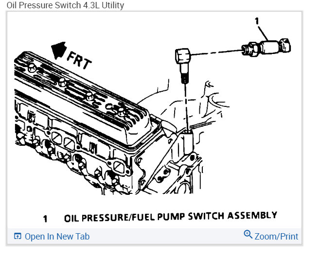

Oil pressure is normal until vehicle warms up and idling when temperature is normal. Then drops close to orange, but the engine does not make any noise. Could this be the oil pressure sending unit?

Yes, it could be the oil pressure sending unit. I would change the oil and use 20/50 which will keep better pressure. Here is the oil pressure sender location below.
Here is a guide that can help check out the diagrams below.

Sending unit fixed the problem. Thank you
