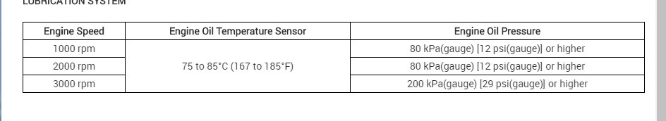

However, we need to check what the oil pressure actually is with a gauge in order to determine if this is a sensor issue or an actual low pressure issue. Here is a guide that will help explain the possible causes of low pressure:
https://www.2carpros.com/articles/high-or-low-engine-oil-pressure
Let us know what the oil pressure is with a gauge and we can go from there. Thanks

Thank you for the quick reply. The car is at the dealership now and they are running diagnostics. That’s one of the questions I will ask when they follow up with me later today. What is the normal pressure level?
Jul 9, 2020 at 12:50 PM
Sounds great. I attached the info but it looks like at lower RPM it is 12 PSI and higher RPM 29 RPM or higher. Take a look at the info and then keep us posted with what they find. Thanks

The oil pressure sensor was shot. Dealership replaced it under warranty. The car runs great now. Thank you!!
