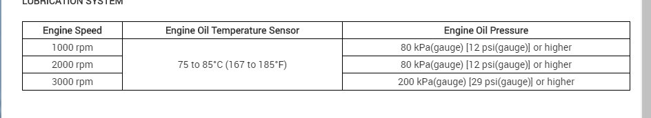

Thank you for the quick reply. The car is at the dealership now and they are running diagnostics. That’s one of the questions I will ask when they follow up with me later today. What is the normal pressure level?
Jul 9, 2020 at 5:50 AM
Sounds great. I attached the info but it looks like at lower RPM it is 12 PSI and higher RPM 29 RPM or higher. Take a look at the info and then keep us posted with what they find. Thanks

The oil pressure sensor was shot. Dealership replaced it under warranty. The car runs great now. Thank you!!
