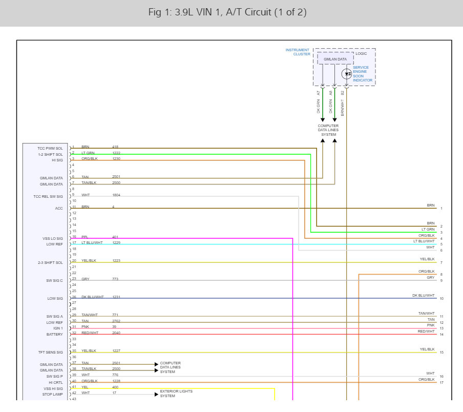

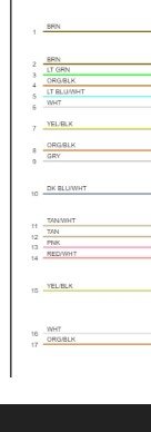

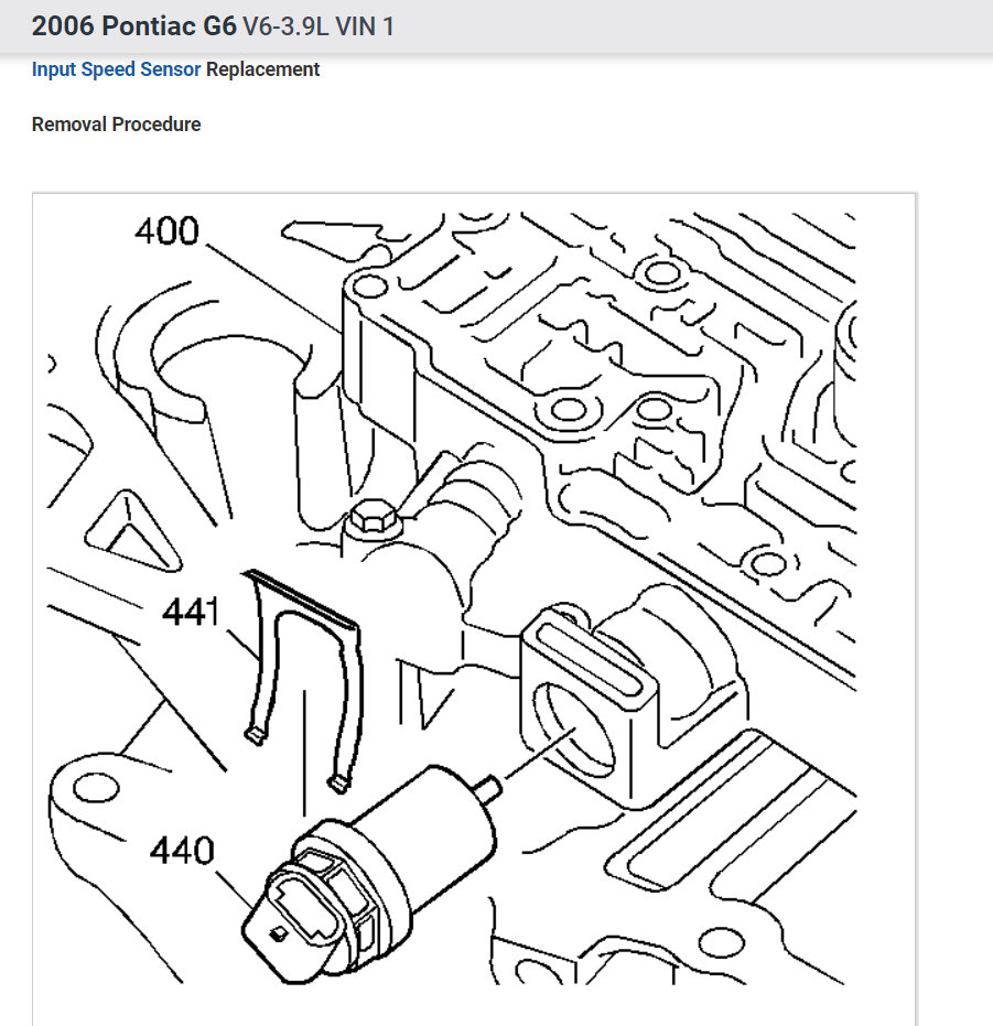

This G6 GTP 3.9 Transmission FR3 4T65E version has been registering ISS p0717 code for almost 2 years with no symptoms that the driver could detect. The ISS was replaced but that didn't erase the code. Recently, the TCM was replaced and programmed: Still no change. This past week, the 49-Way connector and wires to the TCM were replaced by splicing. The code p0717 was registered again. Finally- 2 days ago, the 20-Way external connector and wires to the transmission harness were replaced by splicing as well. When the job was done, everything was put back together except the Electronic Brake Module Connector was left unplugged *by mistake* as the car was being tested and the Key left in the run position for sometime. Later on, the connector to the EBCM was reconnected while the key was still in the run position and the scanner connected to the DLC *again, I think the key should've been turned off while reconnecting the electronic brake module.* The scanner initially displayed a message: "Communication with the Body Control Module was Lost." No code was registered. The car was taken for a drive cycle and the check engine light was actively cleared. Few minutes into the drive, the following occurred:
1. Code: p2534 Ignition switch/run low voltage
2. P0700 transmission
3. P0300 misfire
4. Check engine light blinking (not solid)
5. Acceleration began to suffer
6. Louder than normal noise
All spliced wires were rechecked for continuity.

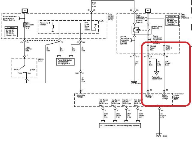

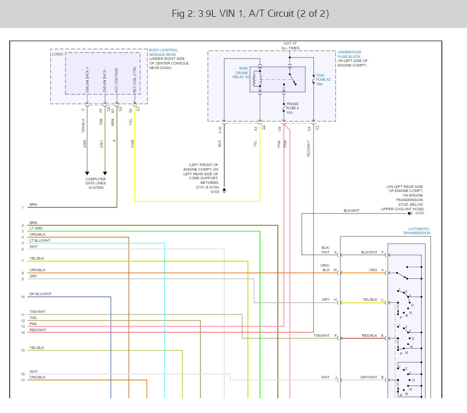

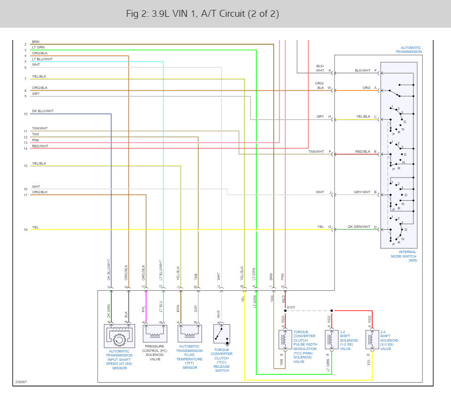

What happened? The ignition wire (pink circuit 1339 or simply 39) from TCM 49-way connector pin 31 to transmission harness 20-way connector pin E showed no continuity. Is this normal when the key is in the off position? Does this wire go through a fuse or fusible link? The wiring diagram shows transmission fuse 4 in the junction block but no fusing in the wire in between pin 31 and pin E unless I am not reading the diagram correctly. All other connections showed continuity
I am not sure if I should test while the engine is running or while the key is in the on position or for that matter while battery voltage and ground are connected. Could this be a simple splicing issue or more? I think the misfire is the result of low voltage rather than damage to ignition switch probably caused by ignition wire or ground issue assuming the EBCM incident was not significant. Before asking this question, I looked over and reviewed the pins, the wires and circuits related to the TCM-49 way, the 20-way AT harness, the BCM and the ECM. So, I should be able to follow advice. However, there is one part of the ignition circuit where the 31 pin at the TCM connector and the E-pin at the 20 way AT harness connector and the Junction block fuse 4 circuits that remains a bit unclear. I am thinking this is where the problem is. I attached the electrical diagram I had and circled the part that I am not sure about how to test.

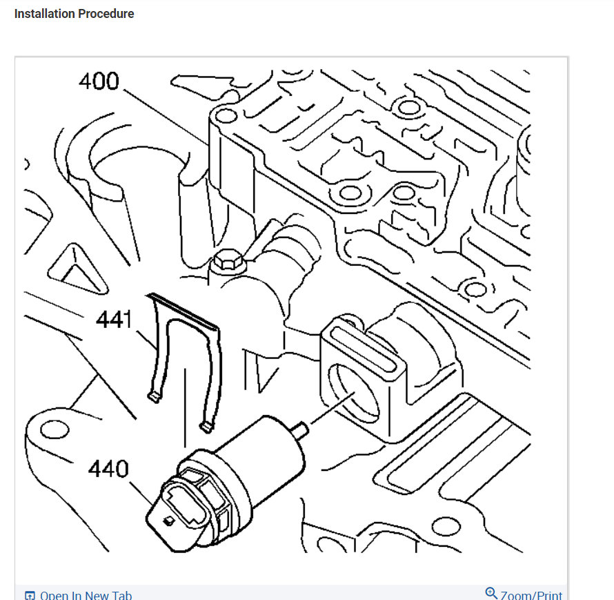

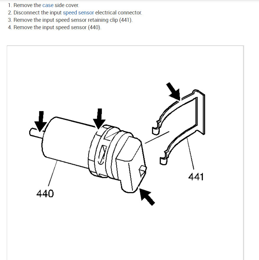

Code P0717 is triggered when the transmissions' Input Speed Sensor isn't providing a signal. Lets replace the input speed sensor. here is how in the diagrams below. Check out the diagrams (below). Let us know what happens and please upload pictures or videos of the problem.

So, I replaced the ISS and no change. However, as you may have read my recap on the work I did, the issue now isn't an ISS code (which most likely was resolved after Roy and I talked about splicing new connectors and harness wires) but a new problem I described in this question above. I will wait for an advice regarding the current problem.

Continuity should not matter if the key is on or off. Lets check the connection between the transmission and the TCM. this guide will help:
I have seen the BCM or instrument cluster cause issues as well. Let's do a CAN scan which is the future of automotive repair you can get a CAN scanner from Amazon for about $50.00. here is a video to show you how:

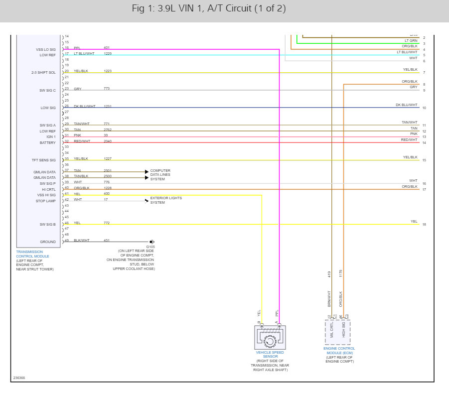

I appreciate the reply very much. I have actually spent the weekend mapping out the electrical connections and made my own spreadsheet of pins, wires, and circuits between the 20-way AT connector, 49-way TCM connector, the fuse block and ECM. However, I did not go into the internal mode switch and related circuitry yet although I know shift 1-2 and 2-3 solenoids are affected by an ignition 1 voltage wire disconnect (most likely). Can you tell me where the attached segment of the electrical diagrams you sent me belongs to (what module? what connector? etc.). I couldn't find the module or place where they are (examples: where does pin 13 PK wire belong? I know pin 31 ignition 1 voltage connects to it in the TCM and pin E in the 20-way AT connector. It also connects to C1 C9 in the junction block where fuse 4 is but I couldn't find pin 13 and the rest of the pins in that side of the electrical diagram). Attached is the segment I am referring to.
Jun 28, 2021 at 1:49 PM
  • 54,837 POSTS
It is pin #31 in the transmission control module.
Jun 29, 2021 at 8:55 AM
JAMESB2019
  • 42 POSTS
Okay, so pink ignition1 voltage wire goes from pin 31 (as you confirmed) and not pin 13 (in other words there is no such thing as pin 13). I say this because pin 31 goes to pin E in the AT connector and to pin 19 in C1 of the ECM and then to cell C2 F6 in the Junction Block where Fuse 16 is. This makes 1, 2, 3, 4, 5, 6, 7, 8, 9, 10, 11, 12, 13, 14, 15, 16 and 17 in the attached diagram only representation not actual pins a particular module or block or connector. Right?

  • 54,837 POSTS
That is correct.

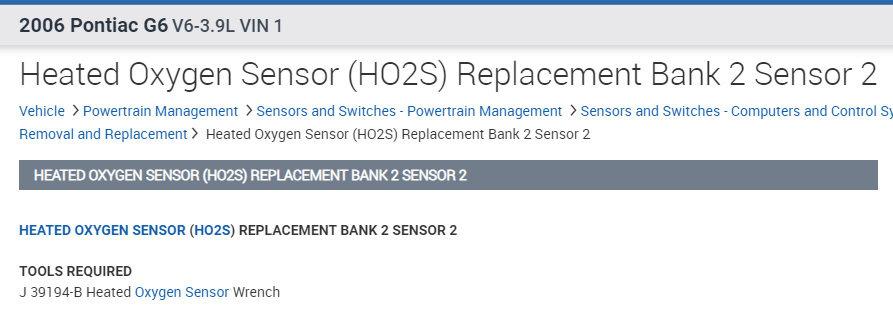

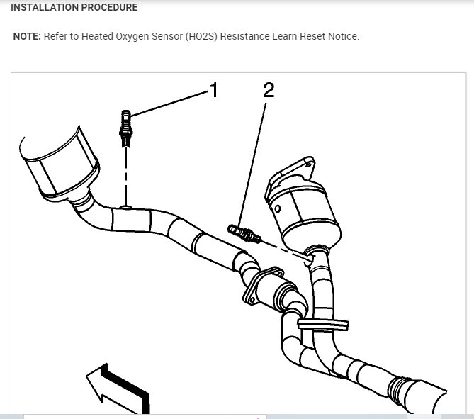

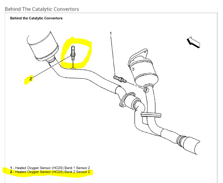

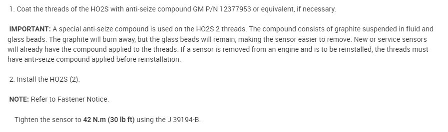

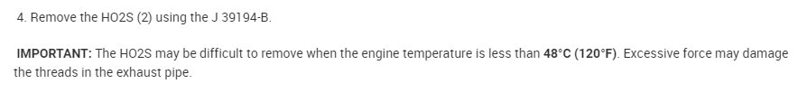

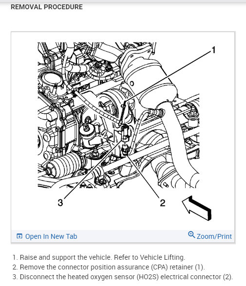

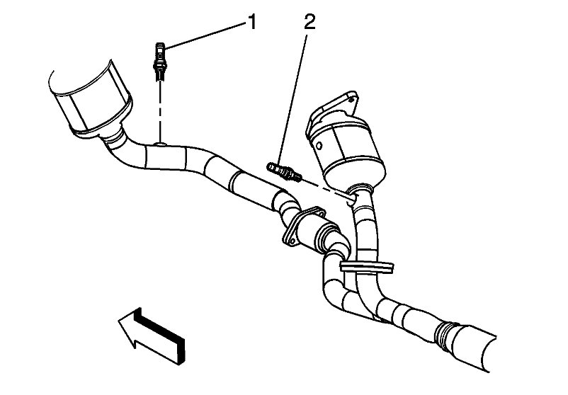

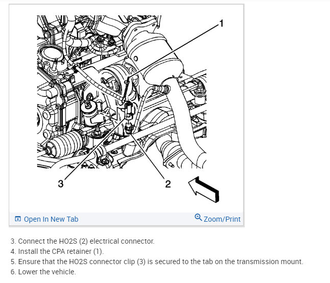

Wow, what a nightmare. However, I'm glad it's working now. As far as the o2 sensor, B2S2 means bank 2 sensor 2. That will be the downstream sensor. Bank 2 is the front bank. See pic 1 below.
The remaining pics explain how B2S2 is replaced.
I hope this helps.
Take care and let me know.
See pics below. Note, the last pic shows the sensor's location.
Aug 29, 2022 at 7:01 PM
