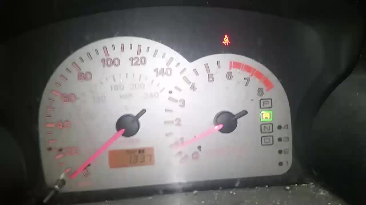

Hello everyone,
I recently thought I fixed all my issues by replacing the throttle body, fuel pump, TPS, MAP, MAF, air filter, crank position sensor, and timing belt, but had this issue crop back up.
When the mechanic first put in the new throttle body, the idle was a bit high in park, 1,500 or so, but dropped back down to 1,100-1,200. Idle in drive was normal around 800 RPM.
Now today after I started it with it very cold covered in snow, it was idling at only 600 RPM's while in park. I noticed if I turned the defroster/blower off, it raised it back up a bit. But now when I'm driving it, it idles at 600 RPM's at most, and will drop to 500 or 400 sometimes, especially with A/C turned on or defogger on, even when the windows are rolling down.
I've got 3 different IACs that I've tried switching between them. All are giving me similar results, so I don't think it's the IAC.
My mechanic said it could be a misfire caused by dirty spark plugs, but I've already cleaned them and put them back in.
Anyway, what can cause this low idle while even in park, that doesn't seem to raise when you go from drive to park? Or if it does raise, it'll go from 600 to 700 or 800, not up to 1,000+ like normal.
Also, accessories shouldn't bog down the idle RPM's so badly either. My understanding is generally if you turn on A/C or defogger and it drops RPM's significantly, it means your IAC isn't compensating properly. I'm pretty sure I've ruled it out though.

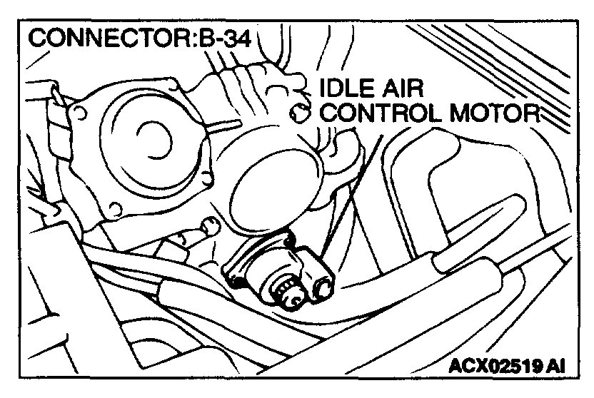

Also, as far as idle speed, I'm quite happy to hear you say no to the ziptie. LOL You mentioned that you switched the IAC. However, we need to check it. The idle speed is controlled by that and not adjustable. When you place a load on the engine (electrical, AC, PS) and so on, the IAC should maintain the idle speed. Actually, the spec is 700 RPM in neutral.
When you removed the IAC, did you check to make sure there was nothing blocking where it mounts such as carbon? Take a look through this link. You may find it helpful.

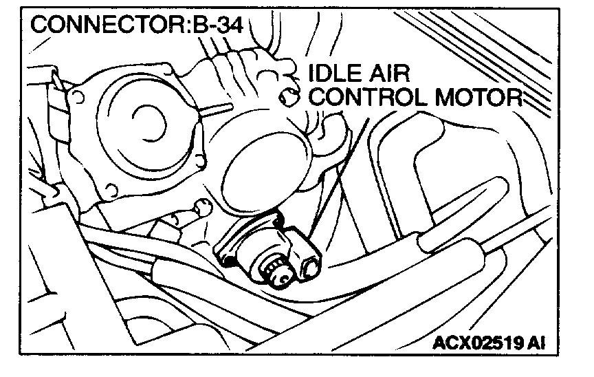

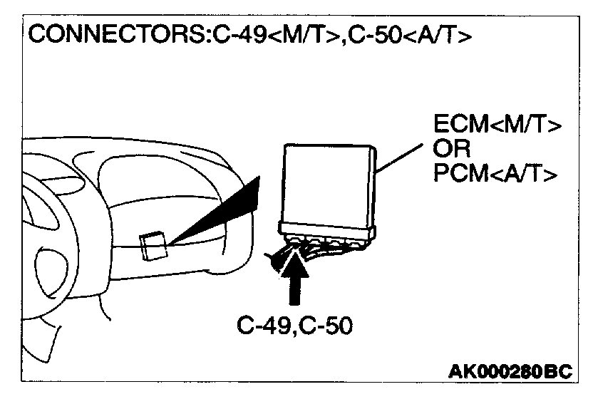

https://www.2carpros.com/articles/idle-air-control-valve-service

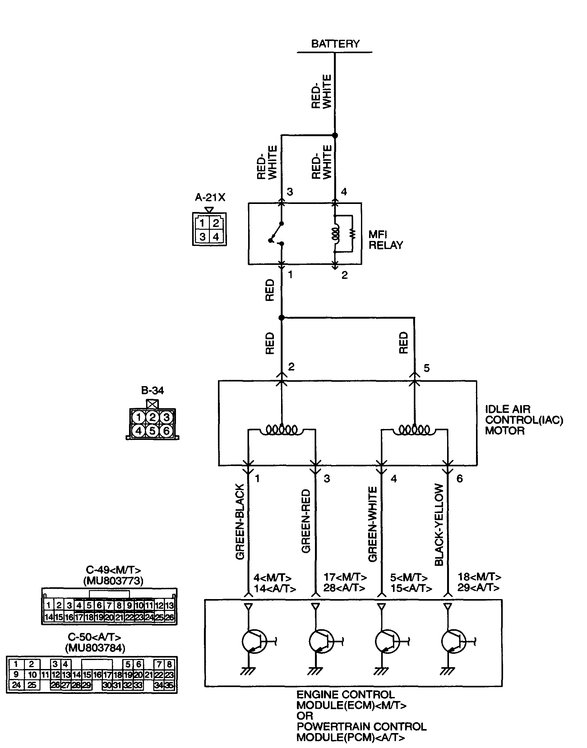

Next, here are the directions for testing the IAC. The attached pics correlate with the directions.
_______________________________________________________
2001 Mitsubishi Eclipse GS L4-2350cc 2.4L SOHC MFI
Component Tests and General Diagnostics
Vehicle Powertrain Management Fuel Delivery and Air Induction Idle Speed/Throttle Actuator - Electronic Testing and Inspection Component Tests and General Diagnostics
COMPONENT TESTS AND GENERAL DIAGNOSTICS

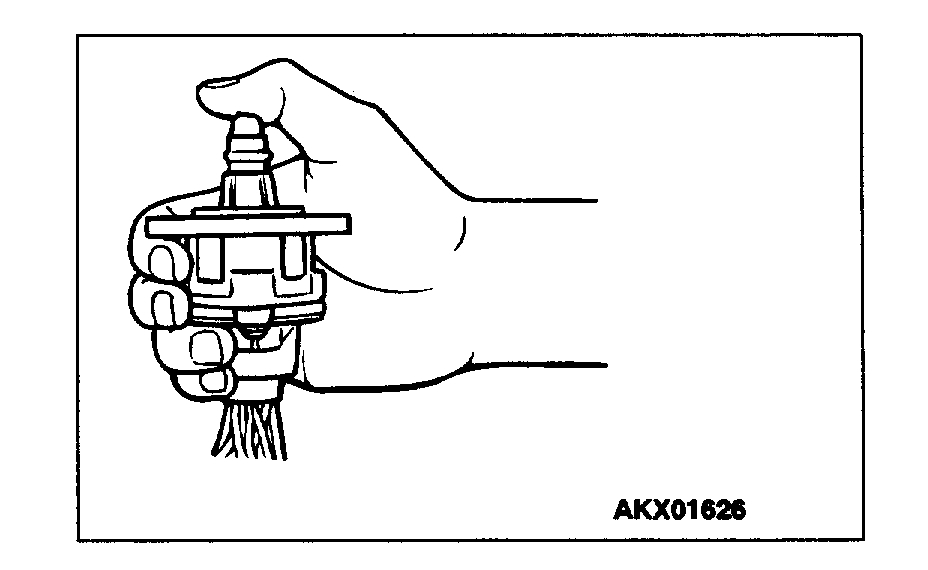

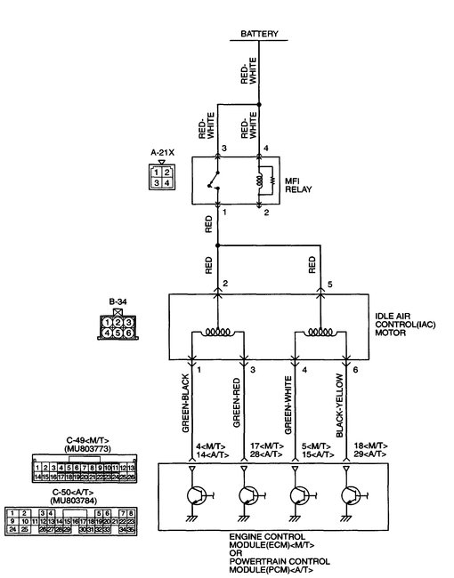

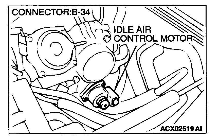

IDLE AIR CONTROL MOTOR (STEPPER MOTOR) CHECK
Required Special Tool:
MB991709: Test Harness Set
Checking the Operation Sound
1. Check that the engine coolant temperature is 20 °C (68 °F)
NOTE: If necessary, you can disconnect the engine coolant temperature sensor connector and connect the harness-side of the connector to another engine coolant temperature sensor that is at 20 °C (68 °F) or below.
2. Check that the operation sound of the stepper motor can be heard after the ignition is switched ON (but without starting the motor).
3. If the operation sound cannot be heard, check the stepper motor's activation circuit. If the circuit is normal, it is probable that there is a malfunction of the stepper motor or engine control module (ECM) or powertrain control module (PCM) .

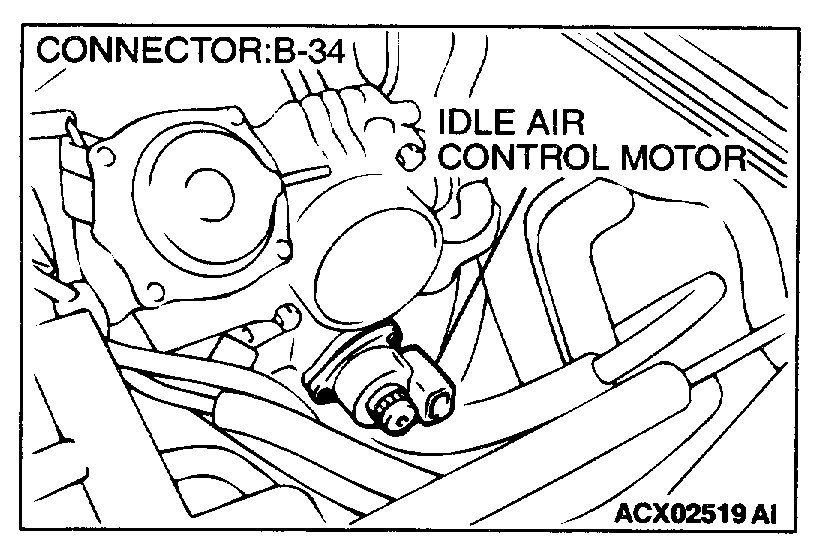

pic 1

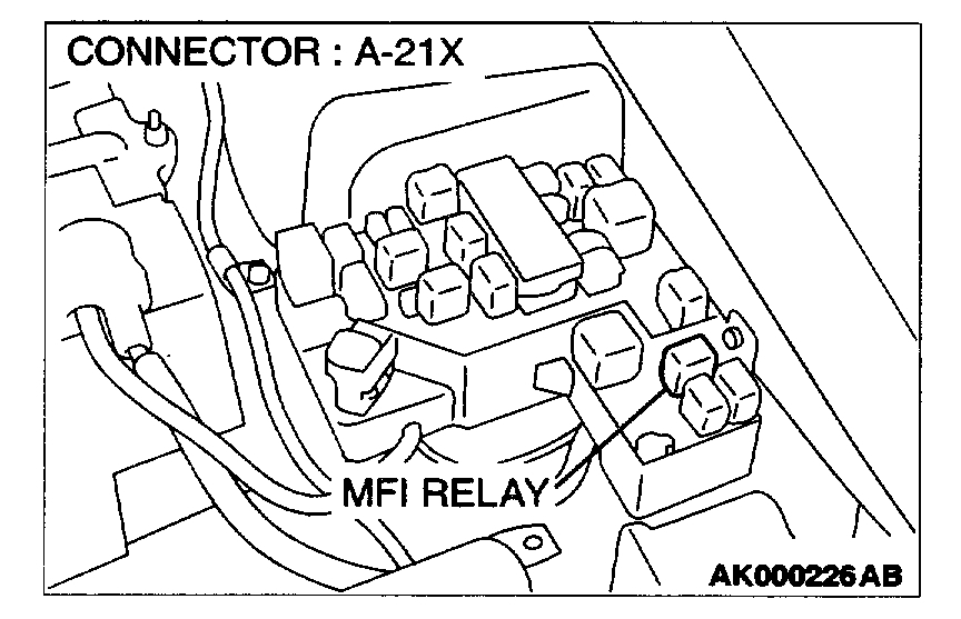

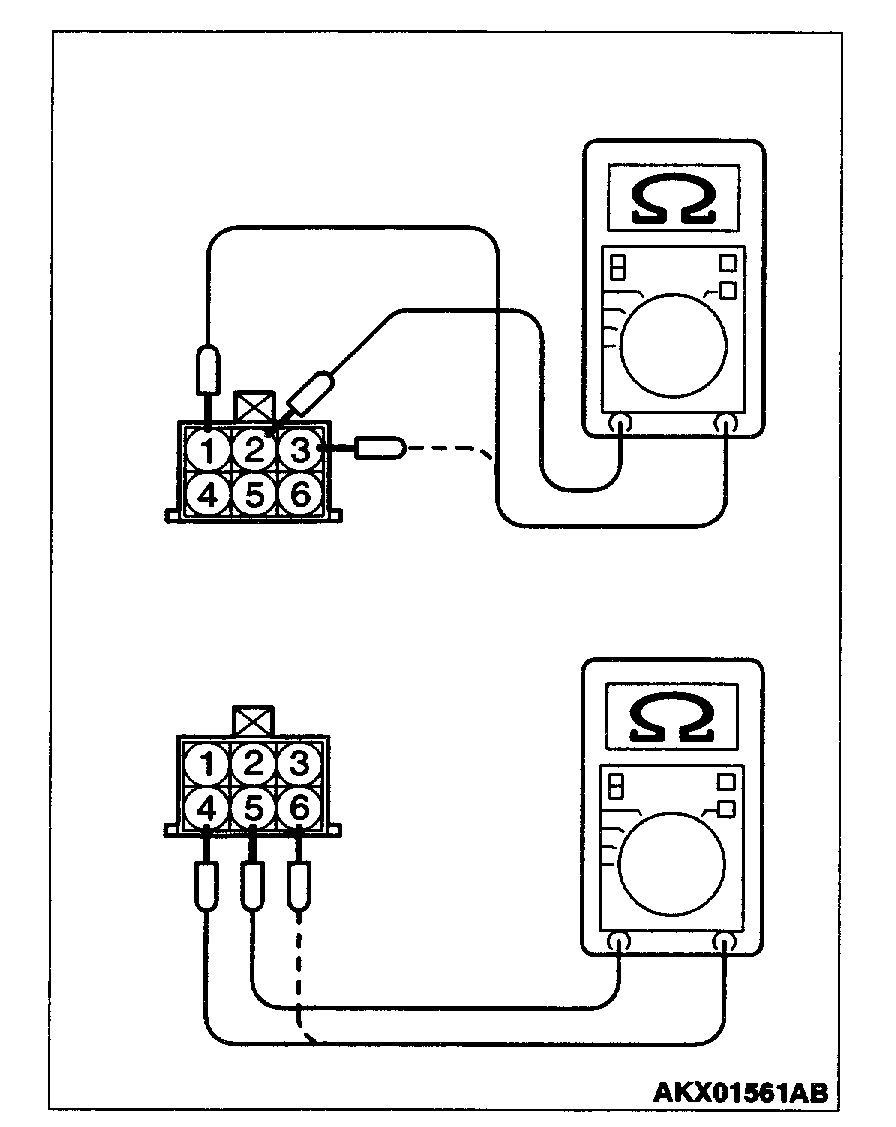

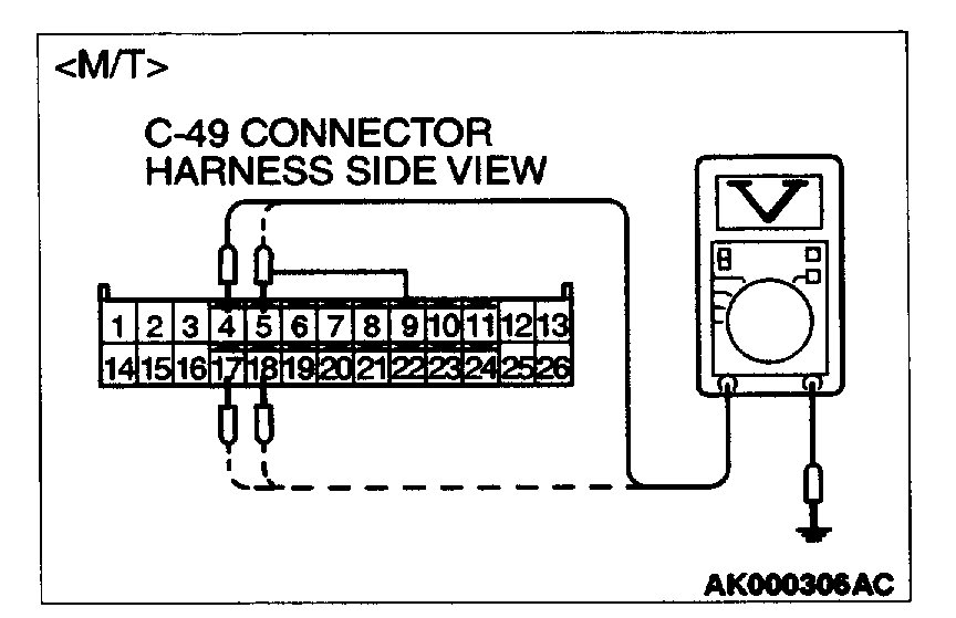

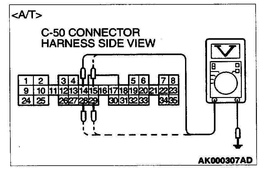

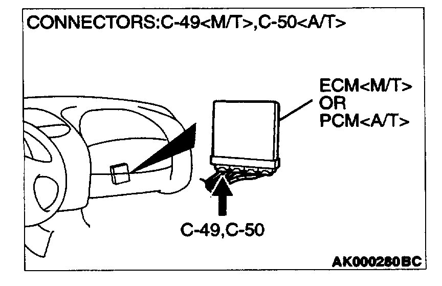

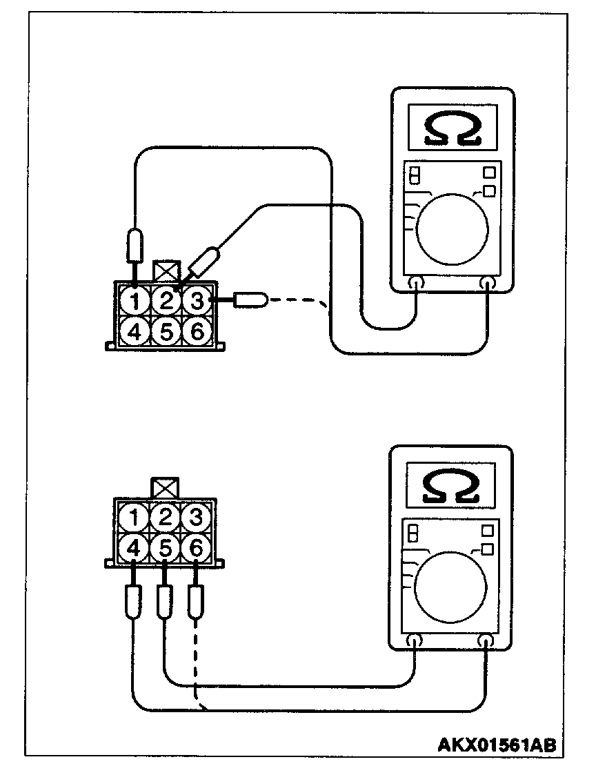

Checking the Coil Resistance
1. Disconnect the idle air control motor connector.
2. Measure resistance between terminal 2 and either terminal 1 or terminal 3 of the connector at the idle air control motor side.
Standard value: 28 - 33 ohm [at 20 °C (68 °F)]
3. If resistance is not within the standard value, replace the IAC motor.
4. Measure the resistance between terminal 5 and either terminal 6 or terminal 4 of the connector at the idle air control motor side.
5. If resistance is not within the standard value, replace the IAC motor.

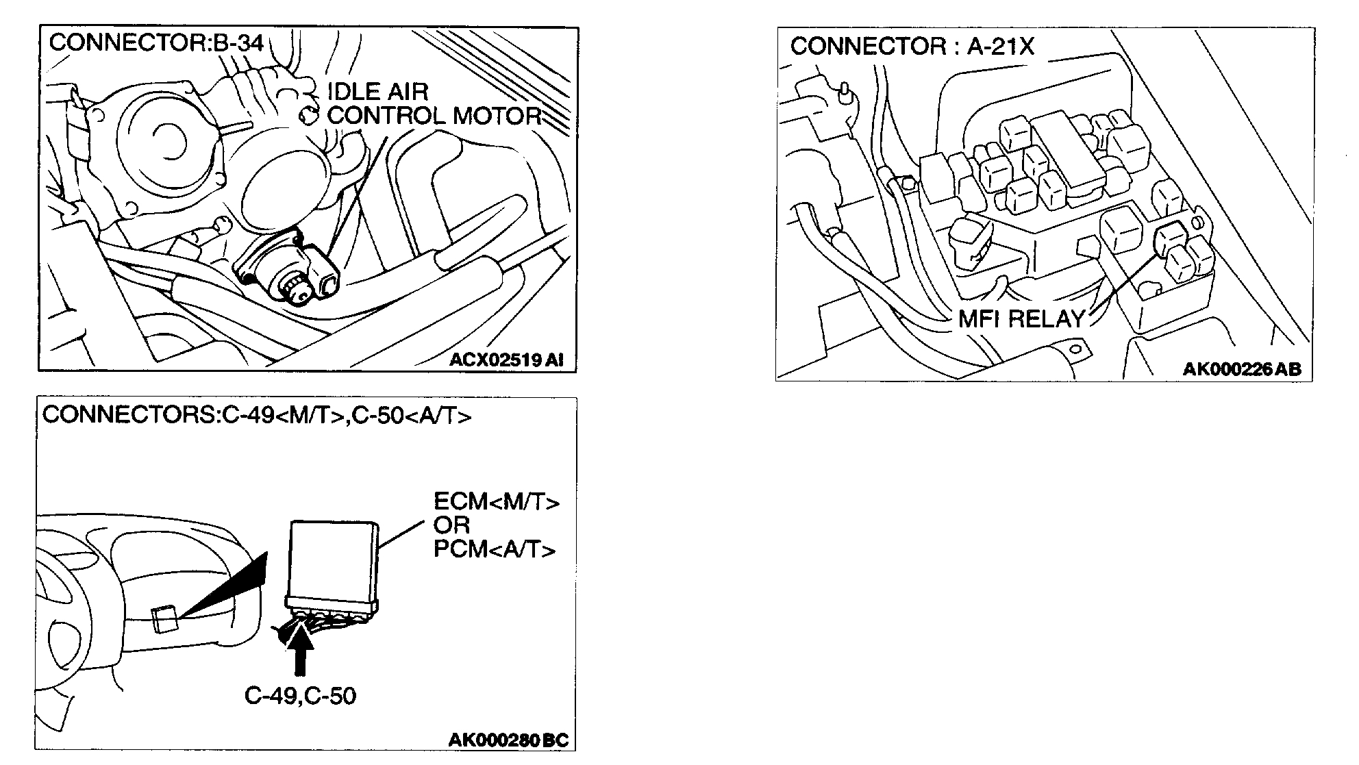

pic 2

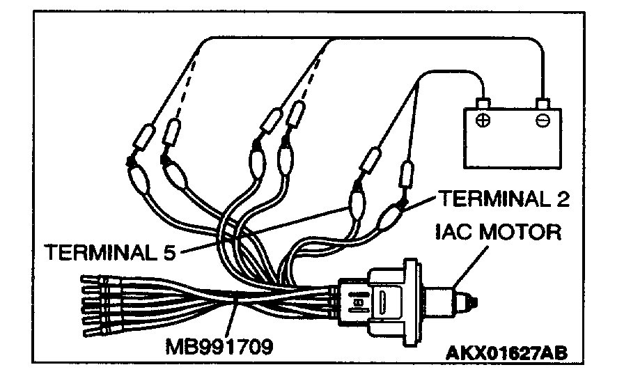

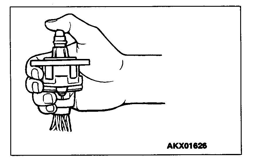

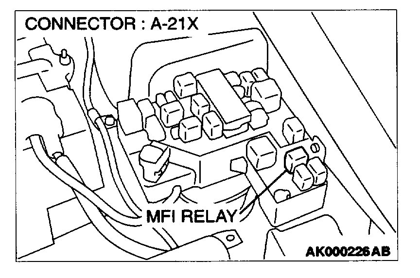

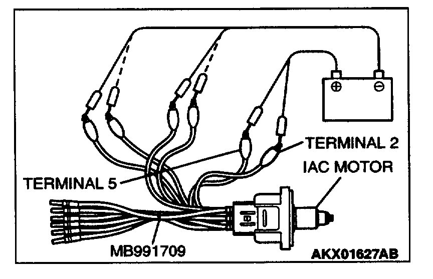

1. Remove the throttle body.
2. Remove the idle air control motor.

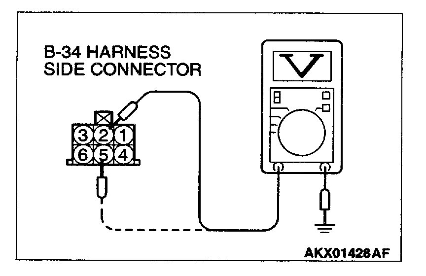

3. Connect special tool MB991709 to the idle air control motor connector.
4. Connect the positive (+) terminal of a power supply (approximately 6 V) to terminal 2 and the terminal 5.
5. Connect the negative (-) terminal of the power supply to each clip as described in the following steps. Then check whether or not the stepper motor vibrates slightly as it operates.
1. Connect the negative terminal of the power supply to terminal 1 and terminal 4.
2. Connect the negative terminal of the power supply to terminal 3 and terminal 4.
3. Connect the negative terminal of the power supply to terminal 3 and terminal 6.
4. Connect the negative terminal of the power supply to terminal 1 and terminal 6.
5. Connect the negative terminal of the power supply to terminal 1 and terminal 4.
6. Repeat the tests in sequence from (5) to (1) to test opposite movement of the IAC.
pic 3
6. If vibration is detected during the test, the stepper motor can be considered to be normal.

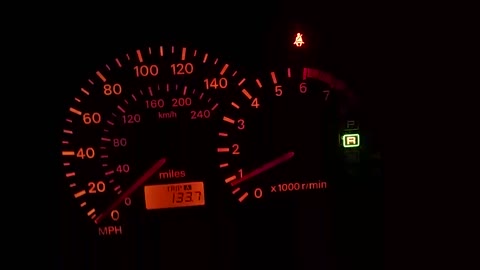

If you watch around the 6,000-8,000 area of the RPMs when I turn on the defroster, you can notice the subtle dimming of the dash lights.

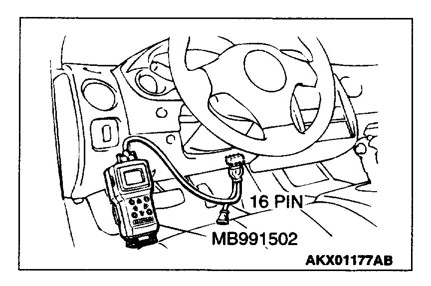

I want you to look at something I just found. I never payed attention to it, but the last post you indicated someone played with the base / curb idle speed. Take a look through this and let me know if it is something you can do. The attached pics correlate with the directions. Pay special attention to the second "Note" in the directions.
_____________________________________________________________________
Adjustments
Vehicle Powertrain Management Fuel Delivery and Air Induction Idle Speed Adjustments
ADJUSTMENTS

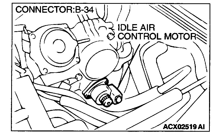

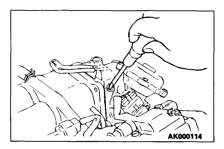

BASIC IDLE SPEED ADJUSTMENT
MB991502: Scan Tool (MUT-II)
NOTE: The standard idle speed has been adjusted with the speed adjusting screw (SAS), by the manufacturer, and there should be no need for readjustment.
NOTE: If the adjustment has been changed by mistake, the idle speed may become too high or the idle speed may drop too low when loads A/C, defogger, etc. are placed on the engine. If this occurs, adjust by the following procedure.
NOTE: The adjustment, if made, should be made after first confirming that the spark plugs, the injectors, the idle air control motor, compression, etc., are all normal.

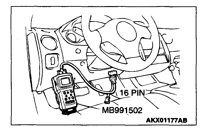

pic 1
1. The vehicle should be prepared as follows before the inspection and adjustment.
- Engine coolant temperature: 80 - 95 °C (176 - 203 °F)
- Lights, electric cooling fan and accessories: OFF
- Transaxle: Neutral (A/T for "P" range)

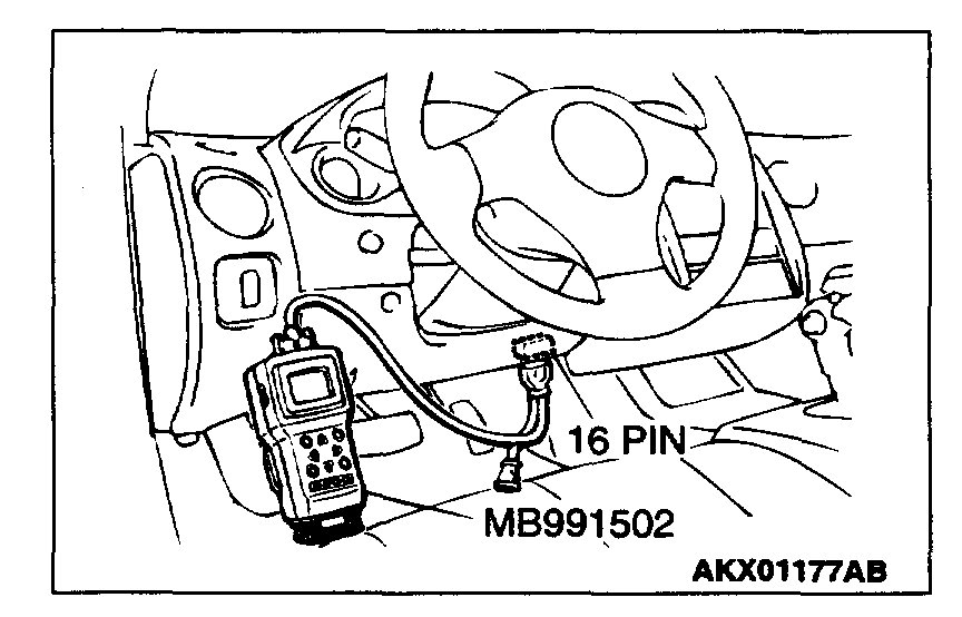

CAUTION: To prevent damage to scan tool MB991502, always turn the ignition switch to the "LOCK" (OFF) position before connecting or disconnecting scan tool MB991502.
2. Connect scan tool MB991502 to the data link connector (16-pin).
NOTE: When scan tool MB991502 is connected, the diagnostic test mode control terminal should be grounded.
3. Start the engine and run at idle.
4. Select the item number 30 of the scan tool Actuator test.
NOTE: Use the scan tool to hold the IAC motor at the basic step to adjust the basic idle speed.
5. Check the idle speed.
Standard value: 700 ± 50 r/min
NOTE: The engine speed may be 20 to 100 r/min lower than indicated above for a new vehicle [driven approximately 500 km (300 mile) or less], but no adjustment is necessary.
NOTE: If the engine stalls or the engine speed is low even though the vehicle has been driven approximately 500 km (300 mile) or more, it is probable that deposits are adhered to the throttle valve, so clean it.

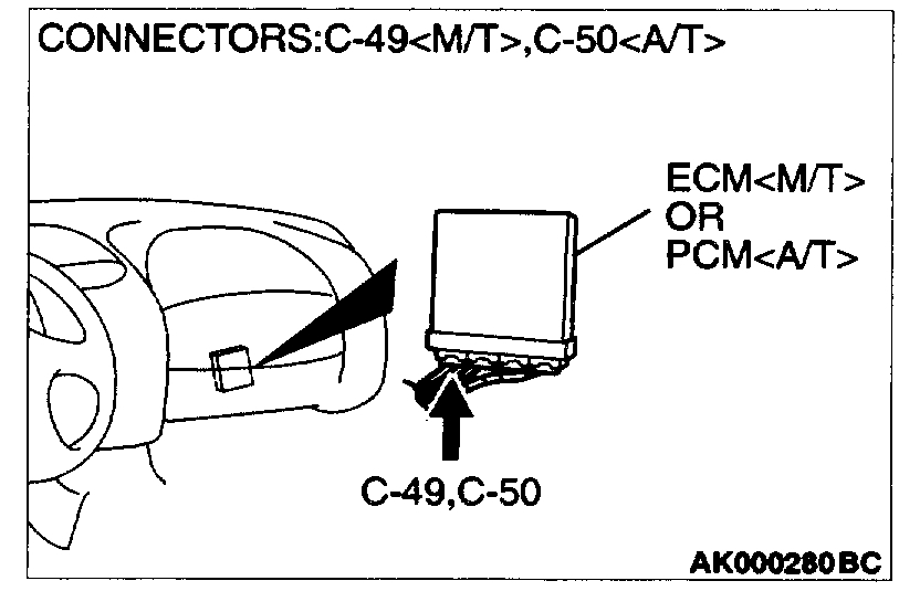

pic 2
6. If not within the standard value range, turn the speed adjusting screw (SAS) to make the necessary adjustment.
7. Press the scan tool clear key, and release the IAC motor Actuator test mode.
8. Turn the ignition switch to the "LOCK" (OFF) position.
NOTE: Unless the IAC motor is released, the Actuator test mode will continue for 27 minutes.
9. Disconnect scan tool MB991502.
10. Start the engine again and let it idle for about 10 minutes.
Check that the idling condition is normal.
This just clicked with me when I was trying to research. Normally, the curb idle speed is never adjusted other than by the manufacturer when the vehicle is new. However, since it was changed by your friend, this may be the entire problem.

CIRCUIT OPERATION
- The idle air control motor power is supplied from the MFI relay (terminal 1).
- The ECM (terminals 4, 5,17, 18) (M/T> or PCM (terminals 14, 15, 28, 29) (A/T> drives the stepper motor by sequentially turning "ON" the power transistors in the ECM (M/T> or PCM (A/T> and providing ground to the idle air control motor (terminals 1, 3, 4, 6).

STEP 1. Using scan tool MB991502, read the diagnostic trouble code (DTC).
1. Connect scan tool MB991502 to the data link connector.
2. Turn the ignition switch to the "ON" position.
3. Set scan tool MB991502, read the DTC.
4. Turn the ignition switch to the "LOCK" (OFF) position.
Q: Is the diagnostic trouble code other than P0507 output?
YES: Refer to Diagnostic Trouble Code Chart under "Trouble Code Descriptions".
NO: Go to Step 2.

STEP 3. Check connector B-34 at idle air control motor for damage.
Q: Is the connector in good condition?
YES: Go to Step 4.
NO: Repair or replace it. Refer to Harness Connector Inspection. Then go to Step 14.
pic 5
pic 6
STEP 4. Check the idle air control motor coil resistance.
1. Disconnect the idle air control motor connector B-34.
2. Measure the resistance between idle air control motor connector terminal 2 and either terminal 1 or terminal 3.
3. Measure the resistance between idle air control motor connector terminal 5 and either terminal 4 or terminal 6.
Q: Is the resistance normal?
YES: Go to Step 5.
NO: Replace the idle air control motor. Then go to Step 14.

STEP 5. Check the power supply voltage at idle air control motor harness side connector B-34.
1. Disconnect the connector B-34 and measure at the harness side.
3. Measure the voltage between terminal 2, 5 and ground.
- Voltage should be battery positive voltage.
Q: Is the voltage normal?
YES: Go to Step 7.
NO: Go to Step 6.

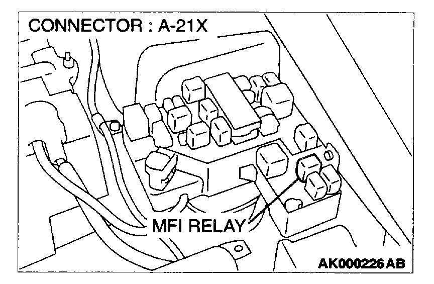

STEP 6. Check connector A-21X at MFI relay for damage.
YES: Repair harness wire between MFI relay connector A-21X terminal 1 and idle air control motor connector B-34 terminal 2,5 because of open circuit or short circuit to ground. Then go to Step 14.

STEP 7. Check the power supply voltage at ECM connector C-49 (M/T> or PCM connector C-50 (A/T> by backprobing
1. Do not disconnect the connector C-49 (M/T> or C-50 (A/T>.
2. Measure the voltage between terminal (4, 5,17,18) (M/T> or (14, 15, 28, 29) (A/T> and ground by backprobing.
- The voltage is 1 V or lower for approximately 3 seconds, then changes to the battery positive voltage when the
Ignition switch is turned from the "LOCK" (OFF) position to the "ON" position.
3. Turn the ignition switch to the "LOCK" (OFF) position.
YES: Go to Step 10.
NO: Go to Step 8.
pic 11

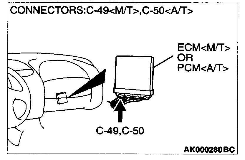

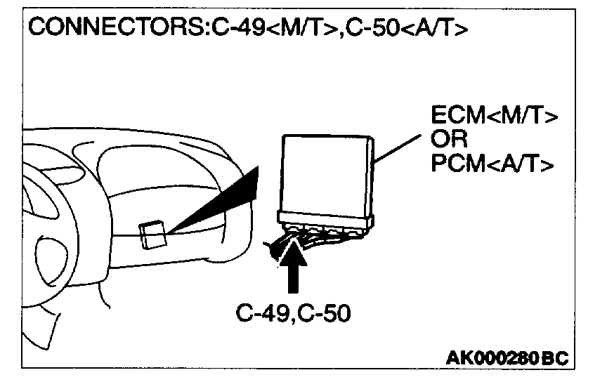

STEP 8. Check connector C-49 at ECM (M/T> or connector C-50 at PCM (A/T> for damage.
YES: Go to Step 9.
pic 12
pic 13
STEP 9. Check for open circuit and short circuit to ground between idle air control motor connector B-34 and ECM connector C-49 (M/T> or PCM connector C-50 (A/T>.
a. Idle air control motor connector B-34 terminal 1 and ECM connector C-49 terminal 4 (M/T> or PCM connector C-50 terminal 14 (A/T>.
b. Idle air control motor connector B-34 terminal 3 and ECM connector C-49 terminal 17 (M/T> or PCM connector C-50 terminal 28 (A/T>.
c. Idle air control motor connector B-34 terminal 4 and ECM connector C-49 terminal 5 (M/T> or PCM connector C-50 terminal 15 (A/T>.
d. Idle air control motor connector B-34 terminal 6 and ECM connector C-49 terminal 18 (M/T> or PCM connector C-50 terminal 29 (A/T>.
Q: Is the harness wire in good condition?
YES: Replace the ECM or PCM. Then go to Step 14.
NO: Repair it. Then go to Step 14.

STEP 11. Check the idle air control motor operation using special tool MB991709.
pic 15
1. Remove the idle air control motor.
2. Connect special tool MB991709 to the idle air control motor. (All terminals should be connected.)
3. Use the jumper wires to connect terminal 2 of the idle air control motor connector to the battery (+) terminal.
4. Check the ensure that the motor operates when the terminals 1 and 3 of the idle air control motor connector are respectively connected to the battery (-) terminal using a jumper wire.
- Vibration should be present at each application of voltage to test clip combination.
pic 16
5. Then. Use jumper wires to connect the terminal 5 of the idle air control motor connector to the battery (+) terminal.
6. Check the ensure that the motor operates when the terminals 4 and 6 of the idle air control motor connector are respectively connected to the battery (-) terminal using a jumper wire.
pic 17
7. Install the idle air control motor. Refer to Throttle Body - Disassembly and Assembly.
Q: Is the idle air control motor operating properly?
YES: Go to Step 12.
