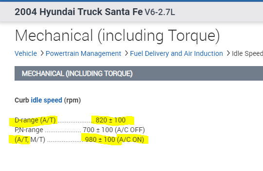

Also, I found the idle speed is too low. In gear, it should be between 720 and 920 (see pic below). The low idle could be caused by a couple of things such as a dirty throttle body, the idle air control valve, a vacuum leak, and so on.
Let me know what happens with the water test.

Thank you for you patience and time, i have already replaced the idle control valve ,cleaned the throttle body and replaced the throttle position sensor . when it makes this sound and the idle voltage drops ,as i accelerate and it goes through the gears is when the shrill noise is louder. I will adjust the throttle cable to idle it up a few rpms I will idle it up a bit and replace the belt to make sure i have the correct belt for the smaller alt. pulley. if that doesn't help ,guess i will have to live with it. Thank you so much for your help.
