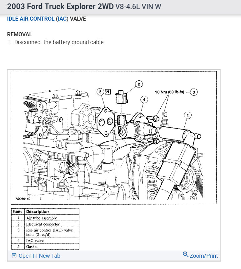

Low idle bubbling noise and does it while driving if stop at a stop sign.

It sounds like the IAC valve needs to be replaced, but we should check it for vacuum leaks as well. Here is a guide to help with the vacuum leak. Please use this guide when the engine is cold only:
and this guide may help as well:
If the check engine light is on, we need to run the codes.
Check out the images (below). Please let us know what you find.
