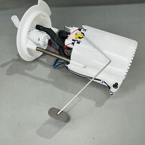

I had it checked/cleaned and still the same. Fuel filter on this car is not serviceable as it is in the tank so I don't believe it can be changed. I do hear a squeal sound as the RPM's go up and down in the rear of the vehicle though. These issues all stop when I rev the engine a bit.

The fuel pump and filter are in the fuel tank. I don't know if there is a access cover in the trunk, if not you would have to drain the tank, then take the tank out to replace the unit. I had a similar thing happen on a firebird. The car would run but the RPMs would vary. The filter was mostly clogged and instead of getting just the filter I got the fuel pump and all. No more problems. The prices vary with different manufacturers.
