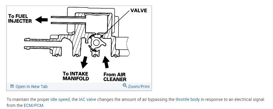

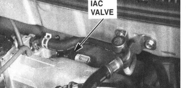

Disconnecting the IAC like that tested nothing. It is supposed to change the idle when that happens.
It could be the IAC as that is its job. It is supposed to control the idle based on load.
https://www.2carpros.com/articles/how-to-replace-an-idle-speed-control-motor-iac

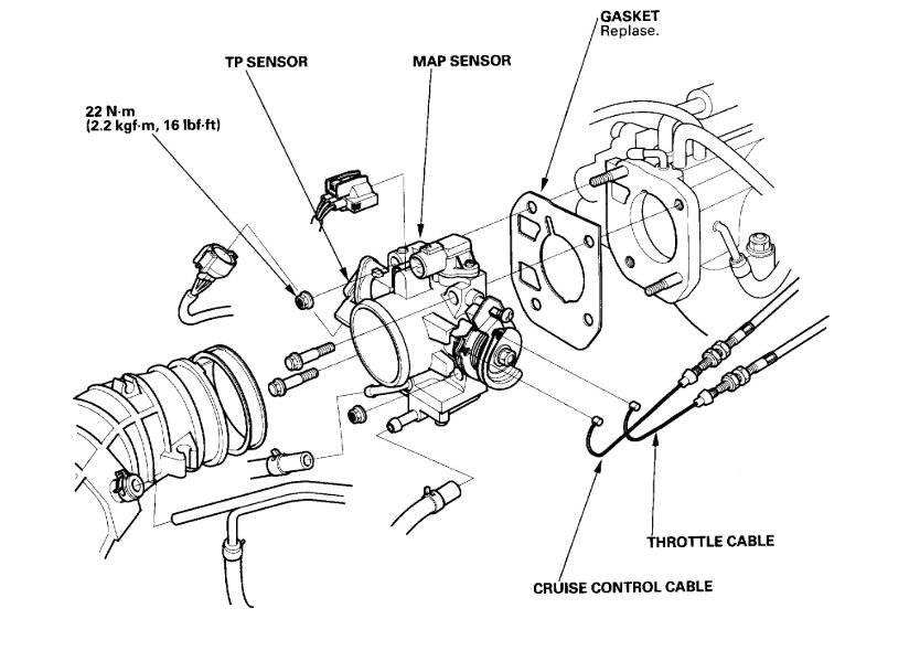

Did you clean the bore in the throttle body where the IAC goes? If there are any restrictions in the throttle body, it will do this.
https://www.2carpros.com/articles/idle-air-control-valve-service

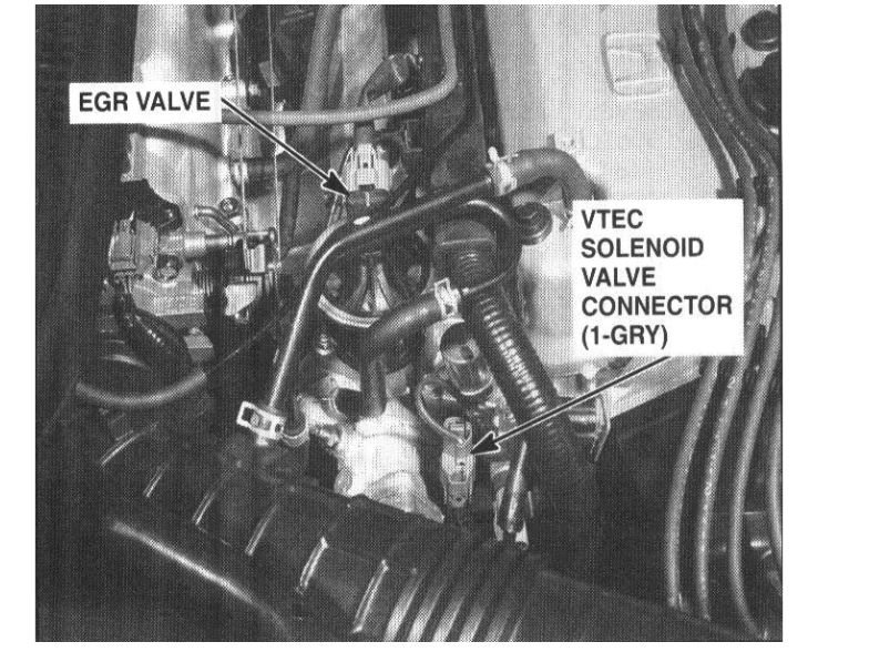

Okay. yes cleaned the bore hole , i removed the IAC valve as well as the EGR valve, cleaned them both with carburetor spray (very gunky and filthy) , put them back on with new gaskets . car worked great for half the day , then started going to low idle and shaking at stop sign . got it back home and it kept dropping idle and shook about to die but came back up, it's like every 20 seconds it drops and shakes like it about to stop then re turns to idle . it never surges just drops . also it is very quiet like it's not even on or low power .
