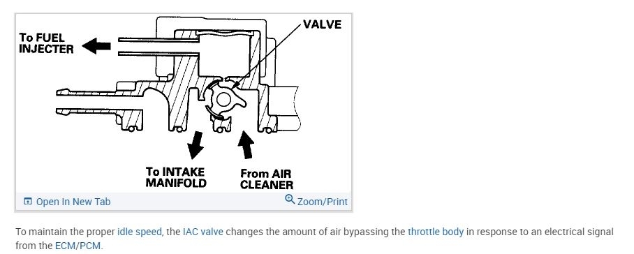

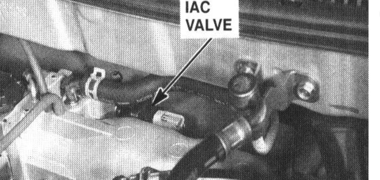

Disconnecting the IAC like that tested nothing. It is supposed to change the idle when that happens.
It could be the IAC as that is its job. It is supposed to control the idle based on load.
https://www.2carpros.com/articles/how-to-replace-an-idle-speed-control-motor-iac

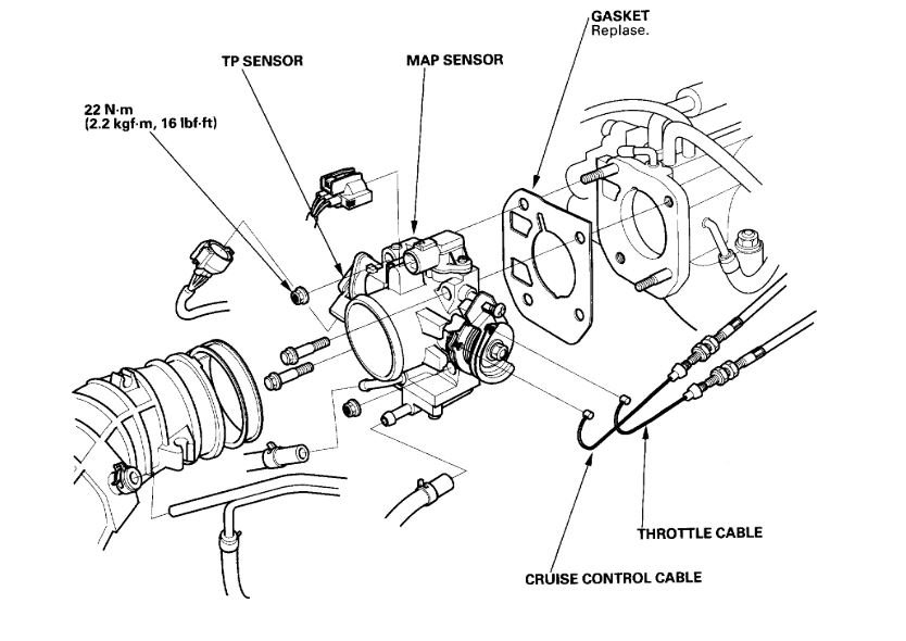

Did you clean the bore in the throttle body where the IAC goes? If there are any restrictions in the throttle body, it will do this.
https://www.2carpros.com/articles/idle-air-control-valve-service
Also, make sure the coolant level is correct. Low coolant level will affect the operation of the valve.

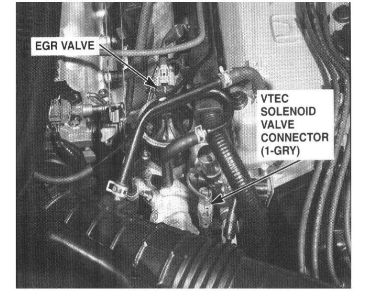

Okay. yes cleaned the bore hole , i removed the IAC valve as well as the EGR valve, cleaned them both with carburetor spray (very gunky and filthy) , put them back on with new gaskets . car worked great for half the day , then started going to low idle and shaking at stop sign . got it back home and it kept dropping idle and shook about to die but came back up, it's like every 20 seconds it drops and shakes like it about to stop then re turns to idle . it never surges just drops . also it is very quiet like it's not even on or low power .
Jun 22, 2020 at 12:16 PM
Do you have a scan tool that can read long term trim data?
You were in the right area as after you did those changes, it worked. I am wondering if either the valve is partially open or the throttle body is bad.
Jun 22, 2020 at 9:29 PM
MUSICGENIUS83
  • 29 POSTS
Okay, so it seems my issue has been solved for now. I put a new EGR valve on there and it didn't seem to fix it so I went with the MAP sensor and as soon as I replaced that I had no problems with the idle or having it shut off, but now I ran into another problem; at some point my fans stopped coming on cool off the engine they only come on when I have the air conditioning on normally the fans pop on and off every couple minutes even at idle to cool off the engine when the A/C is off. I have a new thermostat and a new radiator and I drained and refilled the coolant with new coolant. I had replaced the fan sensor I believe it's called the thermal fan switch or sensor with no luck. so I've ordered a coolant temperature sensor hoping because those two sensors work together that may be the coolant temperature sensor isn't sending the right signal to the fan sensor. I just wanted to know if I'm in the right area of what I'm doing. I took it on the freeway and drove it around a few blocks purposely trying to get it hot and the fans won't come on even when it's hot and at temperature.
