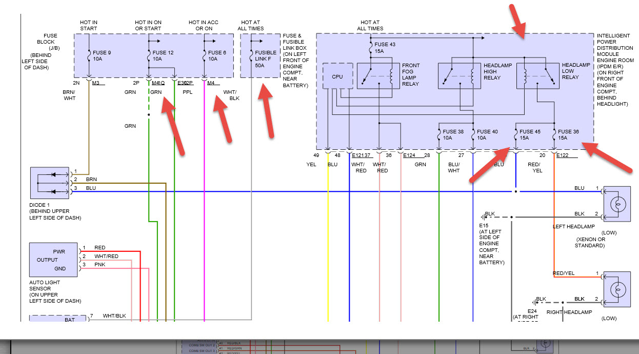

I replaced both of my headlights bulbs but still do not turn on. My high beams turn on and my parking lights. What could be the problem?

check items in picture then if those are okay then have a mechanic scan for codes it may be the power module on right of picture that has gone bad.
