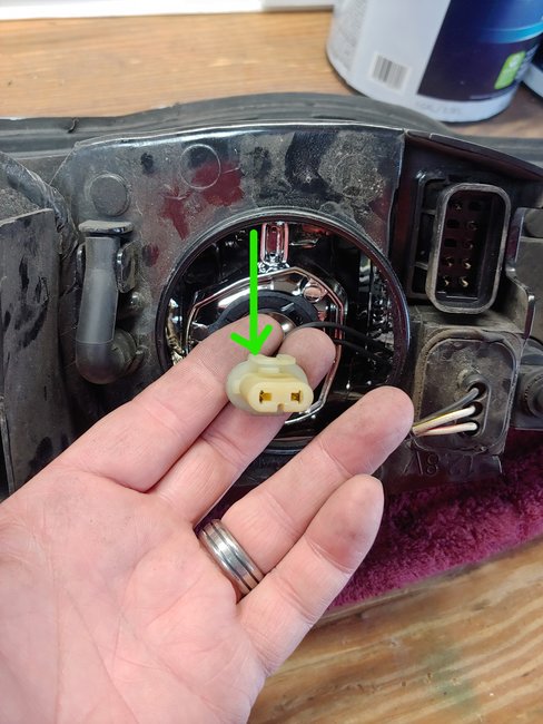

My passenger side low beam headlamp stopped working. I tried replacing it with new lamps and had no luck. I checked to see if I had voltage to the lamp and found that I had 7.6 volts. They are 12V lamps. I measured the driver side low beam and had 12 volts. I tried the driver side bulb in the passenger side with no luck. If it was a blown fuse, I would have no voltage at all on the passenger side. All of my bulbs are fine, they are 12V, 55W bulbs, and obviously want 12V, not 7.6V. Anybody have an idea as to what would cause a low voltage to the passenger side?

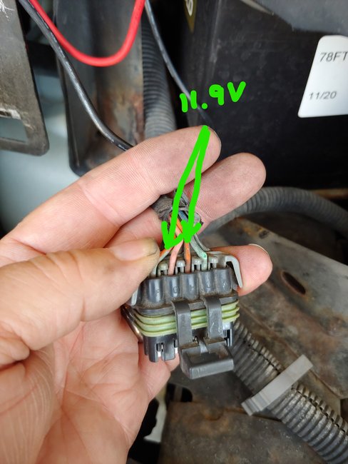

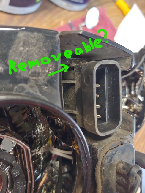

Hi Joe,

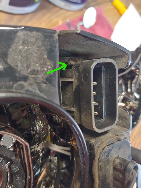

I believe I have isolated it to the connection between the right hand low beam lamp and the multipin connector in the headlamp assembly. I have 11.9V at both the orange wires whether I take it to a good ground on the body of the car or the dark blue wire in this plug. That leads me to believe everything is good up to this point leaving me the headlamp assembly wiring. When I check the two pin bulb connection to ground I get 11.9V, but when I measure the voltage across the bulb plug in, I usually get nothing or an occasional spike in the voltage, but it never is a steady reading. My next question is, is this multipin connection removeable? It appears to have tangs that can be pushed in allowing it to be replaced without replacing the entire headlamp assembly, but I can't get a really good look at it on the inside even with a small mirror and flashlight, let alone get my fingers in there to remove something like a pin connection. I have added some pictures to help in explaining what I have found. Any advice as to what I can do next and how to do it?

Yep, you found the problem. As far as removal, I believe the wires on the inside are hard-wired. This simply means that is likely not meant to be removed.
At this point, try to see if you can wiggle that connector out. Regardless of removal, it needs to come out to inspect the wiring and repaired. If you can't, the assembly will need to be replaced.
Let me know what you find. Also, make sure the bulb connector isn't corroded, damaged, or have a pin pushed in.
