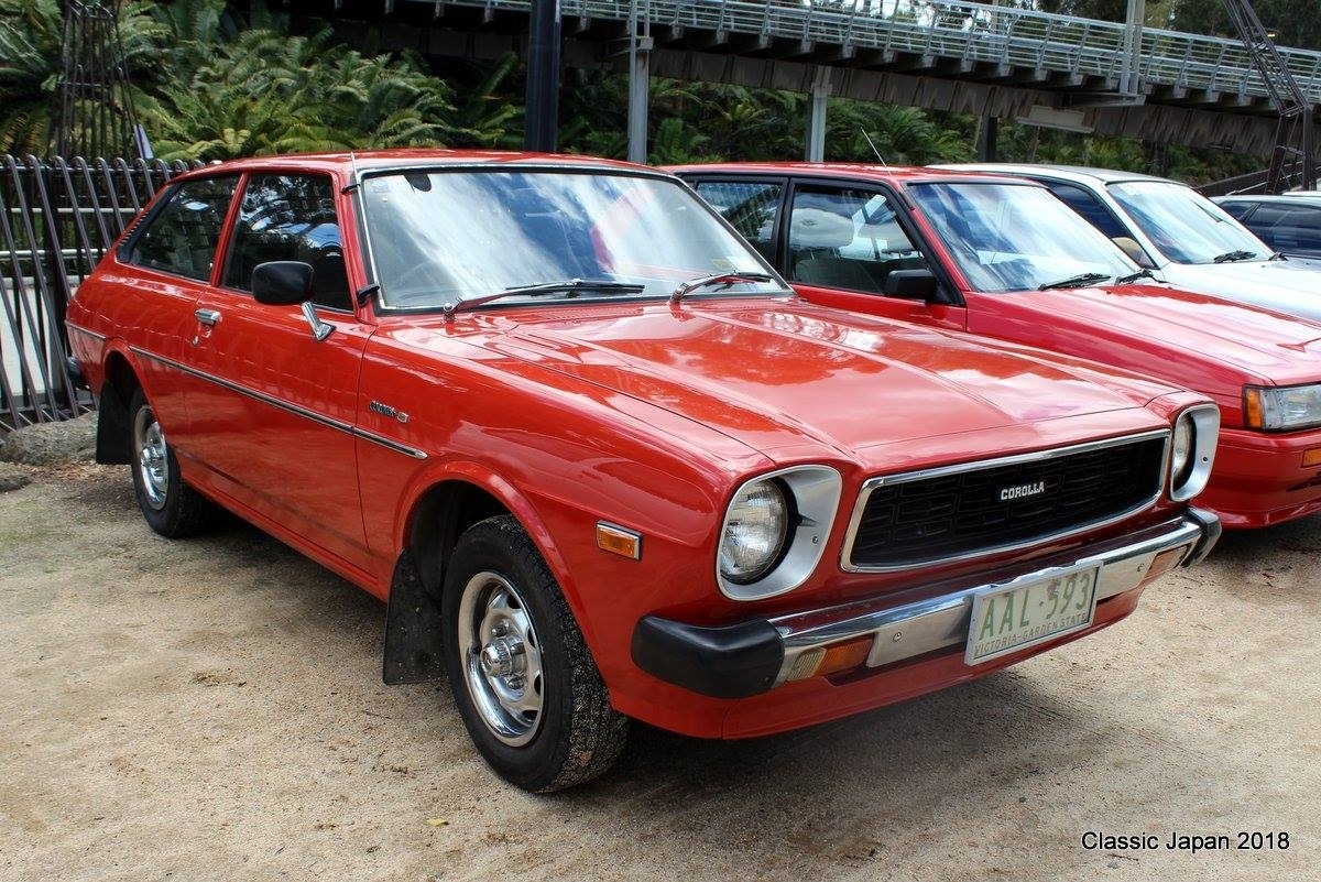

Hi, FYI... after over 30 years of custodianship I gave her a well-earned 'spa treatment'. She deserved it! This shot was taken at the Classic Japan display in December. Over 500 cars over 25 yo on display, yet she was the only one of her model! A rare gem indeed, which is why I want to keep her going for as long as possible, as long as she's reliable, and it's safe to do so. Thanks for your enthusiasm and 'paying it forward'. :)
