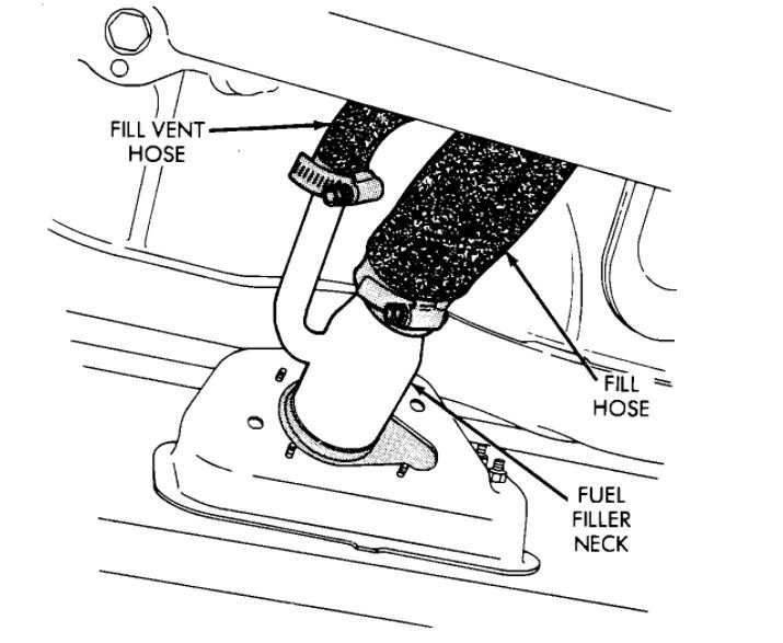

4. Disconnect the fuel fill hose, and vent hose from the filler neck.
5. Disconnect the fuel pump module wire connector. Remove any tie straps securing the connector harness to the fuel hoses.
Fuel Filler Neck Hoses

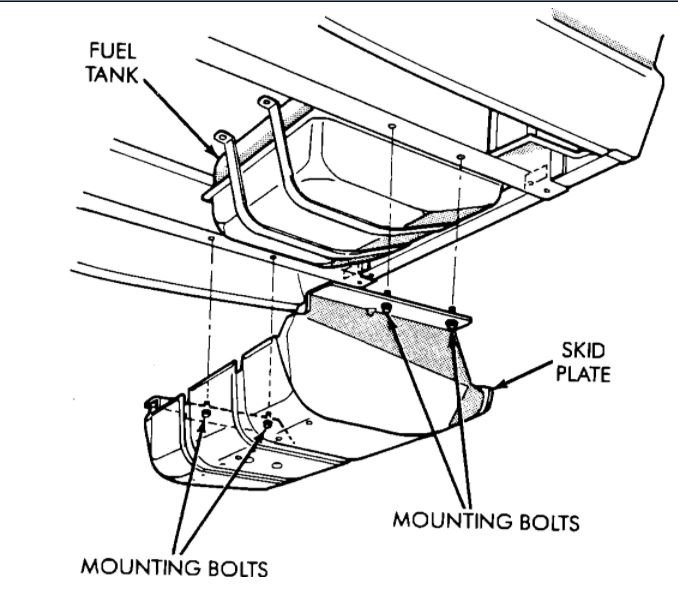

8. If equipped, remove skid plate.
Fuel Tank With Skid Plate (XJ)
9. Remove fuel tank shield.

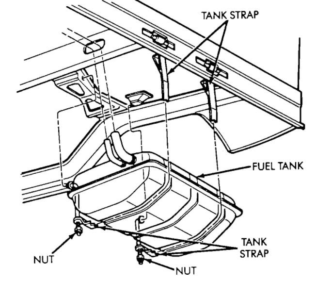

Fuel Tank Assembly Removal/Installation (XJ)
11. Remove the tank support strap nuts. Move the straps away from tank.
12. Lower fuel tank on transmission jack.
