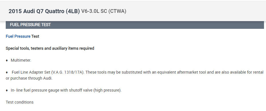

I have this code on my vehicle listed above TFSDI 3.0 liters. I got this code P310B, does this mean my pump in the tank is malfunctioning or is it referring to the high-pressure pump of its fuel pressure sensor itself.
Please help me out with the values I need to see on live data and any other information that can help me sort it out.
Jul 26, 2024 at 4:57 AM
  • 110,244 POSTS

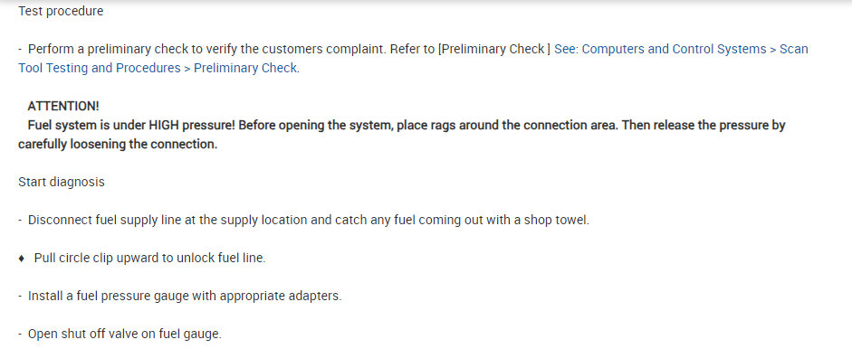

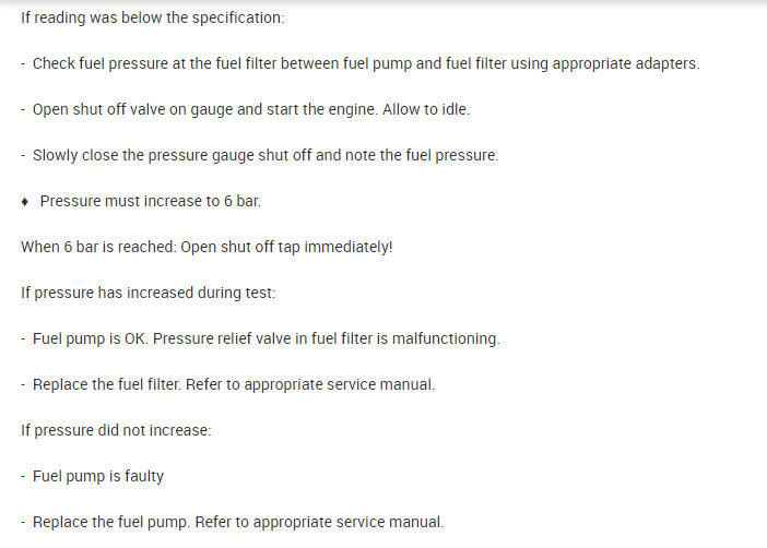

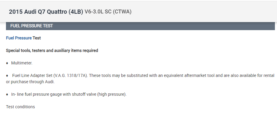

As far as the code is concerned, it deals with low fuel pressure or fuel pressure regulation. However, it isn't listed as a code for this year and model. Are there other codes that are present? Also, let me know what the vehicle is doing.

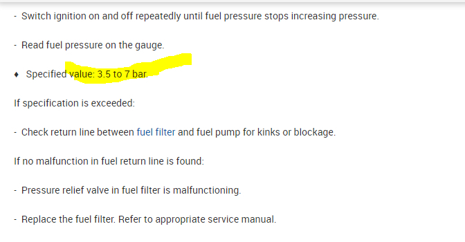

I attached the directions from my manual that I have for your vehicle. Take a look and let me know if they help.

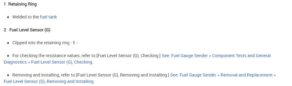

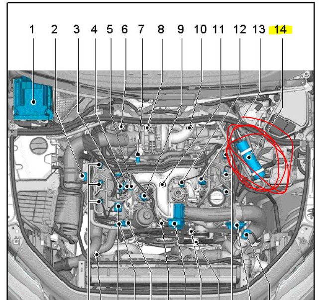

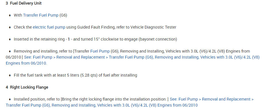

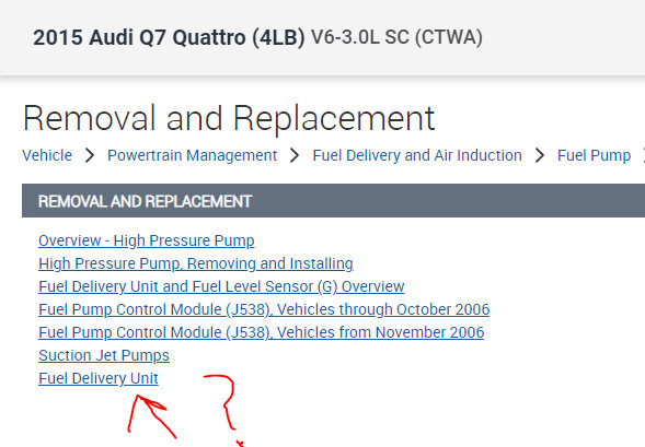

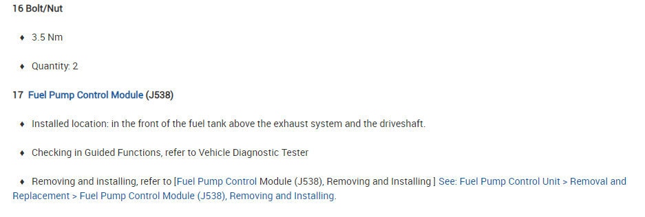

As far as the fuel filter goes, it is in the tank. See pic 1 below.

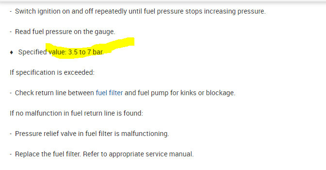

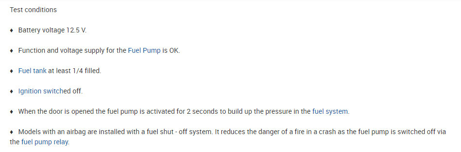

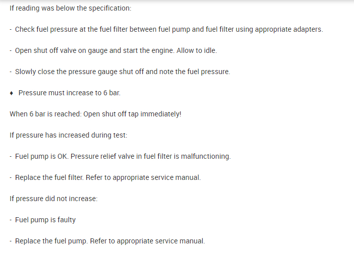

When I go to fuel pump replacement, I get a few different things. Take a look at pic 2. I need to know if the pump in the tank is what is needed or the high-pressure pump is what you are looking for.
I have an arrow pointing to the one in the fuel tank.

fuel delivery unit. the lift pump in the tank I mean. Thanks your information keeps me on track to deal with this issue.

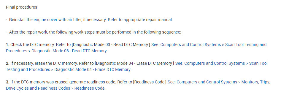

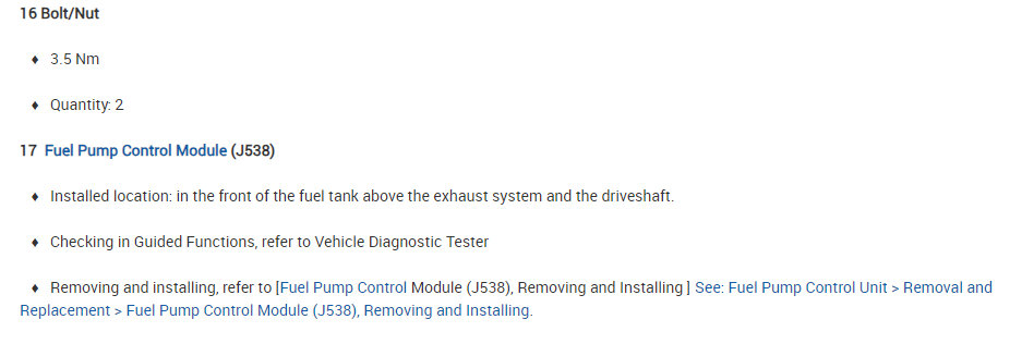

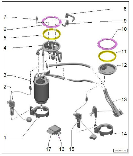

  • 110,244 POSTS

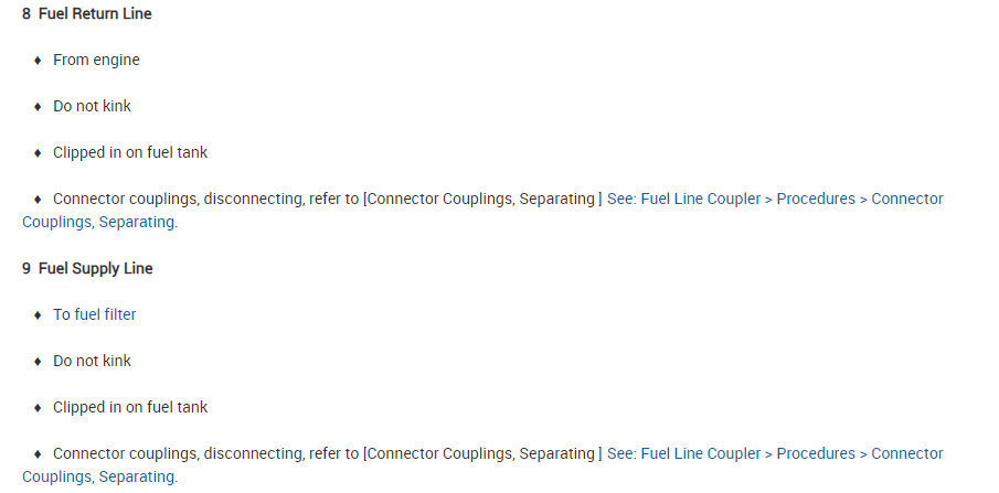

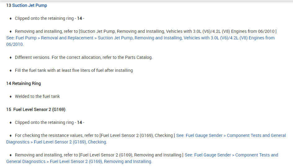

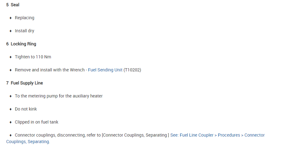

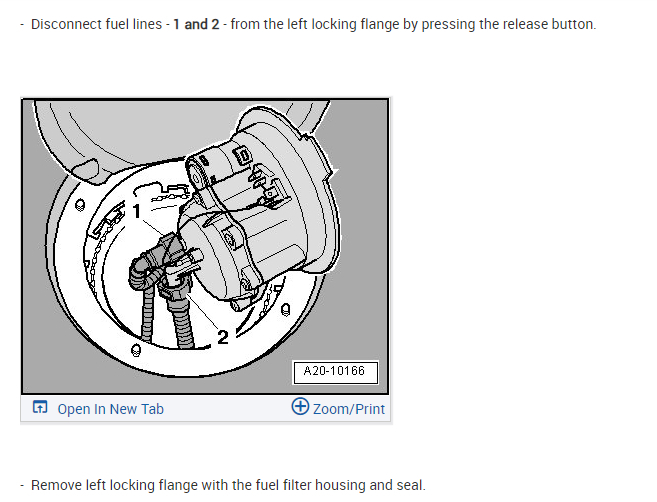

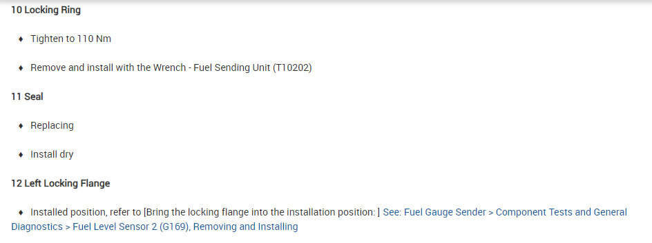

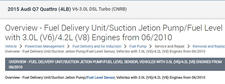

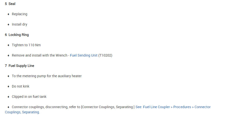

The first picture shows the location of the fuel filter. It is under the hood on the diesel. Picture 3 is an exploded view of all pump components in the tank.
The remaining pictures are the legends for each part in pic 3.
Let me know if this helps.
