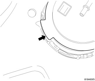

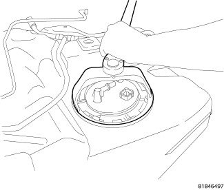

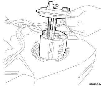

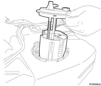

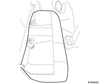

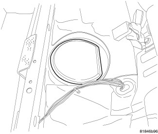

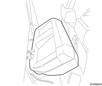

Hi, can anyone help me out here? l have filled up my fuel tank but l still have my low fuel light on and my fuel gauge is not reading. But the car runs very well.
May 10, 2018 at 7:19 PM
  • 110,194 POSTS

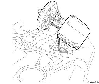

Hi Jerry and thanks for using 2CarPros.com. Chances are, your problem is related to the fuel level sending unit; although, the interment cluster plays a part in the gauge's function. I have to be honest, 99% of the time, it is the sending unit rheostat that is bad and the sending unit needs replaced. The fuel gauge is controlled by the instrument cluster circuit board based upon cluster programming and a hard wired input received by the cluster from the fuel level sending unit on the module in the fuel tank. With that being said, and on a brighter note, the pump/sending unit on your vehicle is accessible without removing the tank. Here are the directions from all data for removal. Additionally I attached several pictures which are related to removal and replacement.

Remove the rear seat cushion.
Remove plastic cover.

Use special tool #9340 to remove left side module lock ring.
Note the fuel pump location on the top of the fuel tank.
NOTE: The pump has to be properly located to the tank for the fuel gauge to work properly.
Pull module up out of fuel tank, make sure that you do not spill fuel inside of vehicle.
Drain fuel from fuel pump module. Do not spill fuel in interior of vehicle.

Position fuel pump module in tank. Make sure the alignment tab lines up on the fuel tank and pump module for Gas or Diesel fuel tanks.
While holding the pump module in position, install lock ring and use special tool Spanner Wrench #9340 to tighten lock ring.
Install plastic cover.
Install rear cushion.
