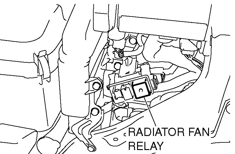

The fan not turning on. I check relay. I check continuity. I replace fan. Still not working. When I switch it to A/C it turns on but the car RPMs go all heywire. And the car wants shut off. can this be a real problem to the engine?
Jan 24, 2021 at 4:21 PM
  • 110,241 POSTS

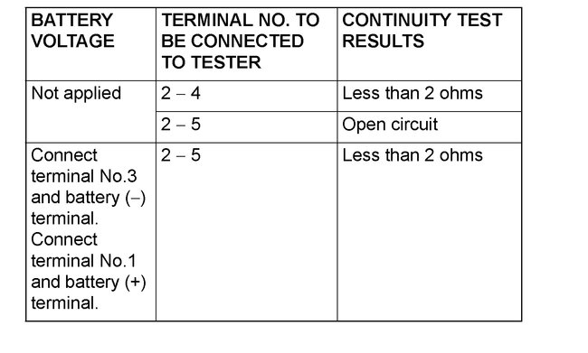

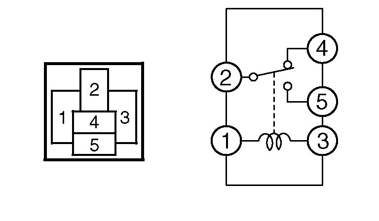

Since we know the fan is good, let's check the fan relay system. Follow these directions. The attached pics correlate with the directions.

pic 1
pic 2
pic 3
Let me know what you find.
Jan 26, 2021 at 3:55 AM
ORTEGALEONARD144
The relay has power and continuity, so I replace the relay and and then it started working for a couple days. one more quick question. is the fan supposed to be on when we have the heater on?
