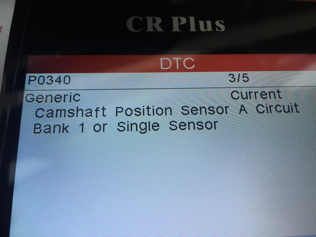

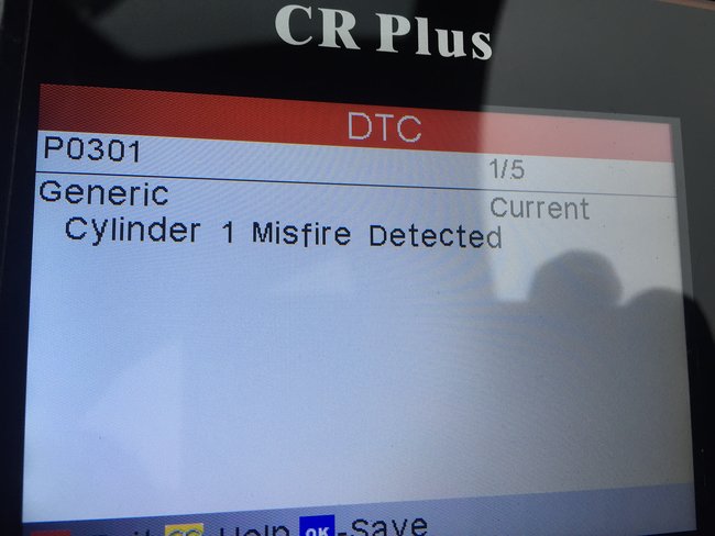

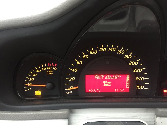

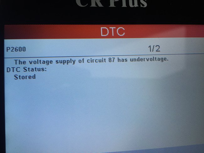

Sir, your advice will be highly appreciated.

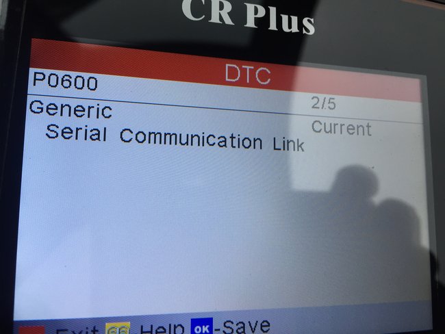

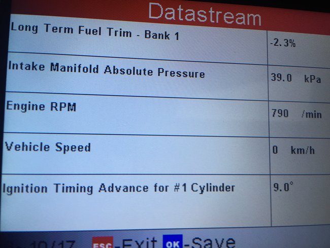

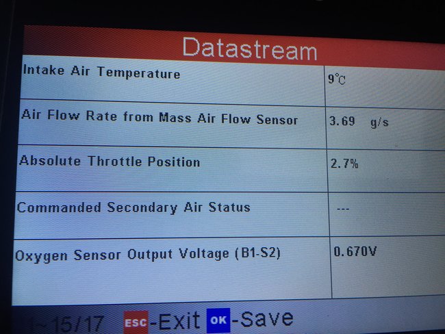

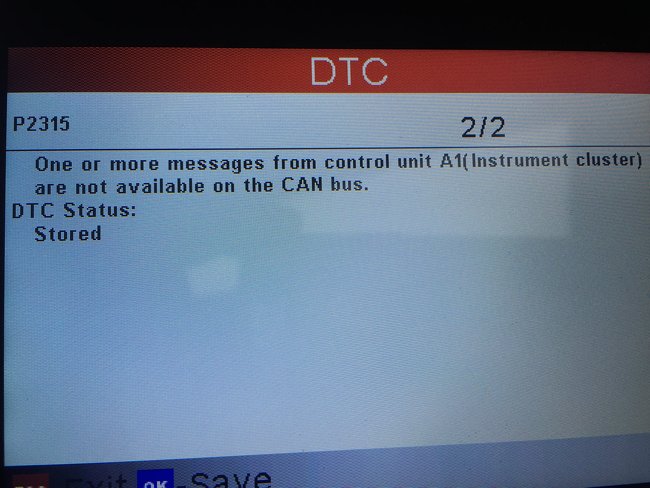

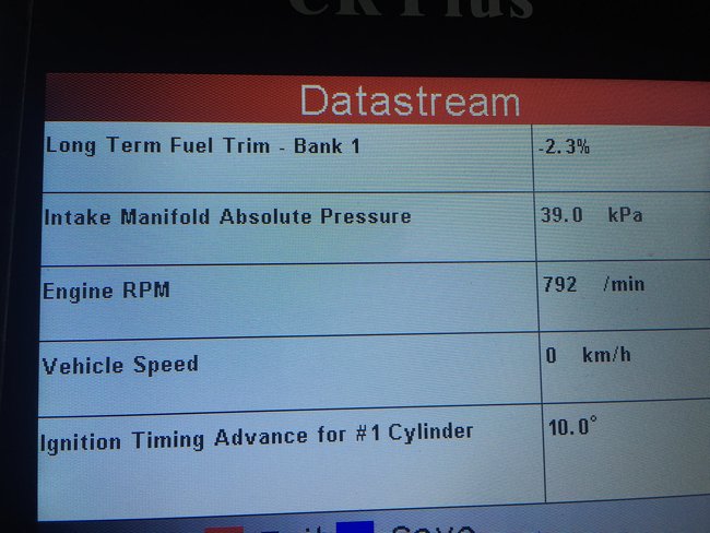

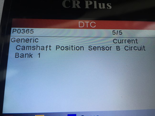

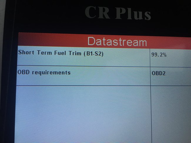

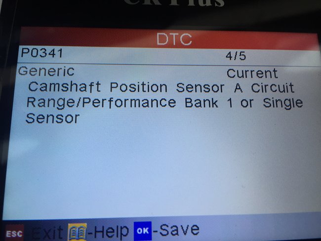

I checked the oil level by emptying the engine and the oil quantity is not low.
I did an OBD2 scan which shows as follows:
Saturday, January 11th, 2020 AT 11:29 AM
11 Replies
  • 109,867 POSTS

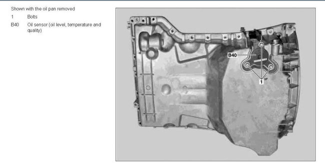

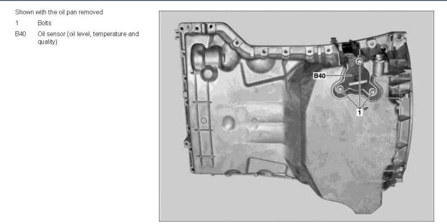

Since the light is coming on and the oil is full, I suspect the oil level sensor is bad, has a weak connection, or the wiring is damaged.

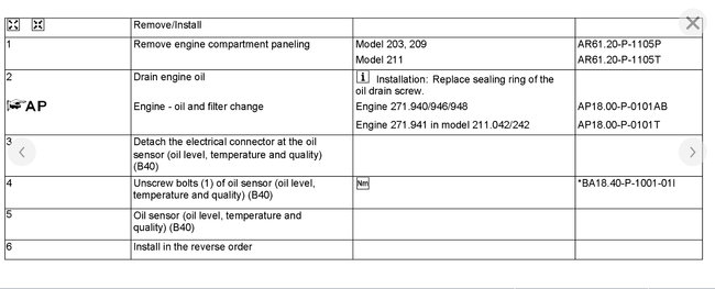

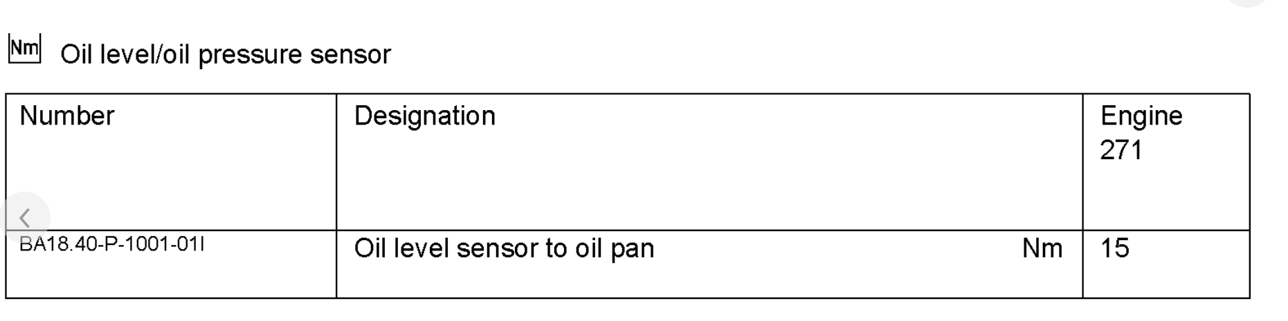

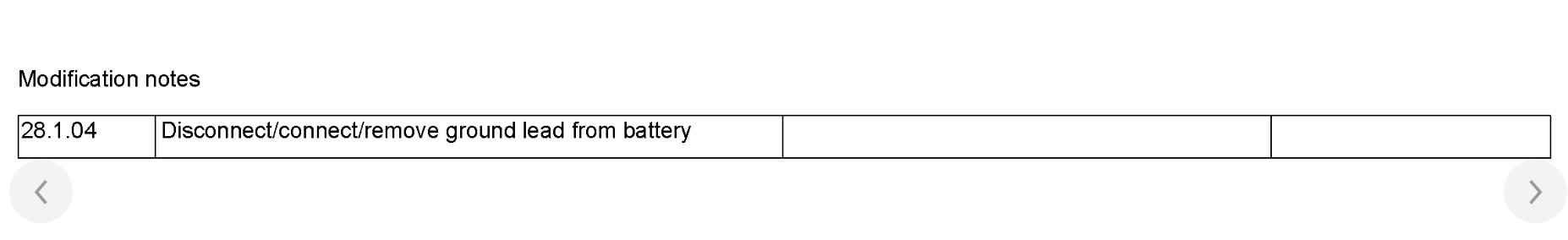

The oil level sensor on this vehicle is located on the bottom of the oil pan. Inspect wiring to it first as well as the connector. Once you confirm they are good, replace the sensor. That should take care of the issue.
The actual directions for replacement are in the attached pictures.
________________________________________
2003 Mercedes Benz C 230 (203.040) L4-1.8L SC (271.948)
AR18.40-P-5112QK Remove/Install Oil Sensor
Vehicle Sensors and Switches Sensors and Switches - Engine Oil Level Sensor Service and Repair Removal and Replacement AR18.40-P-5112QK Remove/Install Oil Sensor
AR18.40-P-5112QK REMOVE/INSTALL OIL SENSOR
Remove/install oil sensor
See attached pictures.

Sir, thanks. I will replace the oil sensor and let you know.

Sir, I checked the connections and it is perfect.I have ordered the oil sensor online and as soon as I fix it I will let you know. Have a blessed weekend, bye.

Sir, good morning. As I replaced the engine oil sensor the check engine light went off. So I am very happy with that. Thank you so much for your valuable advice. Have a blessed day, bye.
