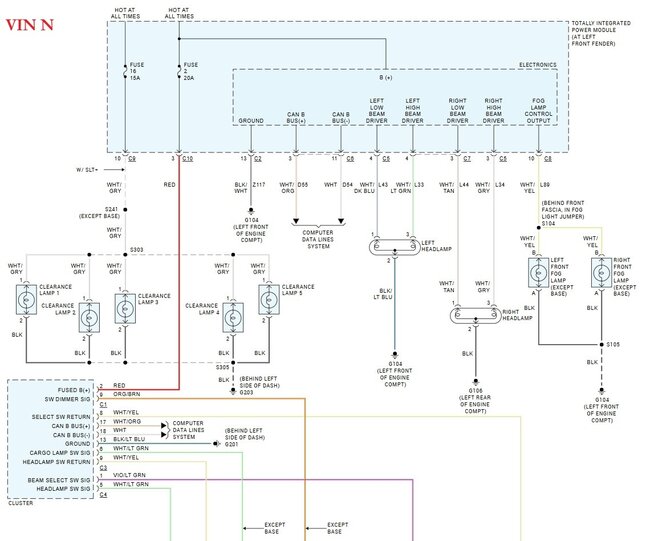

Can you please provide me with a wiring diagram for the truck listed above? I need to determine what pins the low beams connect to coming out of the TIPM.

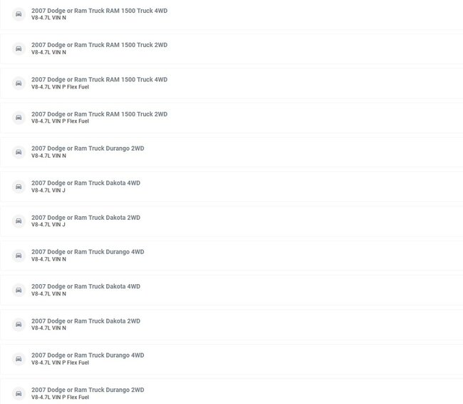

The VIN P has listed Flex Fuel vehicle, 4.7 Durango or Dakota 2 or 4wd. Theres also RAM 1500 listed with a 4.7. So, If you could just give the rest of the vehicle info that would be helpful to make sure you get the correct diagrams.
Jan 9, 2025 at 4:29 AM
AL514
  • 5,664 POSTS
This is all that all data lists for Dodge 4.7.

2007 dodge ram with 4.7, vin 1D7HA16P77J520992.
Jan 9, 2025 at 4:38 AM
AGRATIGERMB
  • 8 POSTS

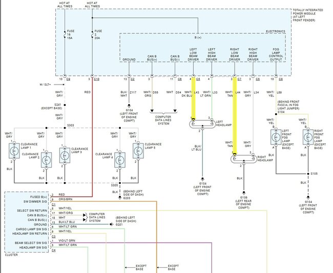

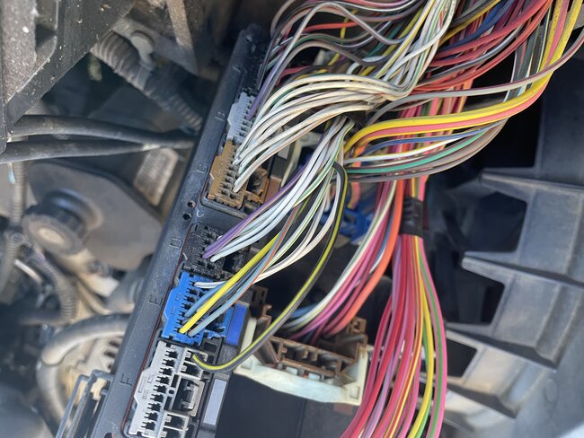

Wanting to splice the left low beam driver wire to the right low beam driver wire. One wire is white and tan the other is white and blue. However, there are several of that same color combination. I just want to make sure I am grabbing the correct one.
Jan 9, 2025 at 4:40 AM
AL514
  • 5,664 POSTS
Got it, I do see that all those wires come directly from the TIPM separately, on different drivers (power transistors) so you can try this, but these circuits might be monitored for current flow inside the TIPM, I assume you have the right side out with no power coming from the TIPM itself, or you're still verifying that? I'll grab the OEM diagrams as well for the head lamps.
Jan 9, 2025 at 4:45 AM
AGRATIGERMB
  • 8 POSTS
Yes, the right side has no power. I used test clips and connected the two at the build itself and everything worked so instead of running a wire under radiator I was going to do a splice coming out it TIPM.
Jan 9, 2025 at 4:47 AM
AL514
  • 5,664 POSTS

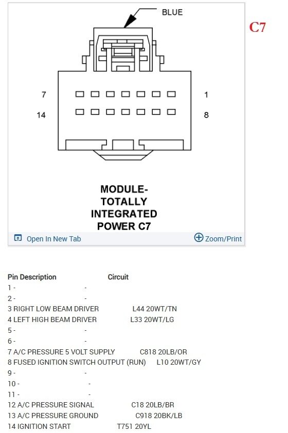

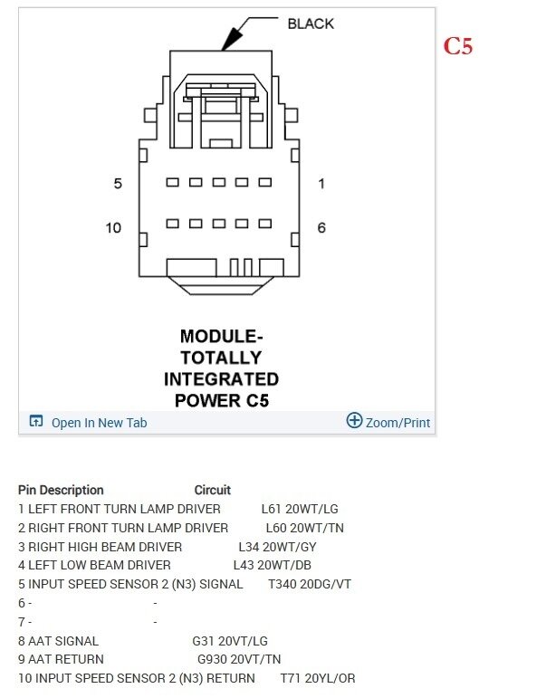

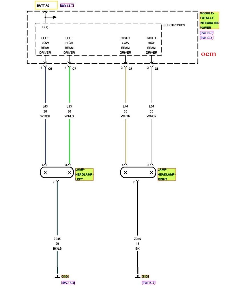

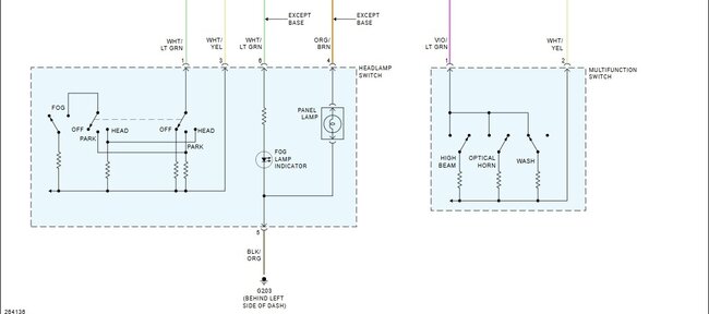

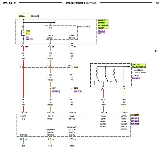

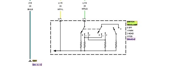

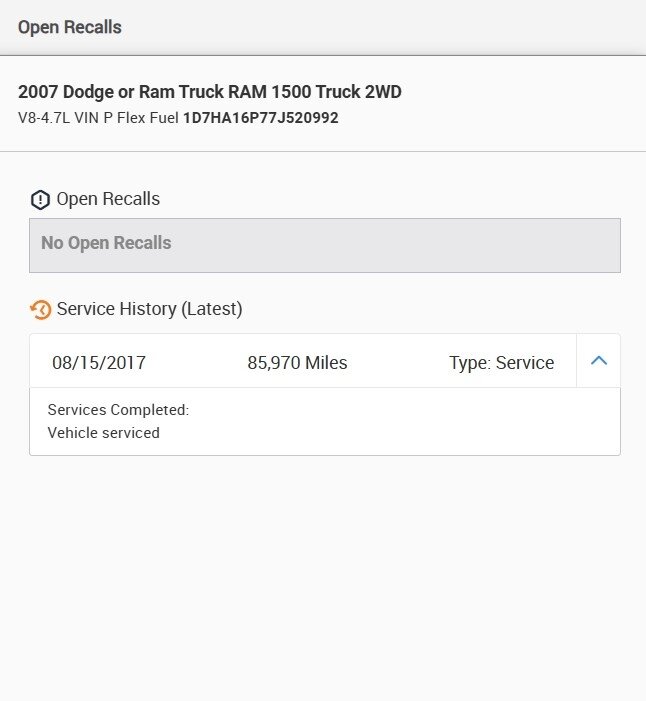

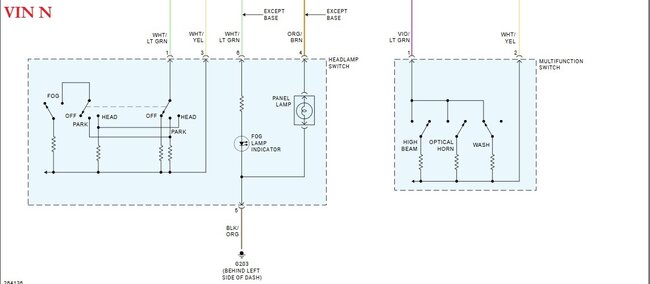

Okay, diagrams 1, 2 are top and bottom, I would use these aftermarket diagrams because as you can see the OEM diagrams 3,4,5 are actually really bad, I would have expected much better from the manufacturer, but the aftermarket ones look correct in their colors. The left low beam is out of connector C5 (pin 4 white/dark blue) and the right side is out of C7 (pin 3 white/tan) so that looks correct as well.
Jan 9, 2025 at 5:01 AM
AL514
  • 5,664 POSTS
They also list any open recalls when a VIN is put in, and it lists the last known service as well.

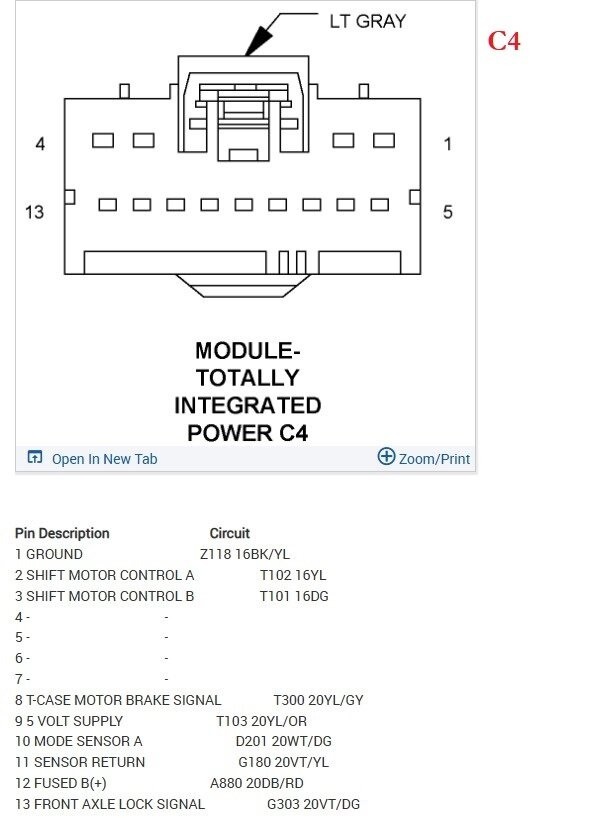

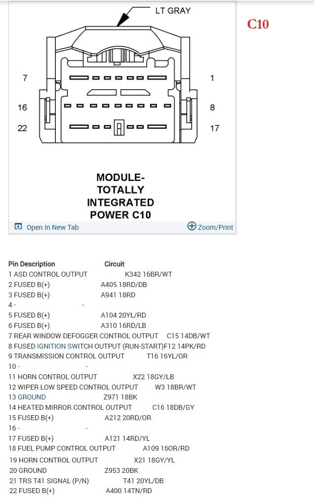

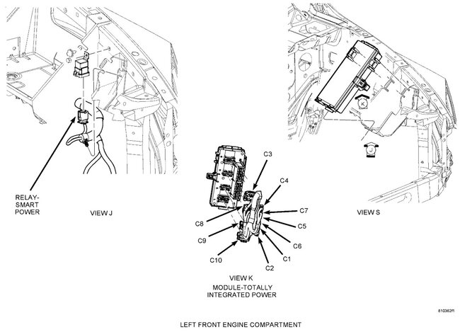

Sorry don't want to sound ignorant but which connector cluster is it? You have C5 and c7 but there is only one c cluster. I assumed I would need the out cluster because I want to splice on the wire to the bulb itself.
Jan 9, 2025 at 5:08 AM
AL514
  • 5,664 POSTS

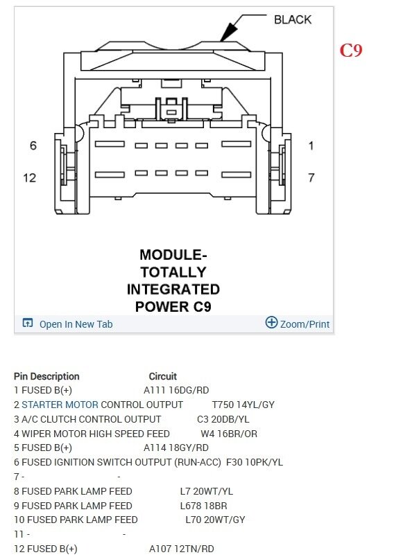

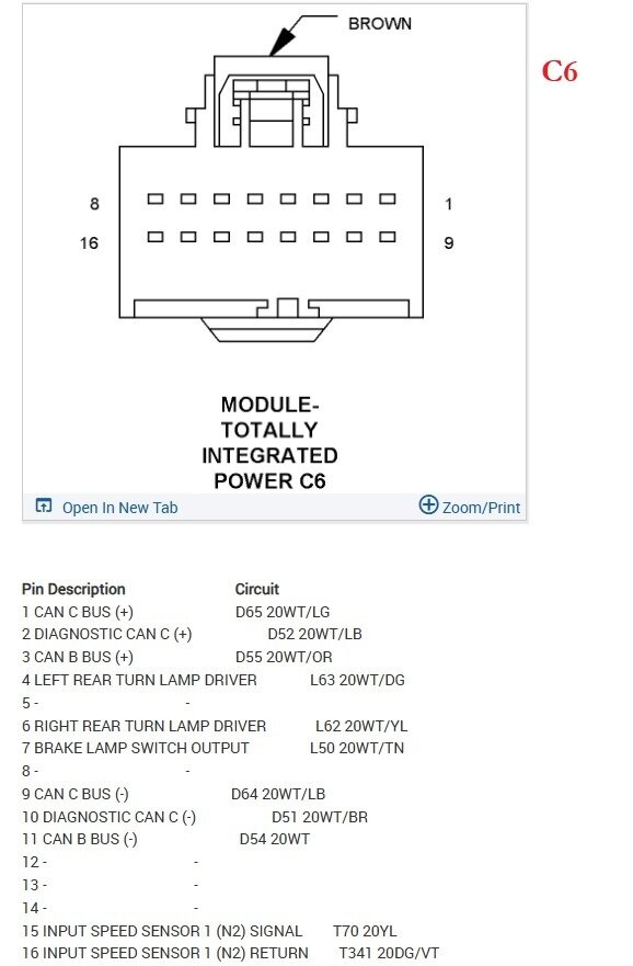

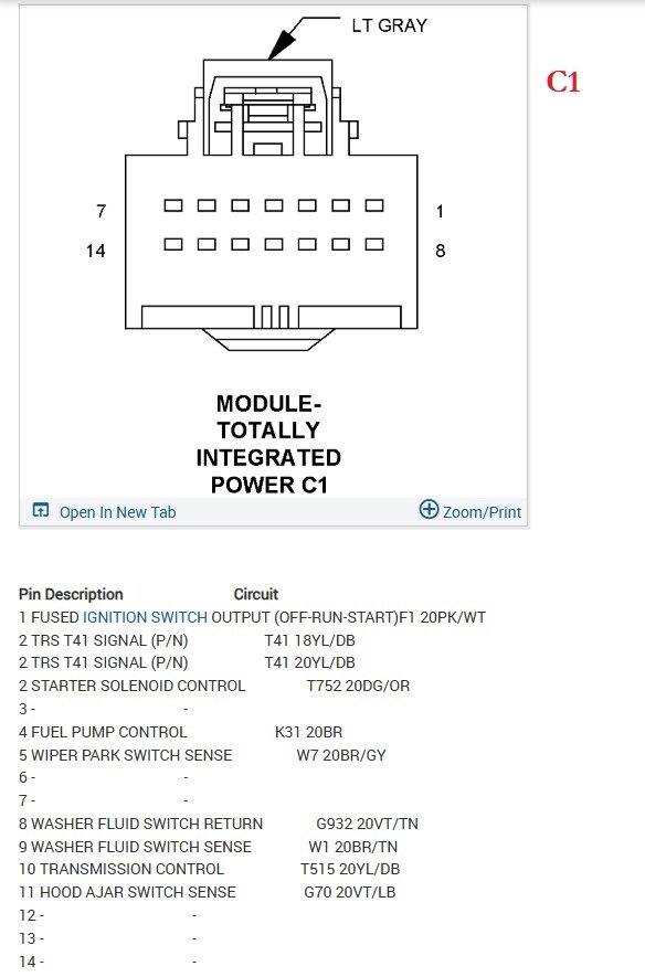

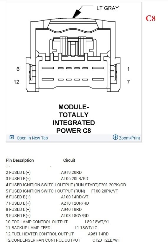

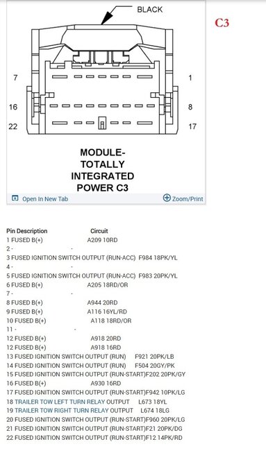

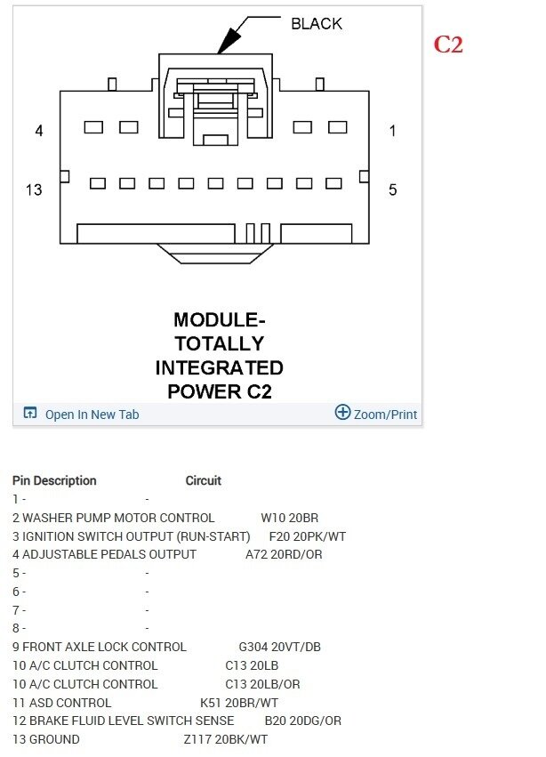

I'm getting you the connector pinouts, I see there's 10 connectors, give me a second.
Jan 9, 2025 at 5:12 AM
AL514
  • 5,664 POSTS
Here are each connector with the connector number, it shows the basic connector color.
Jan 9, 2025 at 5:26 AM
AGRATIGERMB
  • 8 POSTS
This is awesome, and just what I needed. Thank you so much. Now to get to splicing.
