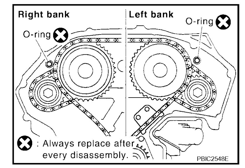

There are three different chains that keep the engine in time. it is possible that the chains are worn or the guides are worn allowing the engine to go out of time.
https://www.2carpros.com/articles/how-a-timing-belt-works
The front cover will have to come off to verify all the settings for the chains to be sure they are correct. if all that is okay, then it is most likely a internal failure such as burned valve, worn piston rings.

I do not like this answer because the timing chains on the vehicle are okay and also both VVT valves have been done. but still only 90 and 95 lbs compression on one side.
Jan 4, 2019 at 9:51 AM
Okay, sorry, I base my answers on your input. low compression on one side has timing in common.
I guess you removed the cover and verified but somebody missed something.
