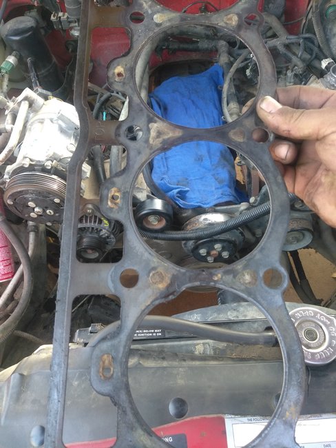

Thank you for the reply. I took the head off today and the head gasket had damage to it from both the cylinders that are low. I noticed one of the cylinder has a little gash around the rim. I know this is not good but is it bad?

Thank you for the reply. I took the head off today and the head gasket had damage to it from both the cylinders that are low. I noticed one of the cylinder has a little gash around the rim. I know this is not good but is it bad? The damage to the gasket does not line up with the gash on the cylinder.

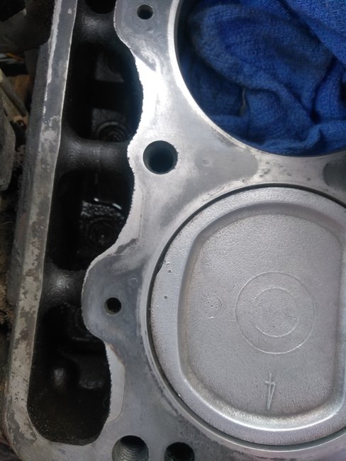

From what I can tell, you might be over-thinking this. Exhaust gas is corrosive and can attack the head gasket. Once a path forms through the gasket, the flow of additional hot gas can burn the metal ring and push it out. There really is not any defect that led to that.
Do not panic if you find small cracks between the two valve seats in the head. Those are common and harmless. Proper surface finish is most important for good sealing of the new gasket. I do not like the Scotch pads on rotary air tools because they can gouge into aluminum heads too easily. You will have better luck with the discs with plastic fingers. It is also a good idea to take the head to an engine machine shop to have it checked for flatness. They will use a precision straight-edge to measure the warpage. You can have up to .005" warpage on a cast iron head, and .002" on an aluminum head.

Awesome! I was nervous opening this message. I was told that the piston was bad by a co-worker and I wanted another opinion and I was anxious to know if that little gash was a big deal. I was hoping it was not. Thanks for the information, it is greatly appreciated! Update: I went back to read my previous messages, I meant to say there is a little gash on the rim of the piston. I attached a picture, I could not circle the spot but if you look a closely around the piston and the combustion chamber, there is a little gash. Hope it is still not a issue, as long as the head and block have a good seal. Fingers crossed.
