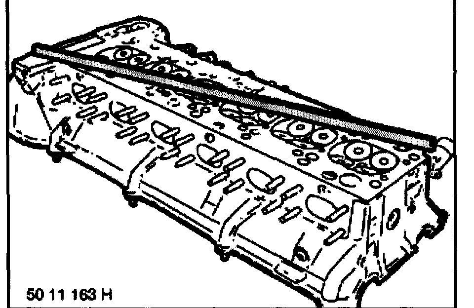

Hello and welcome to 2CarPros. Your description sounds a lot like a blown head gasket or a crack between cylinders 2 and 3. It isn't a fully open one but acting like a one way valve, allowing compression pressure to transfer from cylinder 2 into 3. A test that should show that would be a modified leak down test, bring cylinder 2 up to TDC on compression and lock it in place. Pull all the rest of the spark plugs. Now use the hose from the compression tester (remove the schrader valve from the tip first) and apply 100 psi to cylinder 2. Listen at cylinder 3. You shouldn't hear anything if there is no leakage. if you hear air, there is a problem.
If the engine was okay prior to this you might be able to save it with just a head gasket, but you would need to check the head and block with a straightedge and there are some special tools needed to deal with timing the cams and VANOS system. Book time is 20 hours.
Depending on the vehicles shape and mileage a used engine might be a faster and easier option, possibly cheaper as well depending on where you get it.
One thing I would suggest if you opt for repairing it, get a copy of the factory service/workshop manual. There are a lot of checks and measurements to be done.

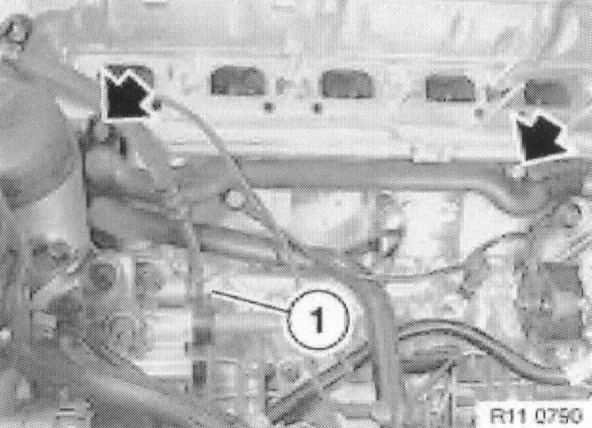

Release banjo bolt (1) and disconnect oil pressure line for VANOS adjustment unit.
See image 1 below

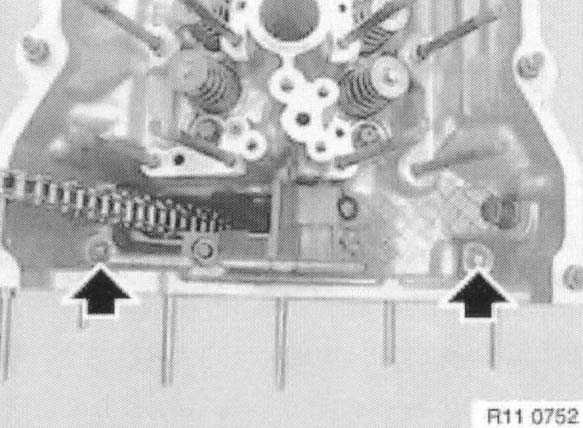

Release screw connection between timing case cover and cylinder head.
See image 2 below

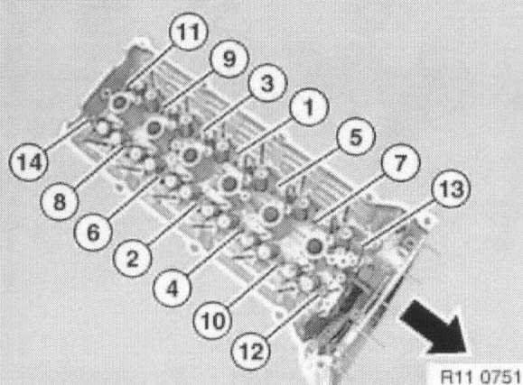

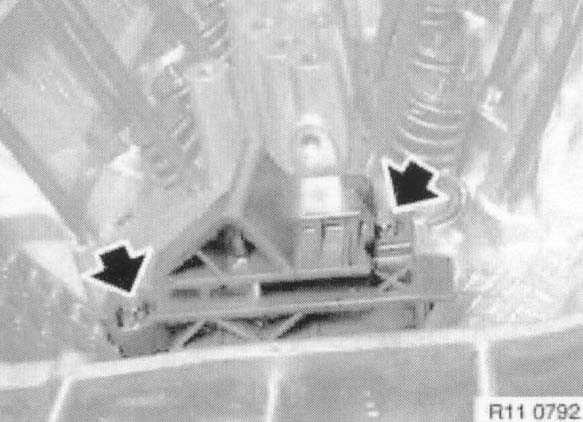

Release cylinder head bolts from outside to inside in sequence 14 to 1
See image 4 below

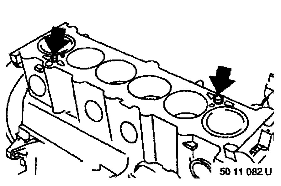

Clean sealing faces of cylinder head and engine block; if necessary, remove traces of sealing compound with hardwood spatula. Make sure no gasket remnants drop into oil and cooling channels.
There must be no oil in the tapped holes of the engine block and the timing case cover due to a danger of cracking and distorted tightening values.
See image 5 below
Check dowel sleeves for damage and correct installation position.
Apply permanently elastic sealing compound Drei Bond 1209 to joints to timing case cover.
Replace cylinder head gasket.

Tighten down cylinder head bolts in sequence 1 to 14.
See image 4 below
Tightening torque: Initial torque 40 Nm. Then 90 degrees and a second 90 degrees.

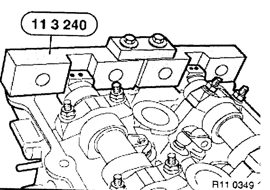

Install camshafts. Time the camshafts using the special tools-
Images timing 1 and 2

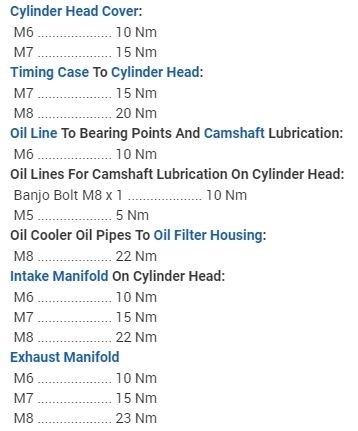

Torque specs are the last image.
