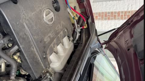

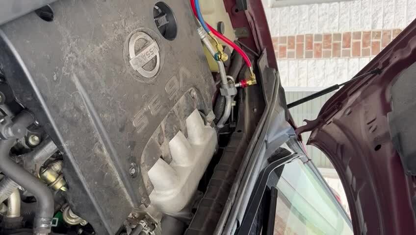

I measured the pressure on the low- and high-pressure side of the car today, Results as follows:
Outside temperature - 86F
Pressure low side - 26 psig
Pressure high side - 180 psig
Temp out of vent 62F
From these results, it looks like low charge. Should I recharge after having the refrigerant evacuated at a shop?
I enclose a video of the engine and A/C running during the measurement. There is a click-click sound that can be heard in the background. Can you tell me what this sound denotes? Hope it doesn't have to do with the compressor.

If you turn the A/C system off the noise should go away if it is compressor related, to me it sounds like a loose spark plug or an ignition system leak. See if you can get a better idea of where the noise is coming from and go from there, you can start a new thread for the noise and upload a video closer to the noise to help us see what's going on, as afar as the A/C system, yes I would do a vacuum down and recharge.

I evacuated it but could not get it to hold vacuum. So I took it to a shop. They evacuated it and refilled it with a dye and told me to bring it back if it loses refrigerant, so they can detect where it has been leaking.

Nice work, also the dye will be tough to see if the front seal of the compressor is leaking.
