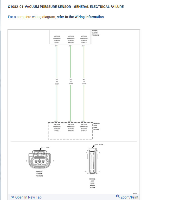

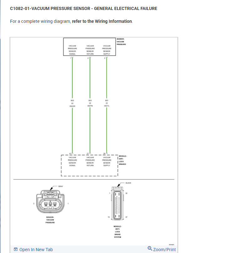

C1082 vacuum pressure sensor erratic.

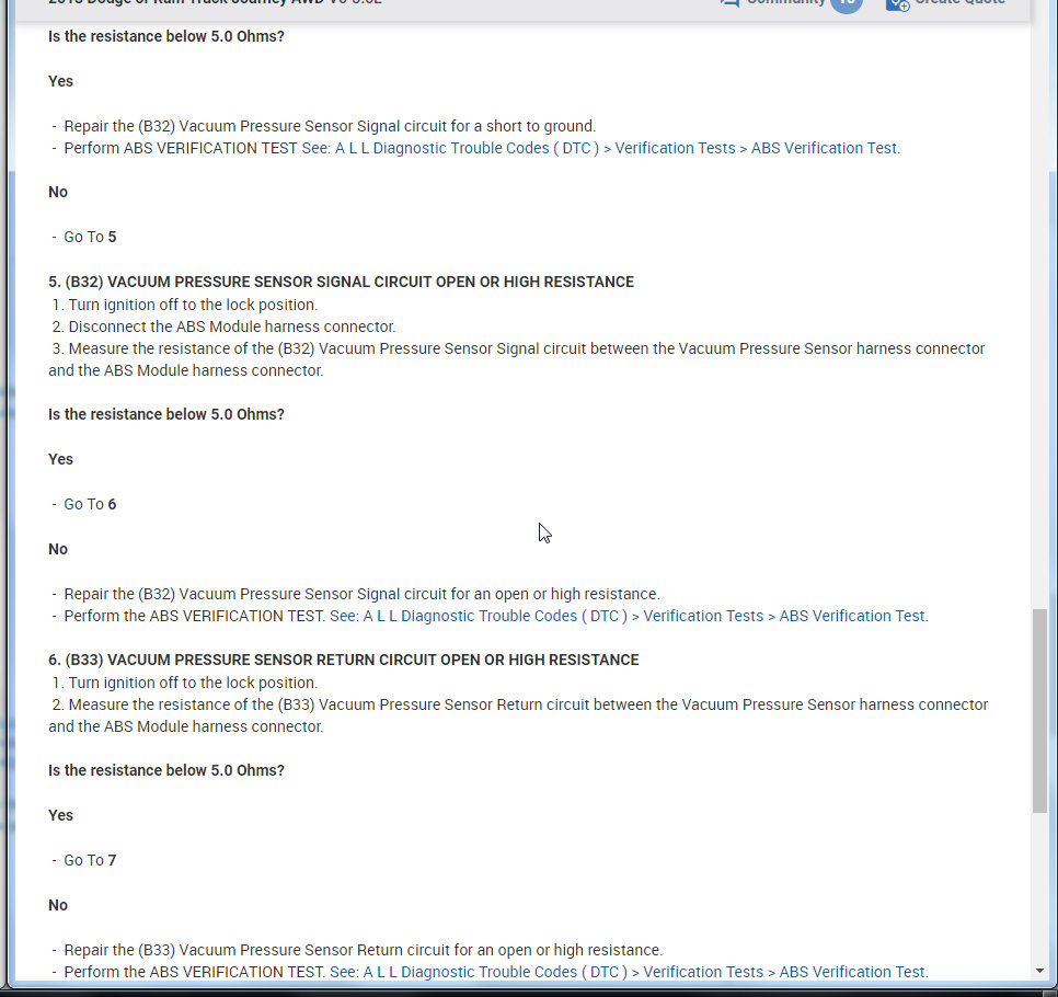

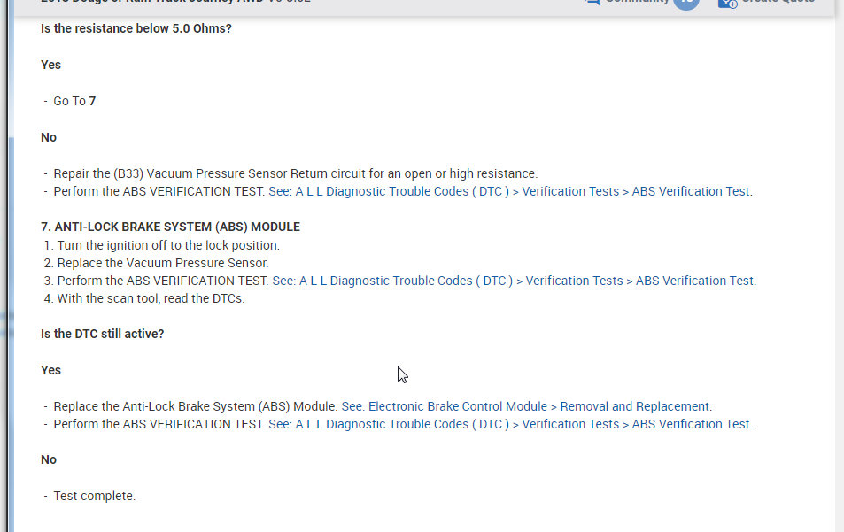

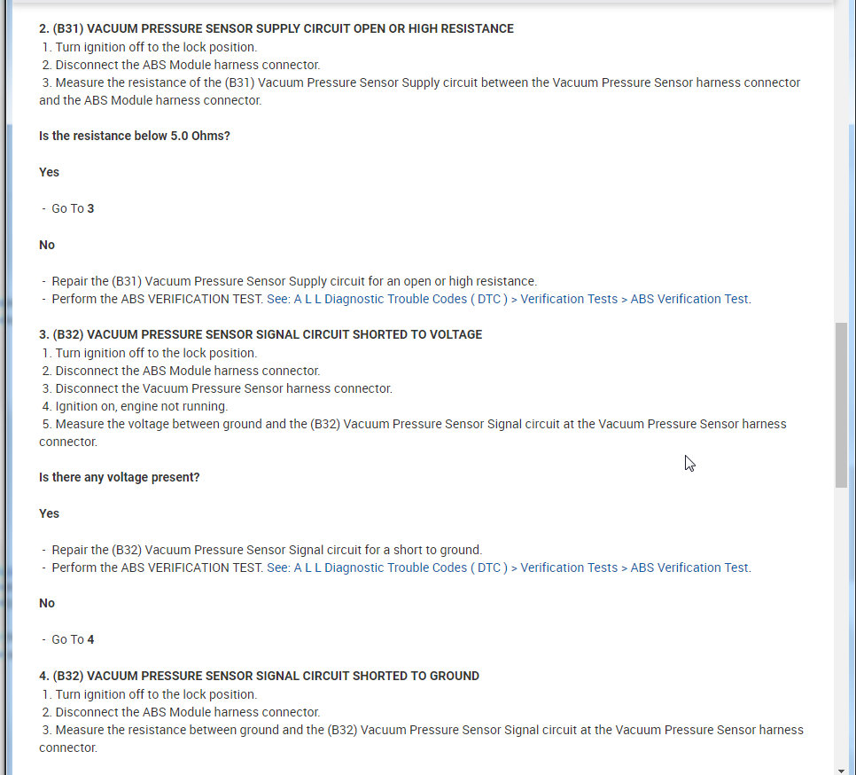

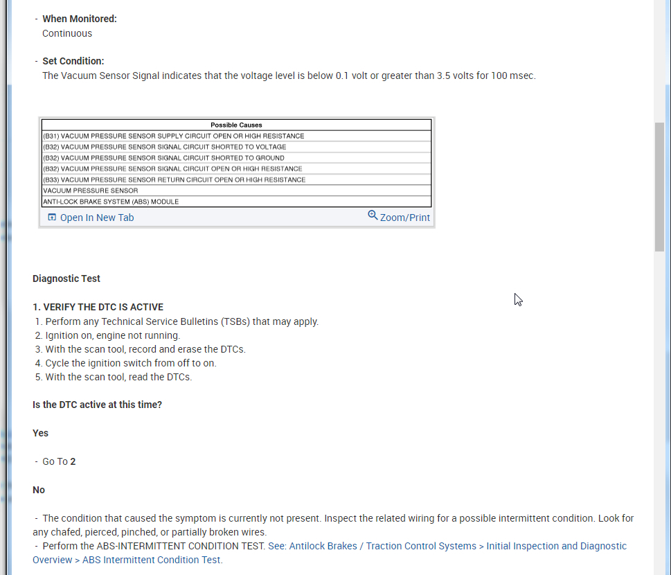

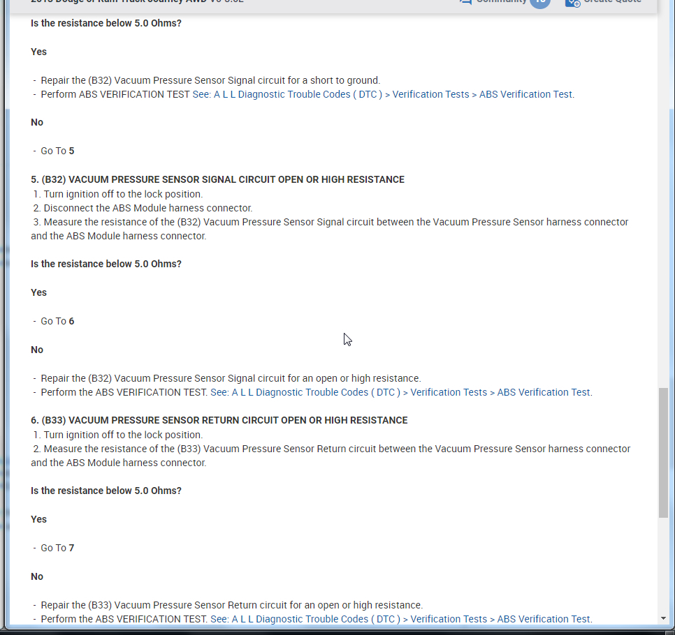

However, with those two codes it looks like the ABS module is the issue. So here is the testing for the C1082 as it appears to be the primary code for this issue.
If your tool is able to perform the ABS verification test after the booster sensor and circuit prove out then that will confirm the module is the issue.

To be honest I have a hard time understanding how vacuum comes into play here. But swapping out vacuum sensor is cheaper and easier than swapping out the ABS.
Question ABS module . Hydraulic control module or electronic control module ?
Not sure about the ABS verification test, new tool, but will research.

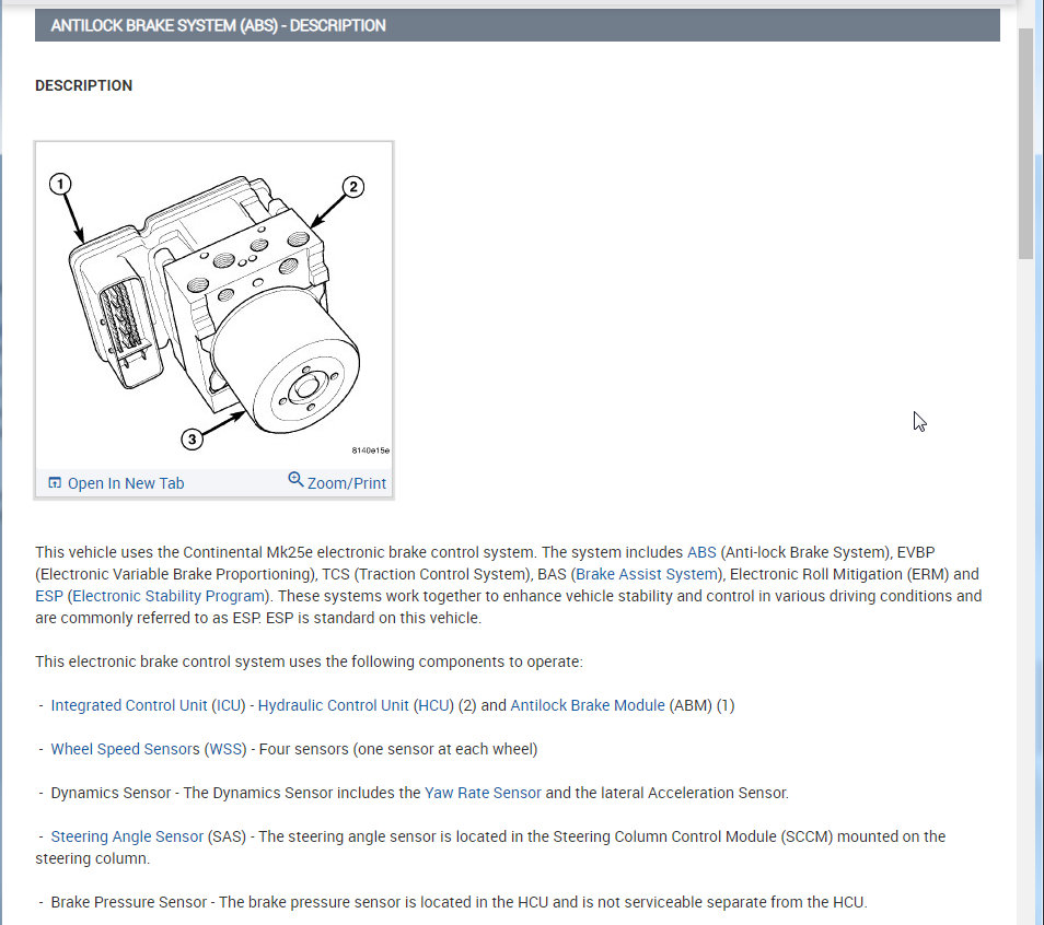

Are you asking which your vehicle has or what it is called? You have an ABS module and a hydraulic control unit.
I attached some info on this below if you are interested in it.

Went to the U pic it today and got a vacuum pressure sensor Was tempted by the whole ABS unit but no way to cross reference part number.
So much for the right to repair.

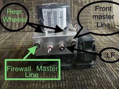

Meanwhile back at the Dodge plugged each port of the master separately
Front port plugged high hard pedal.
Rear (firewall) plugged low hard pedal.
Spent a good bit of time following brake lines to no avail.
No way of knowing what comes out from the HCU. A diagram of the hydraulic circuit would be nice but nothing on the net or Alldata.

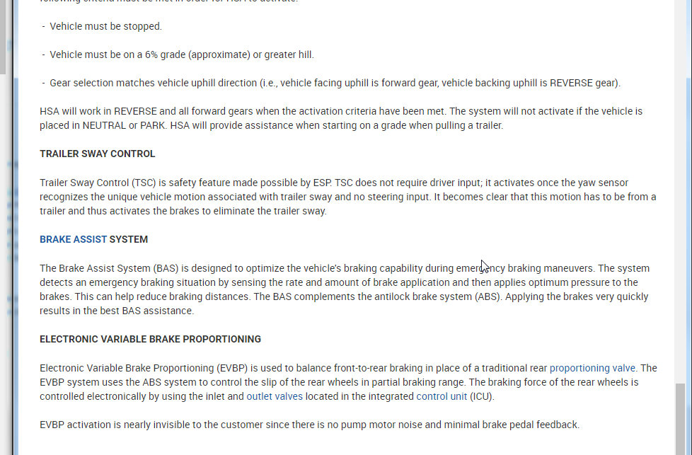

Hi guys. Are you aware the rear calipers do not self-adjust like front ones normally do on all cars? This was on of Chrysler's first attempts at switching over to the really miserable caliper design used by GM and Ford for decades where the parking brake is built into the calipers. It sounds to me like the right rear parking brake cable is rusted tight, so that one never applies. You have to apply the parking brake repeatedly to adjust these calipers. That can also be done at the wheel by applying the lever repeatedly with a large pliers.

Near as I can figure the front brake line (low pedal) off the master controls the front left and right rear brakes
To state the obvious the rear line off the master (firewall side) (high hard pedal) controls the front right and rear left brakes.
Wish I could find a illustration of the hydraulic circuit somewhere
Lose the brake line tracing at the firewall and just before the rear lines split off
I am somewhat confused by KASEKENNY1’s response about the “rear circuit” As far as I am aware brake circuits are split diagonally. The effect of the proportioning valve ( I assume it is done by the ABS computer) baffles me also.
I believe that there is a problem HCU with a stuck valve, bad seal, stuck solenoid.

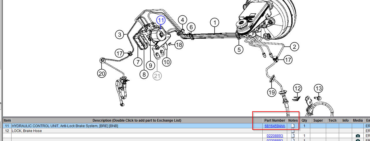

Dodge does not make it easy when it comes to part numbers.
My son told me that as soon as Dodge has an updated part number they erase all reference to prior numbers and compatibility.
My parts number is P68171432AC.
The closest I can find is on eBay The part number is P68171432AD.
Even this close I am hesitant I did email the seller.
If you haven’t noticed I am a firm believer that the devil is in the details. The part carries a 60 day warranty with the option for a 1 year protection plan for an additional $20.00 that I haven’t looked into yet.
I am not sure if this unit would be plug and play or requires programming by the dealership.

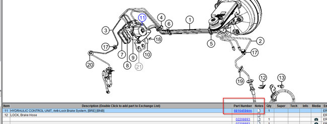

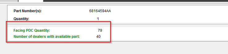

Can you provide the last 8 of your VIN and I will look the part number up? Those part numbers are not coming up in Mopar's system so let's see if we can get the current number.
As for previous parts, that is true to a point but all that happens when they supersede the part is made some change to either the part or combined part numbers. However, I can look to see if any dealers have any of the part numbers.
Mar 23, 2021 at 10:34 AM
PEPPERMRJAY
  • 16 POSTS
last eight of the VIN is DT507329.
Thanks
Mar 23, 2021 at 12:56 PM

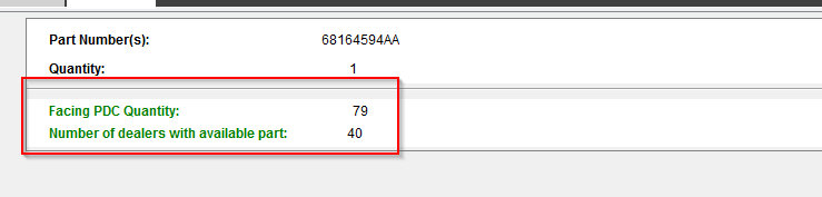

Part number according to Mopar for your HCU is 68164594AA.
I am showing a lot of dealers having one in stock but Mopar's depots have a lot as well so they are readily available. However this number can be cross referenced to after market options as well.
Let me know if you have other questions. Thanks

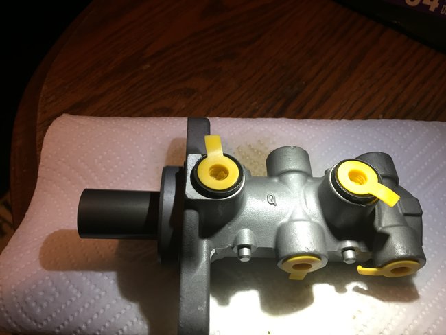

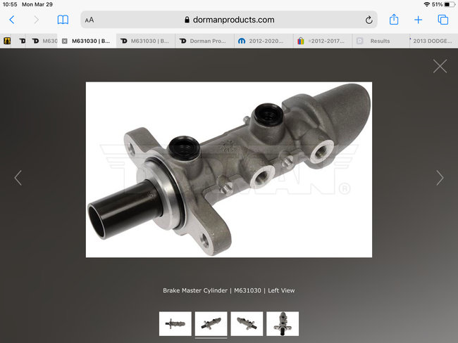

Well, the fun continues.
Installed the HCU but no improvement.
Went to install the new master only to find the reservoir would not fit.
Nobody would hire me by the hour.
Couldn’t make a living flat rate.
Be well all.

Okay, checking Dorman’s site and finding a photo of my unit but fitment is for a 2014 Journey.
They do cross reference to OEM.
Dodge site shows and lists a different number.
When I searched the Dodge site for the Dorman number it brings up a match to my unit and lists it for my 2013 but no pic.
So at least I have a line on the the proper master.
I opened the 5fh quart of dot 3 for the HCU.
Might need a 6th.
