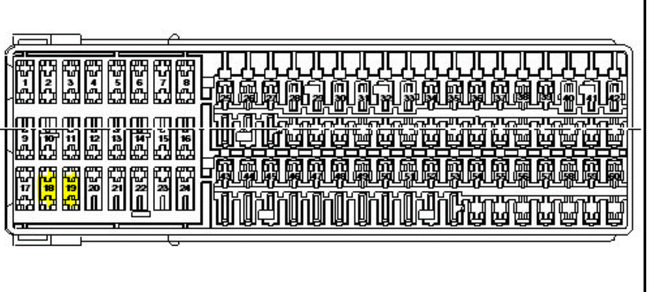

Low beams not working
2012 VOLKSWAGEN JETTA
90,000 MILES
DARREN T DUNCAN
Changed bulbs still not working. Can't find fuse box diagram to check the fuse or relays.

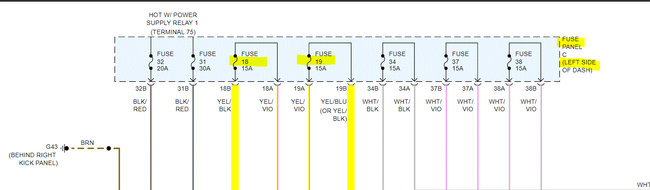

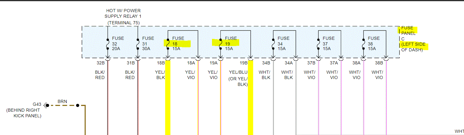

There are two fuses for the low beam, one for each side.
If you look at pic 1, I highlighted the two fuses related to the low beam. The fuse box for these is fuse box C (left side under the dash). I attached a pic of the box and the relevant fuses to check.
Let me know if this is what you needed or if you have other questions.
