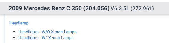

Hi, I purchased the car without low beam. so i bought the cheap square base with a bulb and a wire out off it, it worked for few seconds then only one (right side stilled work). okay, s, i bought the led square base one ..it work only on the right side again so im asking myself if i could swap between my two(2) cars which is 1-2009 C350 W204 MBenz 4 door sedan vs 2- 2006 D.Charger SXT 3.5l 4dr sedan use the cable or the bulb retro fit or something like that. thank you

Wow, that's a tough one. Usually, I only deal with a direct replacement. In this case, are the wiring connectors correct or the same? Also, does the vehicle have Xenon lights or not? See pic below. I can get wiring schematics for you, but I need to know which circuit you have.
Jul 30, 2023 at 2:15 PM

Hi JACOBANDNICKOLAS,
Thank you for the guidelines. Its w/xenon for hi/low beam and wo/xenon for the fog (round with a mini fan under it and the plug this like a normal 2 pins ones.

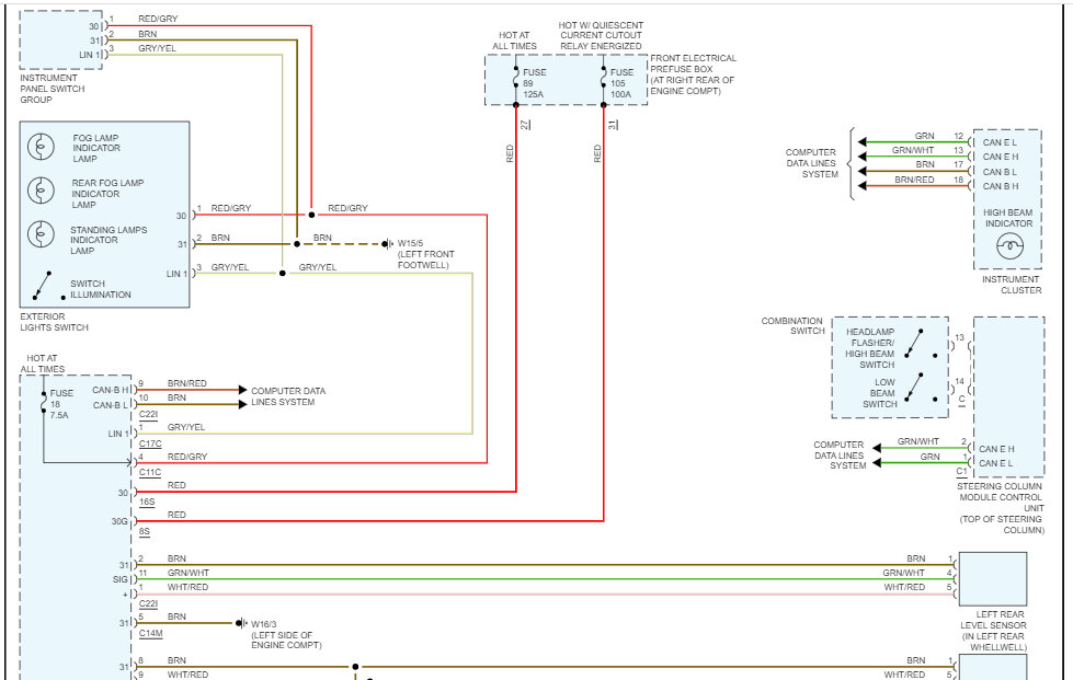

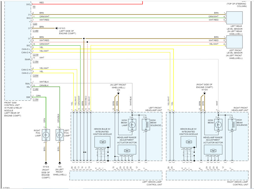

I attached the wiring schematics for the Xenon lights below. It was one page long. However, I had to cut it in two to make it readable. I did overlap the two so you can follow from one to the next.
Take a look through them and let me know if they help.
