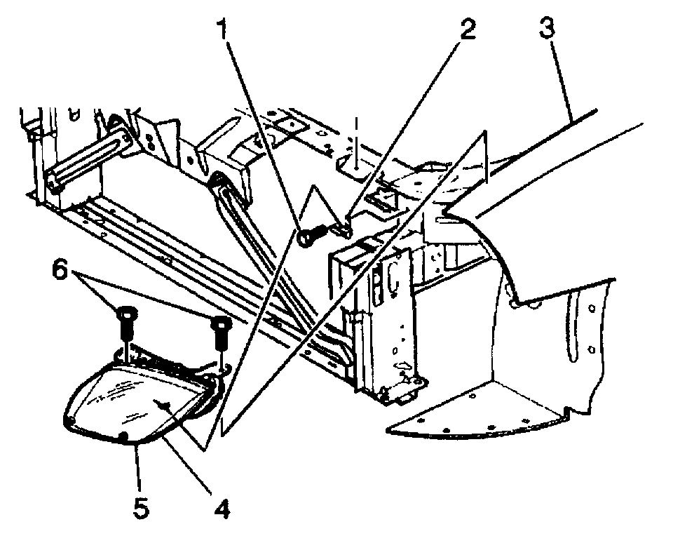

As far as I can tell all other lights work. Headlamp bulb looks okay, but did not remove it. Any ideas? Please and thank you!
Jan 6, 2020 at 1:06 AM
  • 110,244 POSTS
If I recall, there is only one bulb on each side of the vehicle. Each bulb has two elements in it. I suspect the low beam element has gone bad. The first thing you should do is simply remove the bulb and you can check if for continuity to see if the element is bad.
_____________________________
Here are the directions for bulb replacement. The attached pics correlate with the directions.
2002 Chevrolet Cavalier L4-2.2L VIN 4
Procedures
Vehicle Lighting and Horns Headlamp Headlamp Bulb Service and Repair Procedures
PROCEDURES
HEADLAMP ASSEMBLY OR HEADLAMP BULB REPLACEMENT
REMOVAL PROCEDURE
CAUTION: Refer to Halogen Bulb Caution in Service Precautions.
pic 1
1. Remove the hood close out filler panel.
2. Remove the bolts (6) from the headlamp.
3. Remove the headlamp from the headlamp mounting panel.
4. Disconnect the electrical connector from the headlamp.

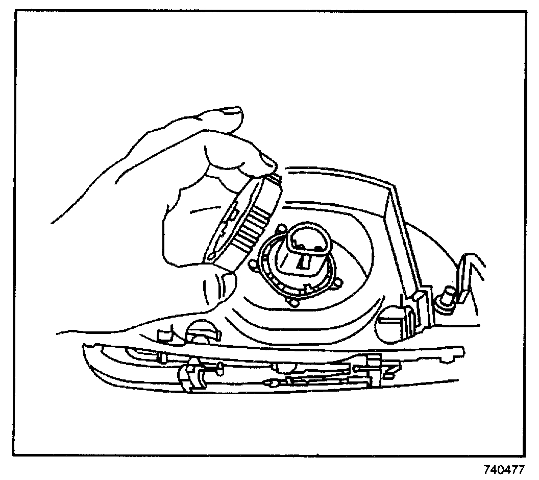

pic 2
5. Remove the headlamp bulb/socket retainer ring from the headlamp.

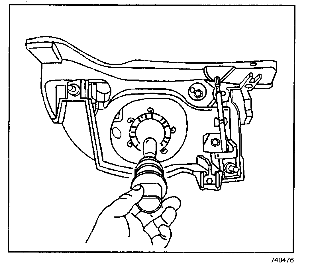

pic 3
6. Remove the headlamp bulb/socket from the headlamp.

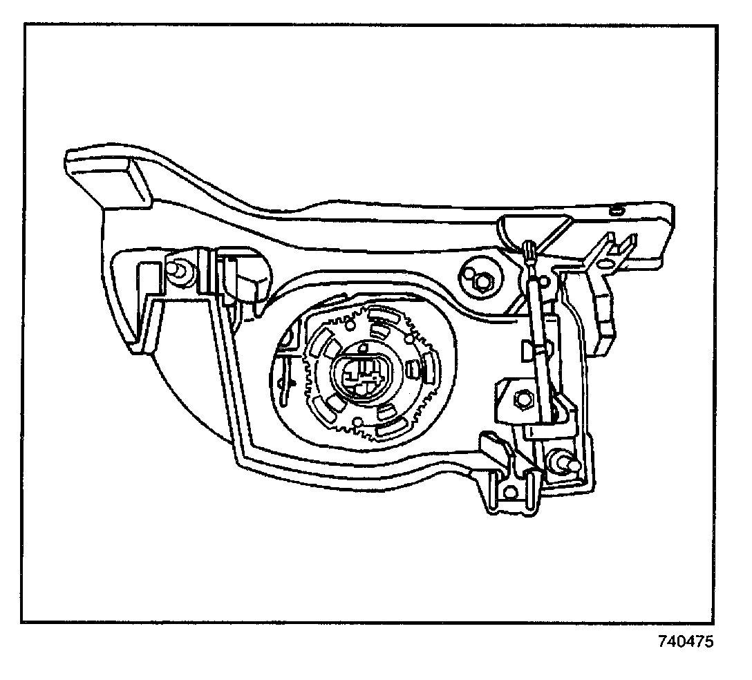

pic 4
7. Remove the bolts from the headlamp adjuster mechanism, if required.
8. Remove the headlamp adjuster mechanism, if required.
