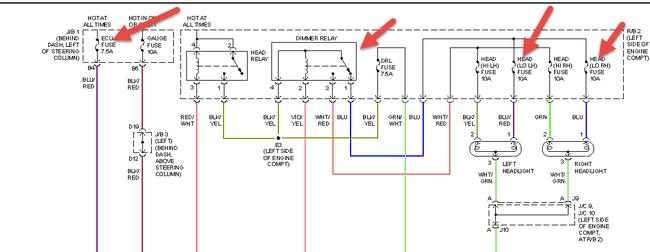

I have a 2001 Toyota Tacoma I have been running the light all the time this morning went out to go in the truck noted the high beam indicator was on try to cut it off and it will not cut off got out of the truck and noted the low beam light was not on anymore I tried to replacing the the light bulb still light would not come on getting power to one of the pigtails what could be going on
Aug 1, 2014 at 12:12 PM
HMAC300
  • 48,601 POSTS

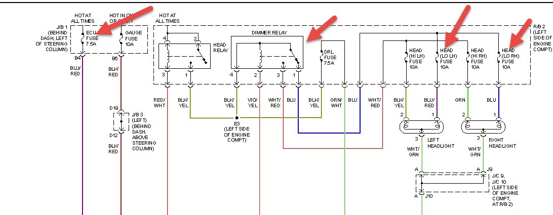

ic an be your body module and or the multifunction switch or a bad connection at junction block. also a bad ground which is on right and lh sides of dash. if you have drl lights-DRiving lights, then check items in pic as well as drl module with a scanner
Aug 1, 2014 at 11:55 PM
HARTLEYKID
  • 20 POSTS
I already check the pigtails with a test light I am getting power to the left side no power on the right side so I'm thinking I may have a bad ground somewhere what do you thinkI might have burnt something by running the lights constant
Aug 2, 2014 at 4:12 AM
HMAC300
  • 48,601 POSTS
reread my reply because it can be a body module in both drl and no drl which you haven't said you have.if yo have drl check the fuses pointed out if not then it maybe a wiring issue or the things I have already listed.
