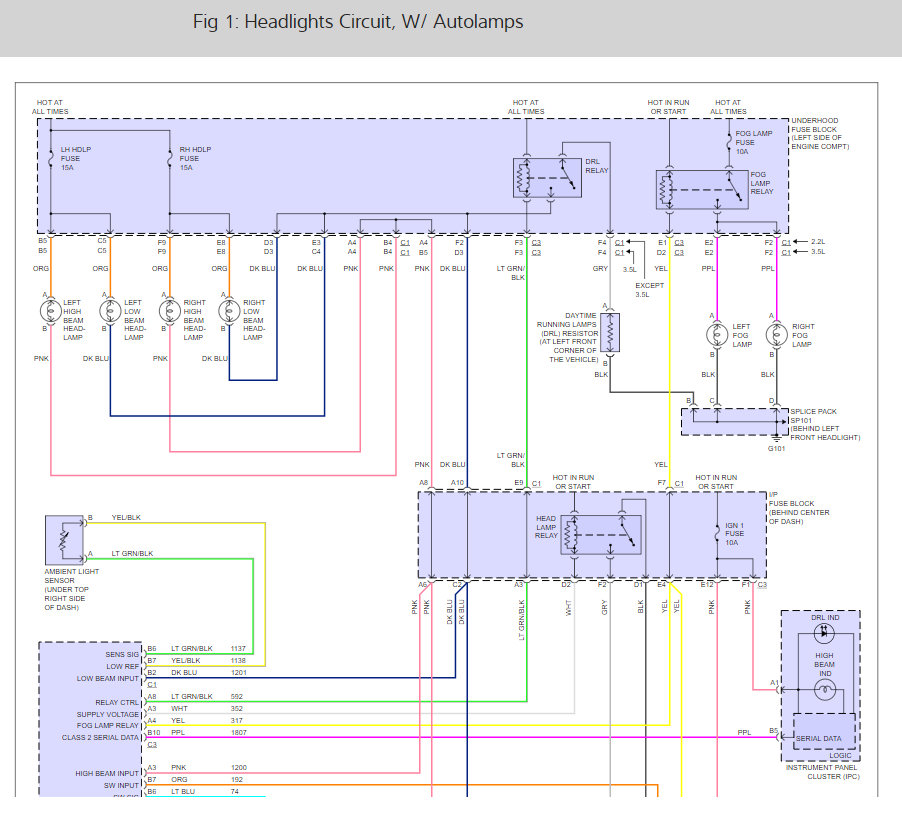

One day everything works fine. Then one day I have no day-driving lights or low beam headlights. Parking lights and high beam lights work fine. Fuses are good.
Oct 29, 2016 at 9:00 PM
SATURNTECH9
  • 30,869 POSTS

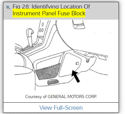

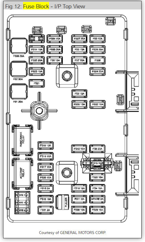

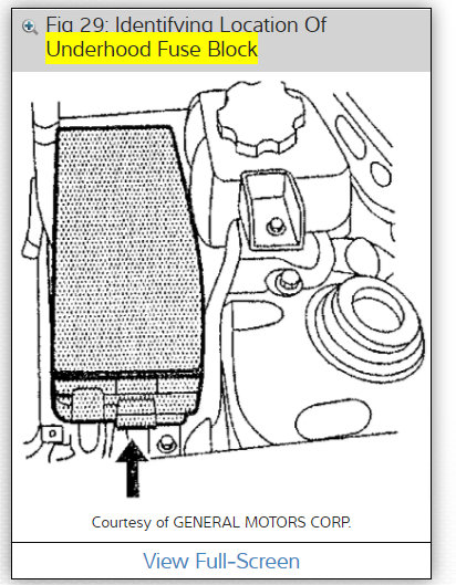

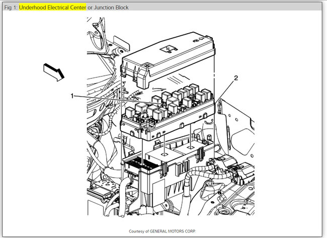

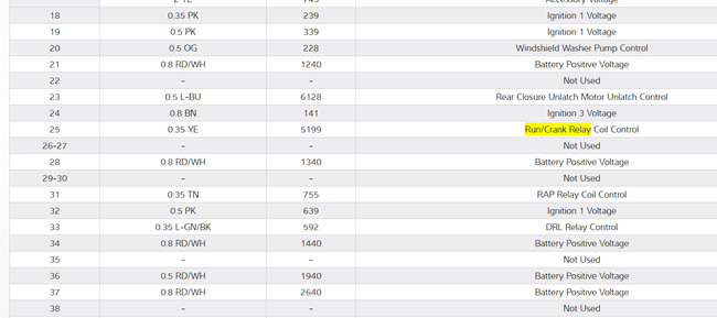

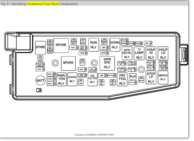

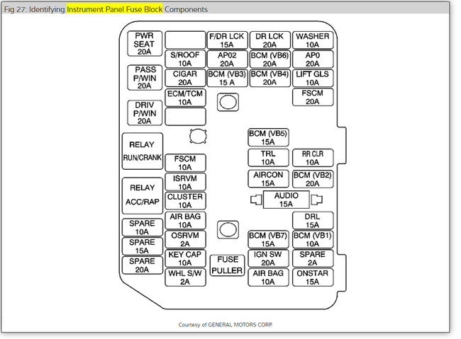

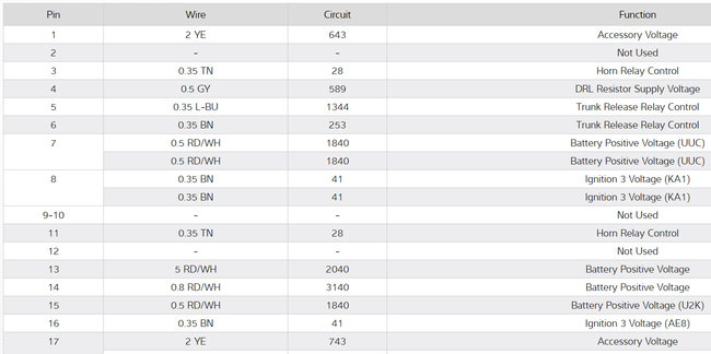

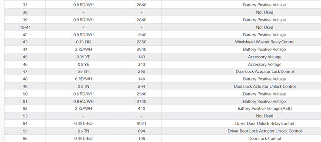

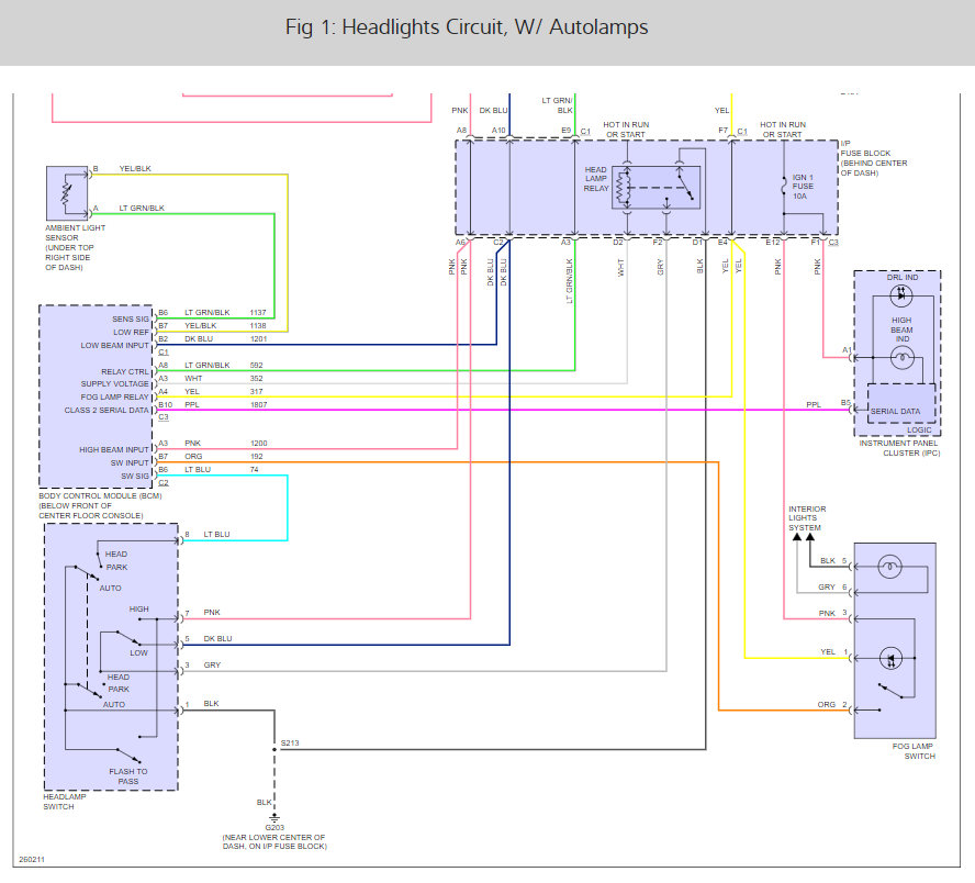

It sounds like you have a headlight relay that is not working. Here is a guide and wiring diagrams for the headlights so we can get it fixed.
Here is the headlight relay location and fuse identification. Check out the diagrams (Below). Please let us know what you find. We are interested to see what it is.
Cheers
Oct 30, 2016 at 10:43 AM
BILL COPES
Got it fixed it was the relay thanks for the diagrams this site is great! Thanks
