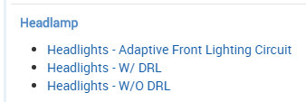

Removed all the under wheel stuff removed the socket from bulb put new bulb on socket before removing the old one and it still doesn’t turn on. replaced other side did the same process as I did with this one and the bulb turned on. any suggestions?

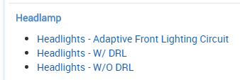

I would start by looking to see if you have a loose/burnt/corroded/defective ground wire for that bulb socket. I can send you a wiring diagram but need to know a little more about your car.Does it have conventional or Xenon headlamps? I've attached a picture below for further options on your car I need to know.Get back to me when you can and thanks for using 2CarPros.
