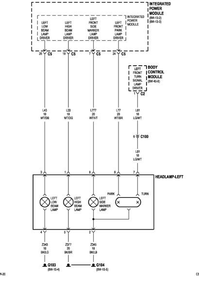

Low beam headlight will not come on driver side. Changed bulb still no low beam.
Sep 9, 2018 at 11:47 AM
Good afternoon.
Do you have a test light or voltmeter to do some checks?
I attached a wire diagram for you to view.
Sep 9, 2018 at 11:52 AM
ROYCE2PRAY
Where is this model located?
Sep 9, 2018 at 11:59 AM
The TIPM is the fuse box. It is an actual module that controls many functions.
Check for power to the wire that feeds the headlight. If there is no power, you need to check it at the TIPM. If there is power then it could be the ground or a bad new bulb.
