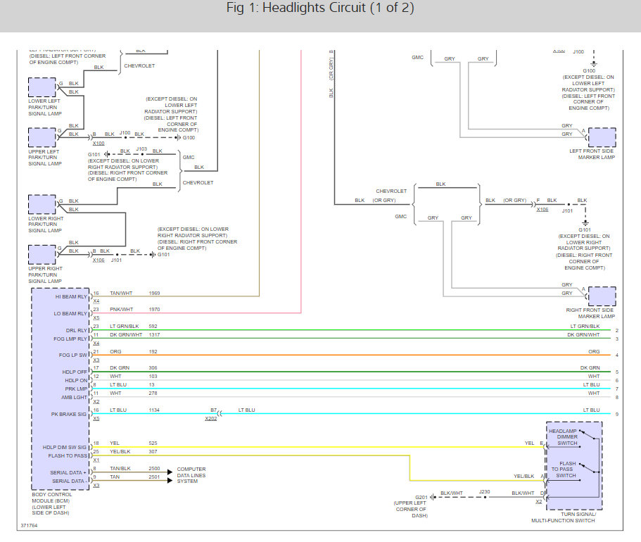

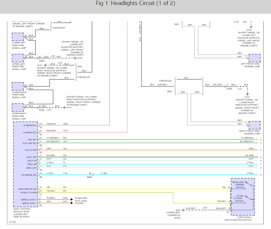

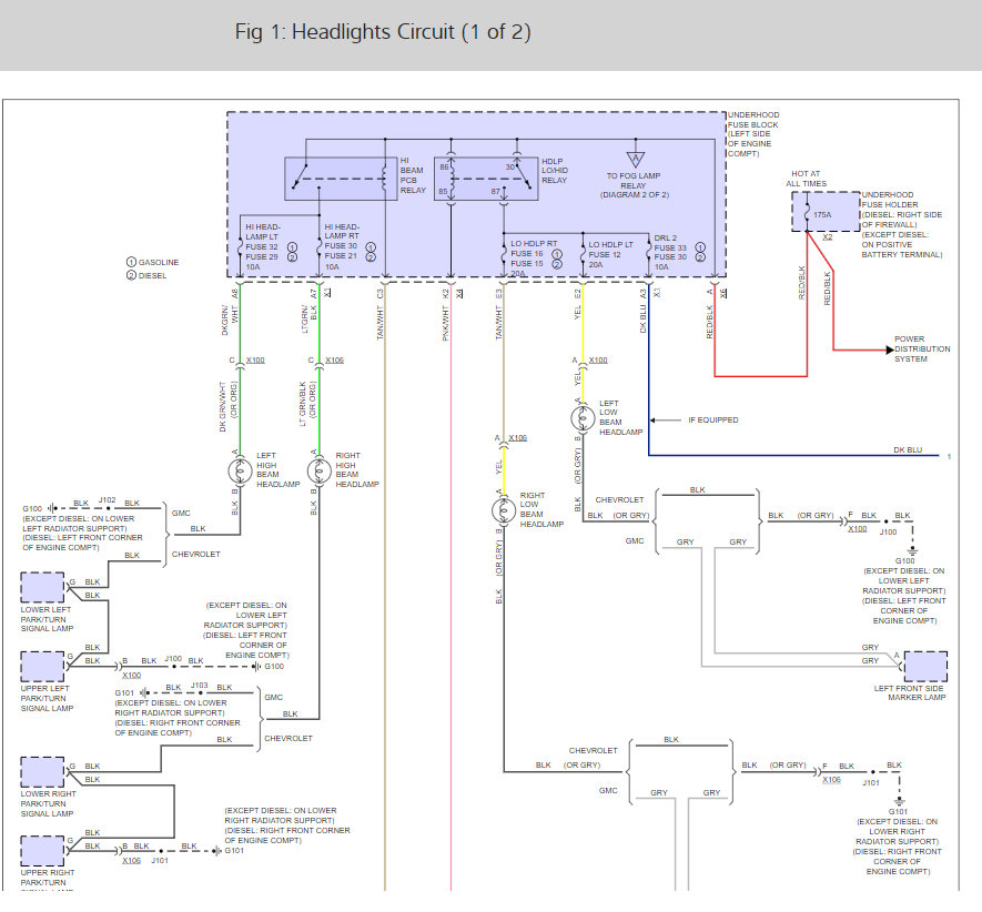

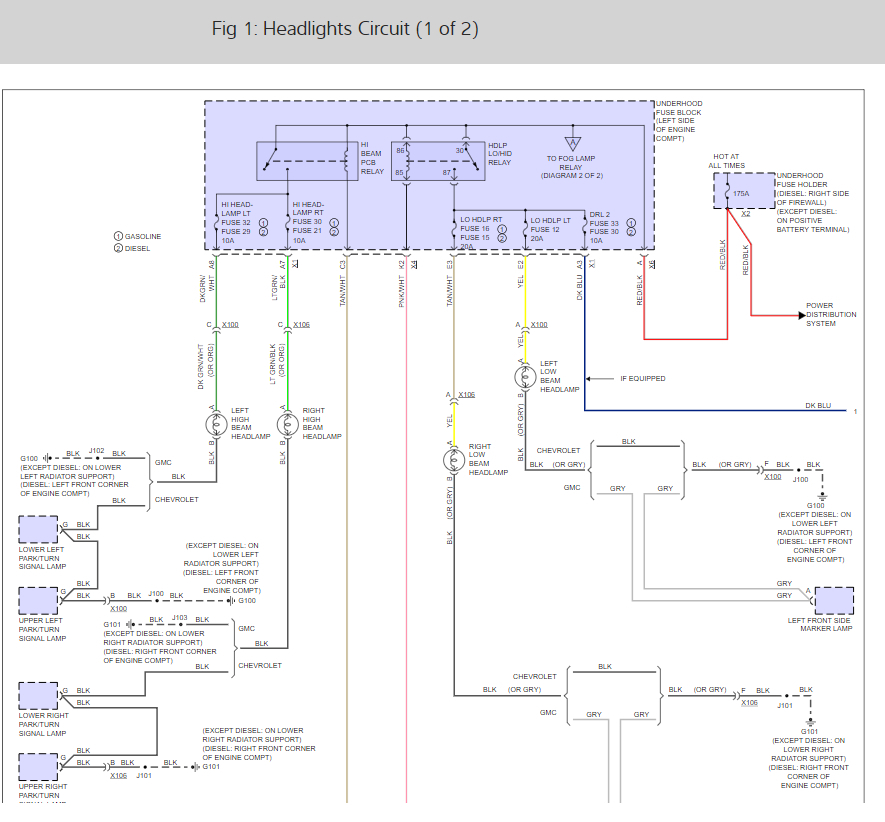

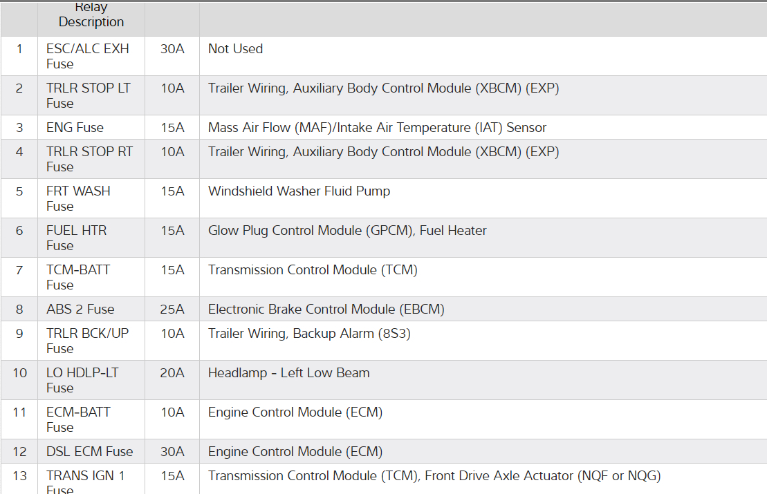

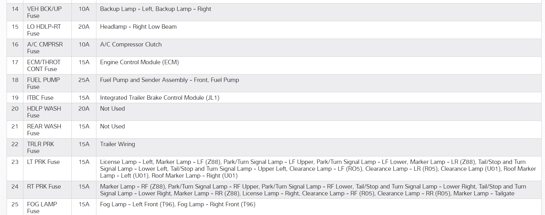

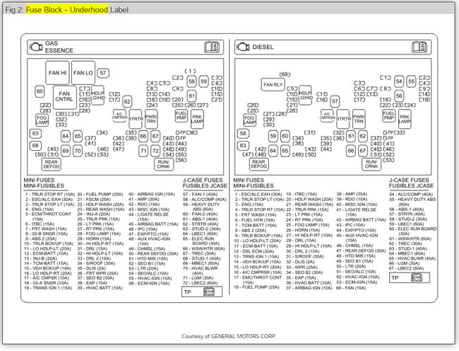

The low beam on the drivers side of my truck are not working. I replaced the bulb and it still does not work. All other lights work (parking lights etc.,). Any thoughts on what the problem is?
Sep 28, 2015 at 6:56 PM
CAR-MAN145
  • 321 POSTS

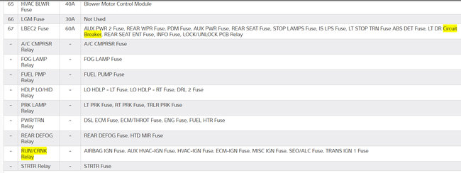

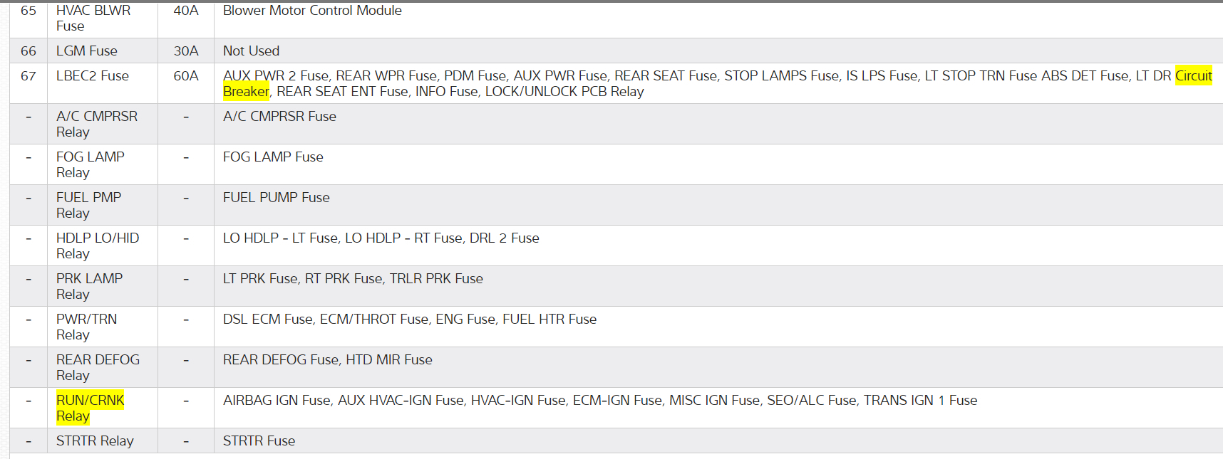

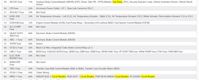

Fuse 16 in left side engine compartment fuse box powers the right side head light low beam. Here is a guide to help you check the fuse location and the headlight wiring diagrams to help you see how the system works:
and
Cheers

Thank you, it was the fuse. I love this site.
