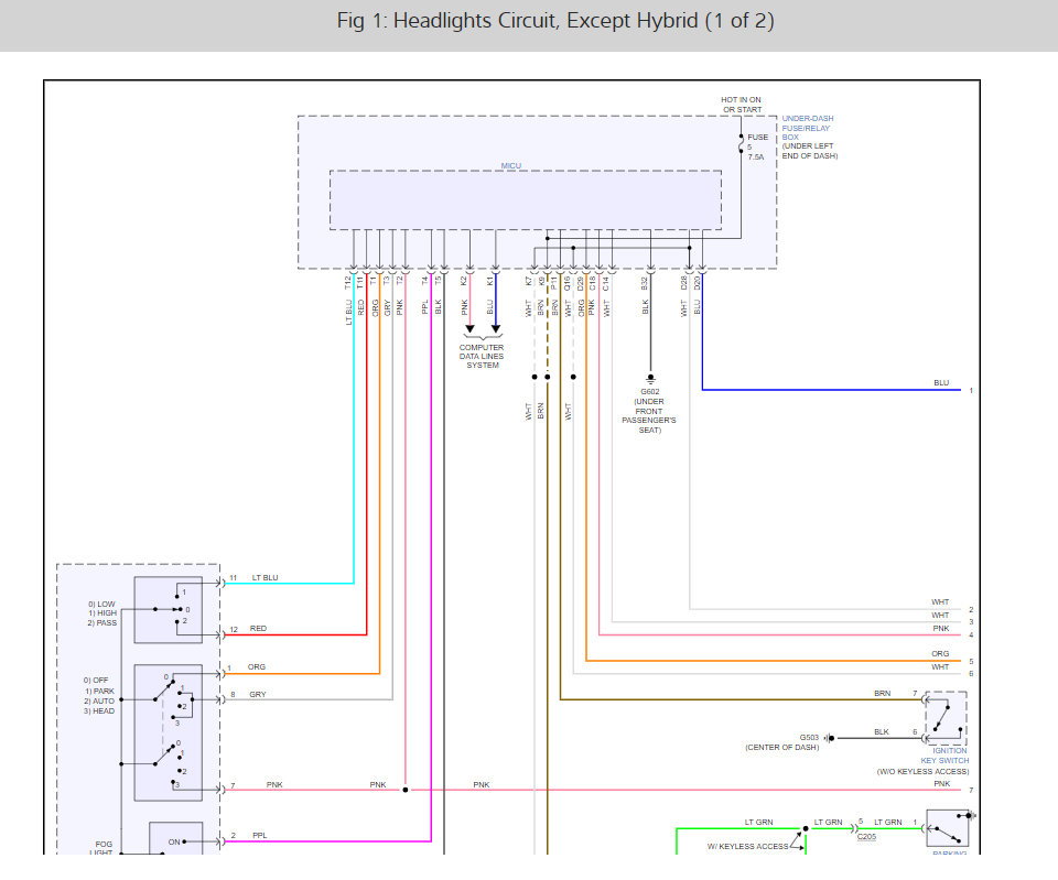

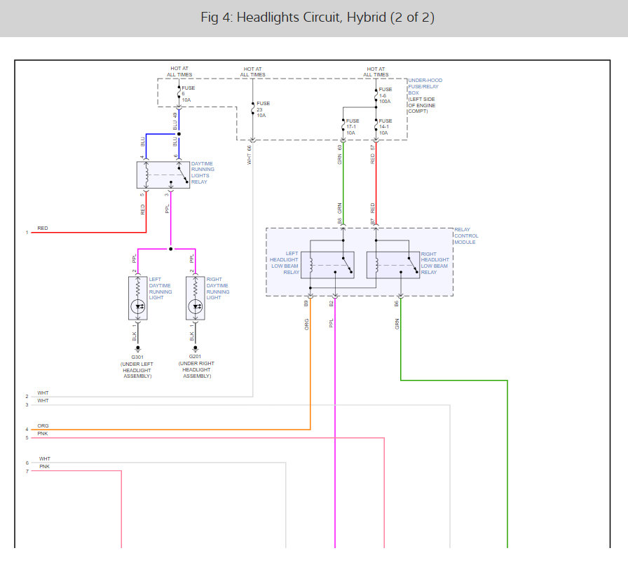

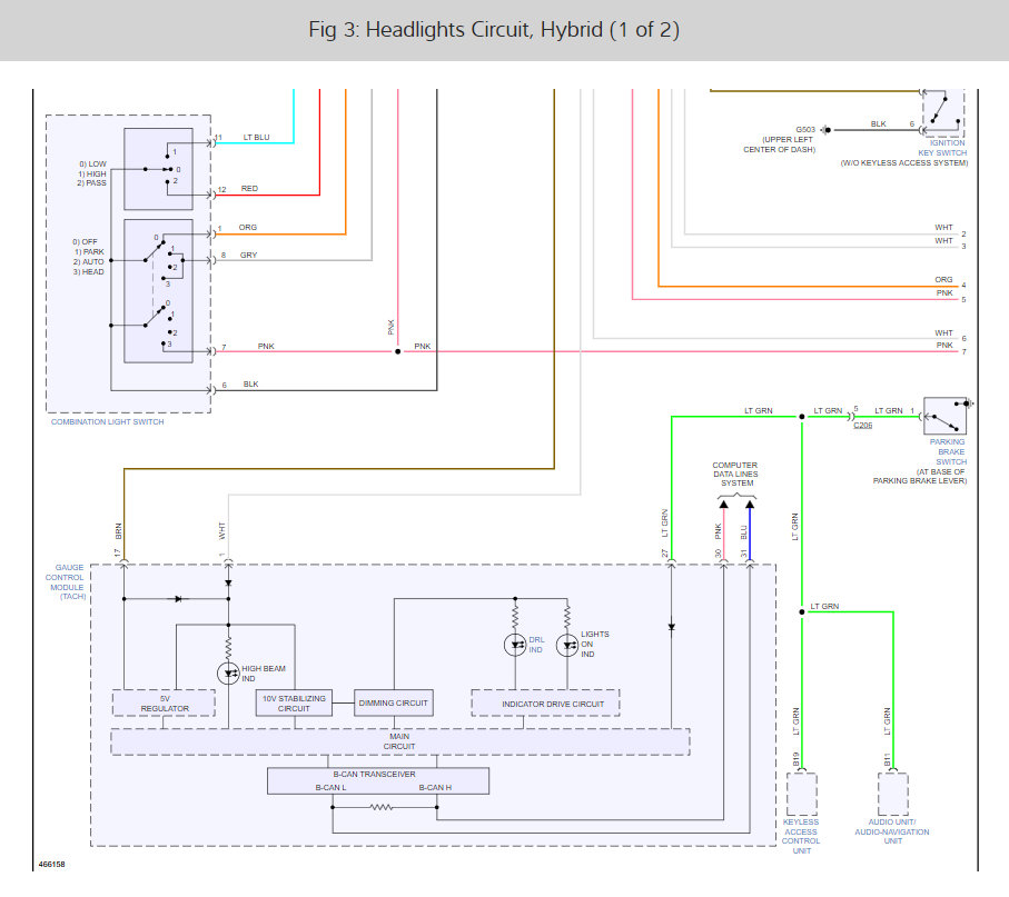

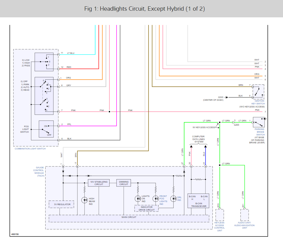

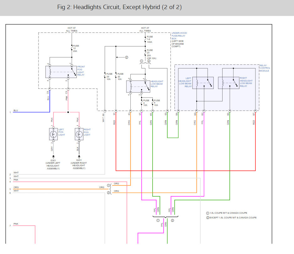

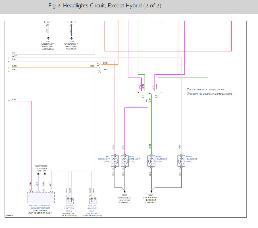

I scratched a new low beam halogen bulb on my car listed above SE, while installing it. Should I replace it? I think it might have messed up because the headlight stopped working I need to wiring diagrams so I can see how the system works?
Aug 29, 2020 at 4:04 AM
DANNY L
  • 5,648 POSTS
Hello, I'm Danny.

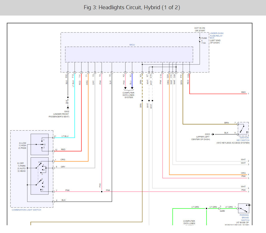

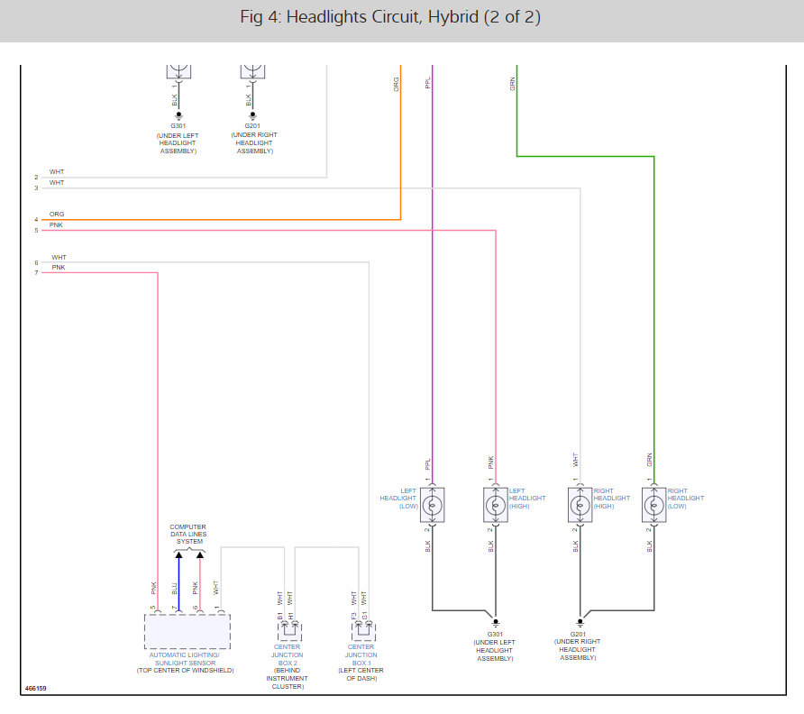

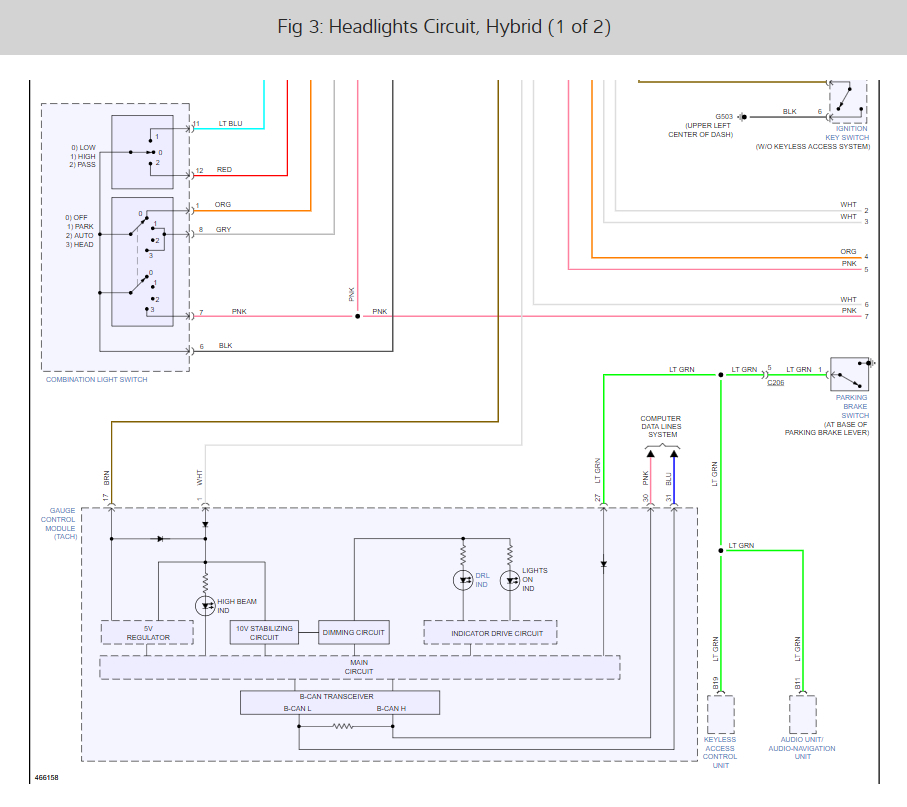

Here is a guide to help check the wiring connections with the headlight wiring diagrams for both hybrid and non hybrid models below.
