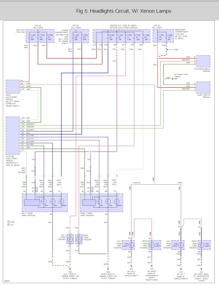

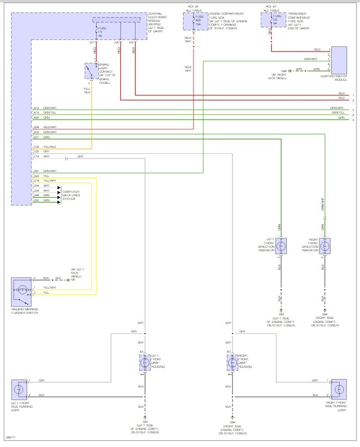

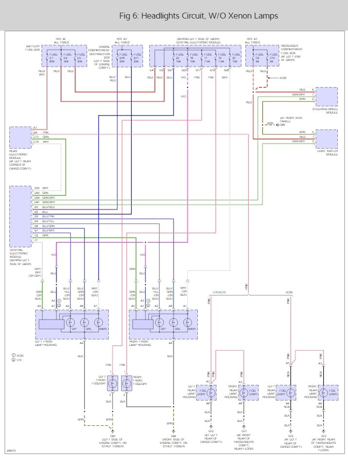

The low beams will not work. The daytime running lights work, as do the high beams. We have tested, via a voltmeter, and found that from the CEM the low beam pins B4 and B7 are not reading the 12 volts that the high beams do when turned on. Is this a relay problem? Any suggestions are greatly appreciated!

Hi Trey,
You will need to test the fuses of course.
here is a link to do that
here are some wiring diagrams which include xeon and non xeon systems
It could be the switch or the module behind the dash
Let me know how it goes
