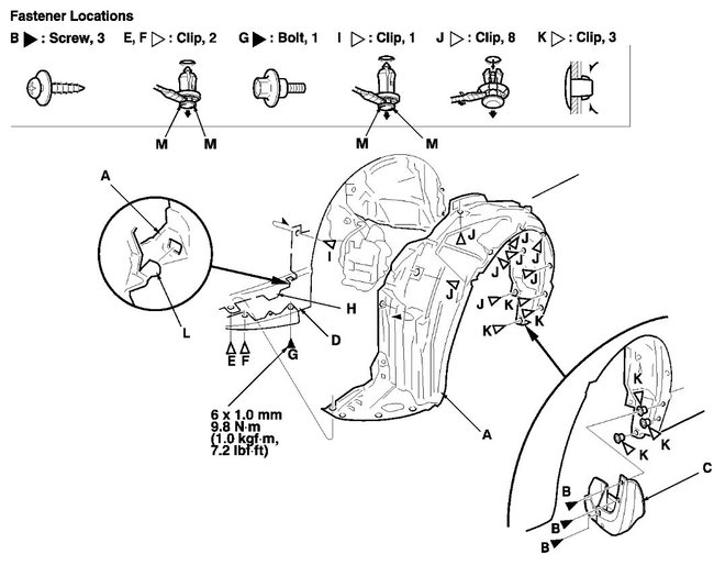

Headlight bulb replacement Instructions please?
2009 HONDA CIVIC
89,000 MILES • 1.8L • 4 CYL
JBFG11
How to replace low beam easy way?
Oct 20, 2019 at 10:39 AM
STEVE W.
  • 15,349 POSTS
Welcome to 2CarPros. On both the 2 door and 4 door the first step is to remove the fender liner. That gives you easy access to the bulbs. Be sure to change both low beam bulbs so that you have even lighting and an even current draw in the system. I would also change the high beams while you are doing the job.
