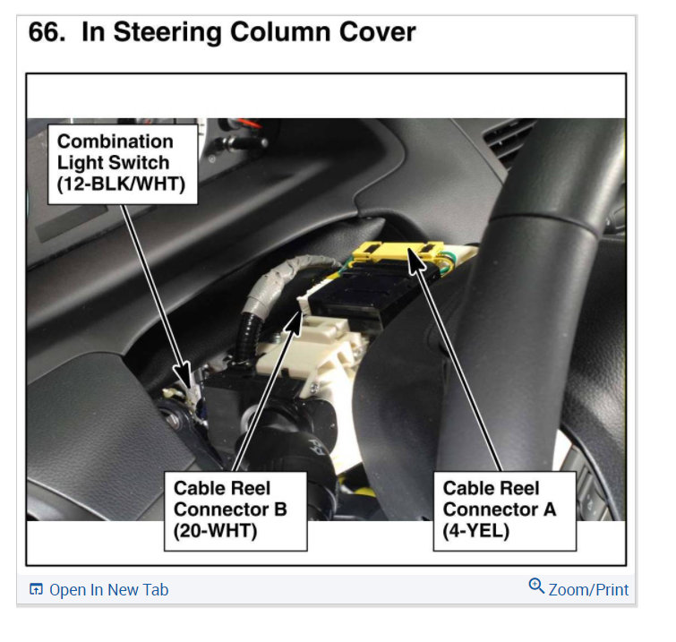

At times when I go to turn my low beams on at night they do not turn on. When I go to try to fix the low beam all it takes is a little jiggle on the headlight switch for both low beams to turn on. I noticed this happening after I changed them. If not the fuses, what else can be the problem?
Sep 25, 2019 at 1:10 PM
94 TRANSAM
  • 680 POSTS

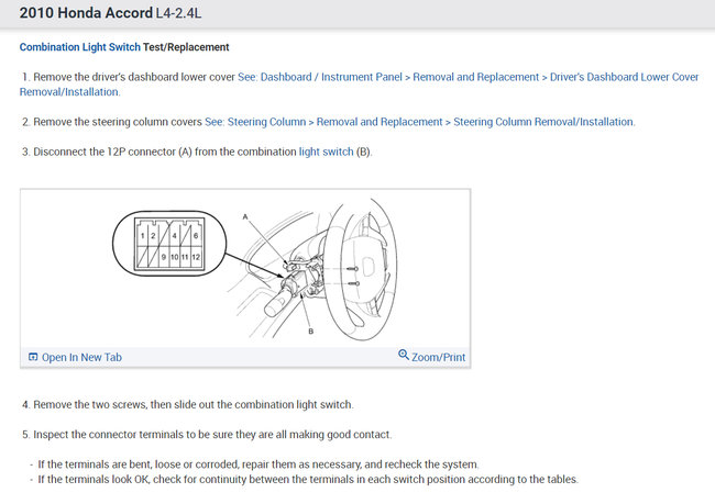

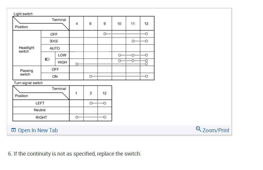

It sounds like you have a bad connection at the headlight switch which is common you need to replace the switch here is how in the diagrams below. Check out the diagrams (Below). Please let us know if you need anything else to get the problem fixed.
