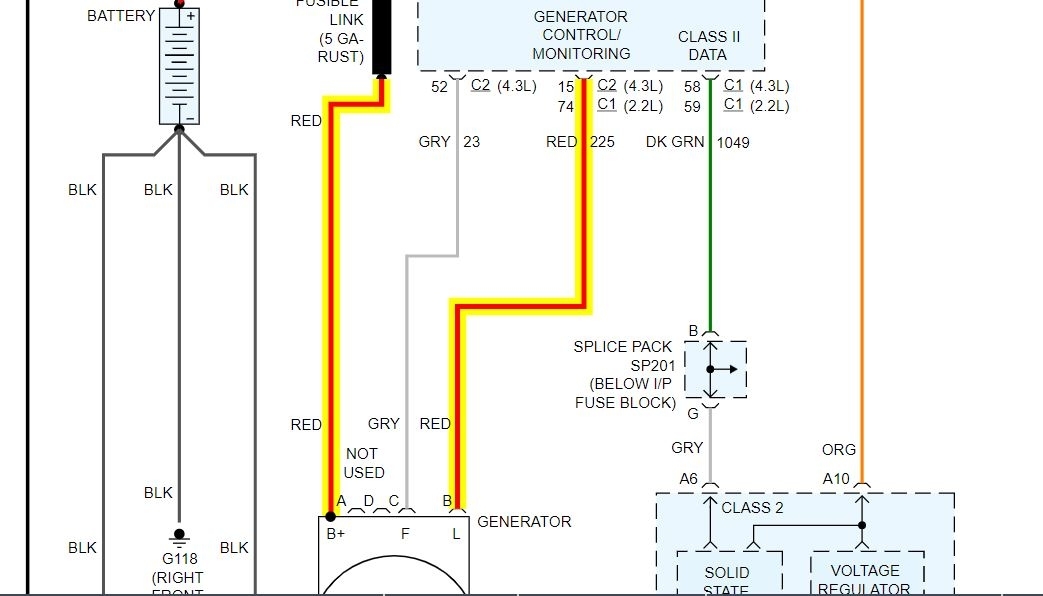

After replacing the electrical ignition switch I now have a low battery light staying on when key is removed from the ignition. Light goes off while driving and idling. I've tested the alternator output and it was reading 14.6 volts. Not sure where to start diagnosing this problem.

Do you mean the battery light is on?
Check the 2 red wires in the diagram for power with the key off.

Okay, did you test the 2 wires I highlighted in the diagram?

Tested the wires highlighted showing 12v on b+ and nothing on the L wire.
Dec 4, 2019 at 5:53 AM
Okay, start the truck and see if it is hot. Turn on the headlights when testing.

Okay, most likely the alternator has a bad diode inside turning on the light with it off. If you remove the cable that attaches from the battery, the light should go out.

I disconnected the main cable going to the alternator the noise stopped and the light went out. This told me the alternator was back feeding the light after the engine was off. So I replaced the alternator wired every thing up connected the battery and viola the same noise from.the new alternator and the low charge light is back on as well as the odometer stays on and the shift indicator. I'm still leaning towards something in the aftermarket radio might be to blame or in the ignition switch connector as changing that and the lock cylinder housing is what started this in the first place.
Dec 5, 2019 at 11:30 AM
Okay, the alternator is being commanded full field by the PCM. That is what the whining noise is. The L terminal is a pulse width signal from the PCM. Looks like you need a PCM.

Just finished replacing the PCM with one I found online I just had to send the VIN in to get it programmed right. Plugged it in attached the battery cables did the pass-lock relearn procedure and she fired right up. No more lights on the dash and it actually seems to run better. Thanks for all of your help.
