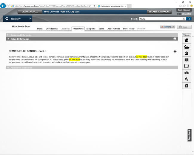

While air flow is normal from side, foot and defrost air vents, very little flow comes from the two center vents (but some faint air flow is noted). Same problem with heater and air conditioning. The control knob will correctly divert air to the foot and defrost vents, but makes no difference regarding the airflow from the center dash vents. The control cable appears to be working normally (no slippage or binding throughout the full range). Am considering replacing the filters, but everything I have read so far seems to indicate that if the filters are blocked, air flow should be affected through all the vents, not just the two center dash vents. the two center dash vents appear isolated from each other, but must have a common duct somewhere, and I suspect around that point may have a common louver or flap, but I can't locate a schematic to know for sure. Am concerned about removing the dash because of the passenger side air bag is in the top of the dash. Please advise how I might correct this problem myself (am retired on low income). Your help is very much appreciated. The car is a 1999 Chevy Prizm, manual transmission, 4 cylinder, 5-speed, with heating and air conditioning. Thank you!

Here is the procedure for getting at the airbox.

Thanks for the procedure regarding the Temperature Control Cable, but I am unable to read the small picture of your reply. I have tried copying to Microsoft Word, and even Paint in attempts to enlarge the print enough to read, but only get a blur. I even tried magnifying lenses, but only vaguely make out a word or two. Could you possibly reply with just straight text, please. I really would appreciate knowing what you sent. Any help would be very welcome. Thank you.
