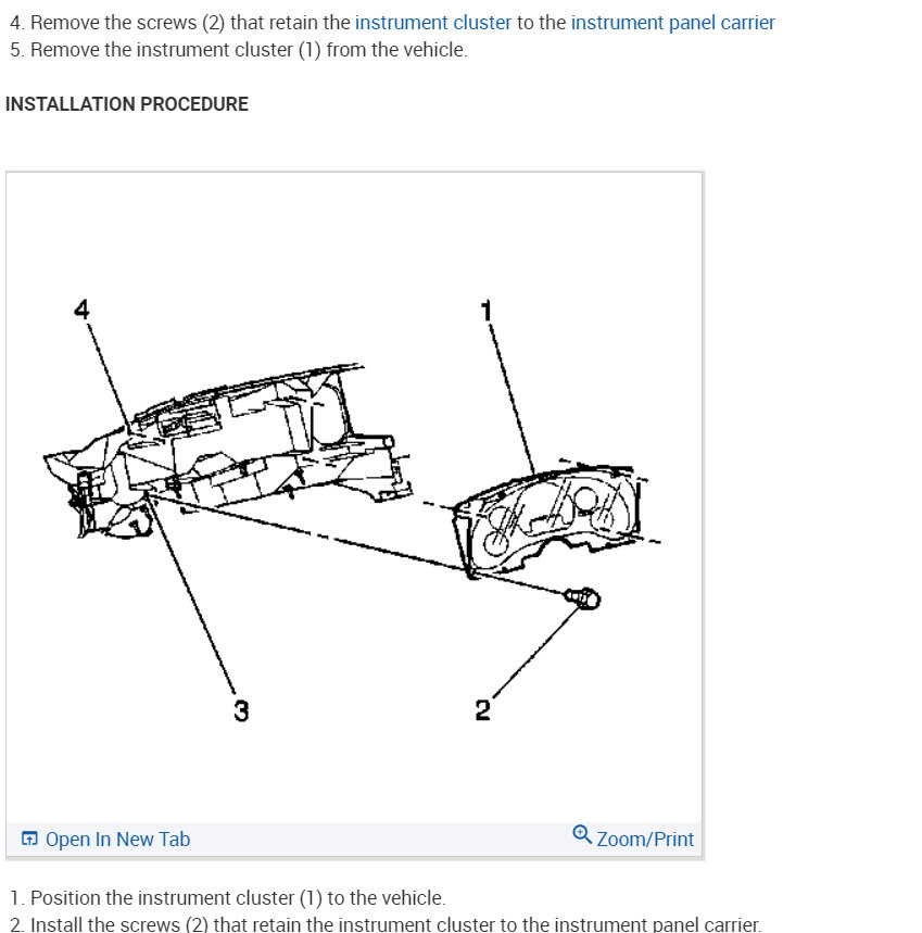

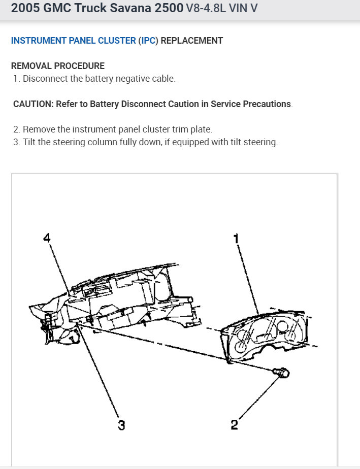

The fact that smoke is coming from the instrument cluster I would disconnect the battery and replace the cluster and install a rebuilt unit which you can get by searching Google or eBay. Here is a video of the job being done on a similar car with instructions in the images below for your car. Also, you should run the codes by doing a CAN scan which is easy check out this guide:
and
https://youtu.be/_HEC44xENxw
Check out the images (below). Let us know what happens and please upload pictures or videos of the problem.
