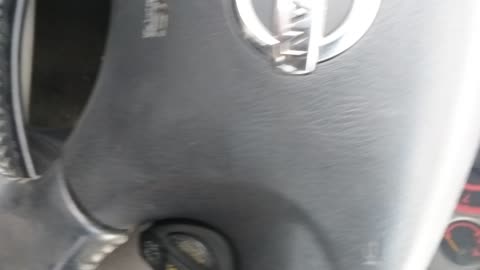

car won't start and no dash lights come on but when i try to start it, i get a loud whirring sound almost like the starter not making contact. However, turning the key to the accessory position will make the loud click from the starter. Turning the headlights on only turns the parking lights on and no "ding" from doors open/ key in the ignition.

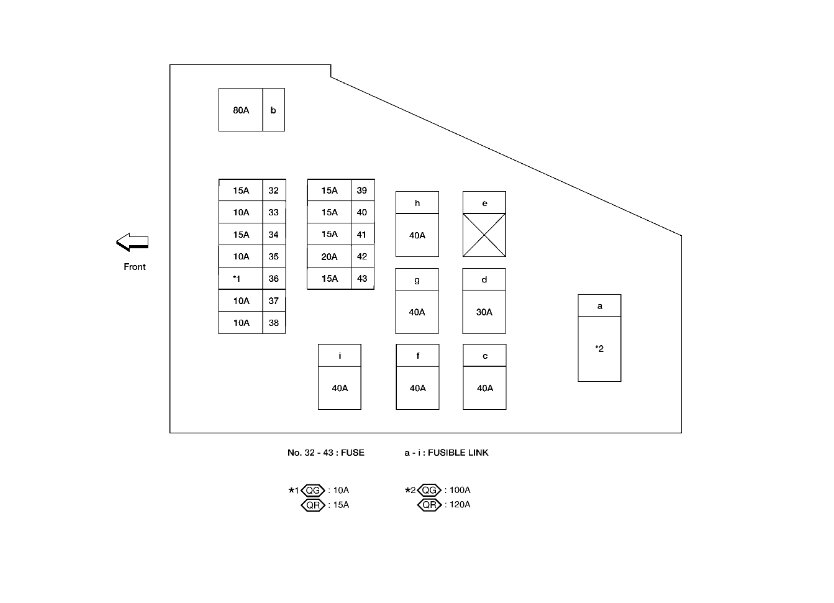

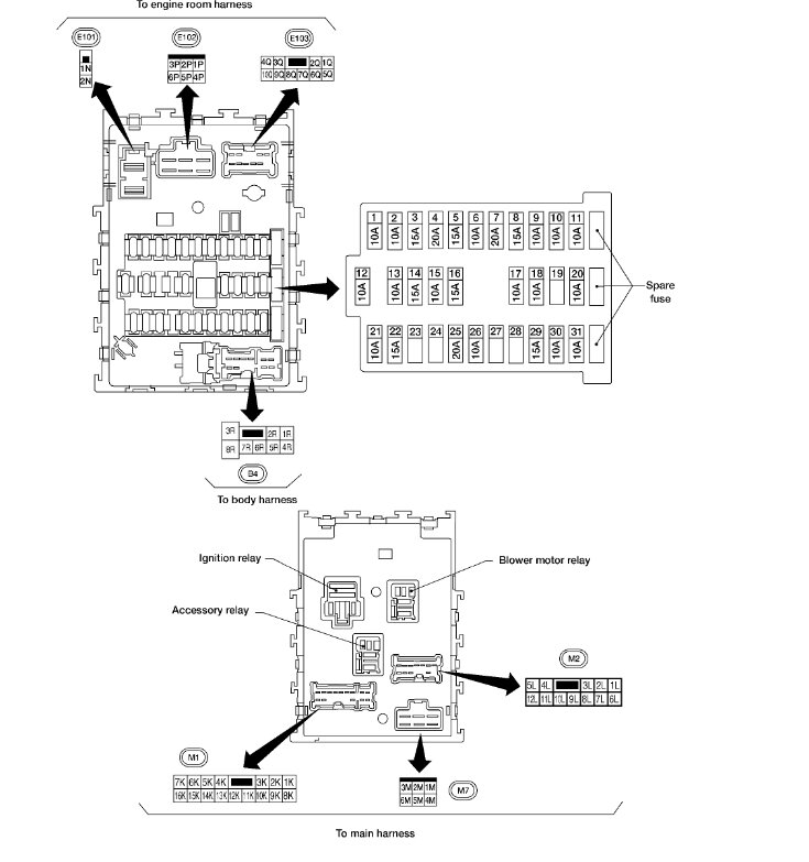

Let's check the main fuses here is a guide to help and the fuse panel identifications in the images below. Please check the large fusible as well.
