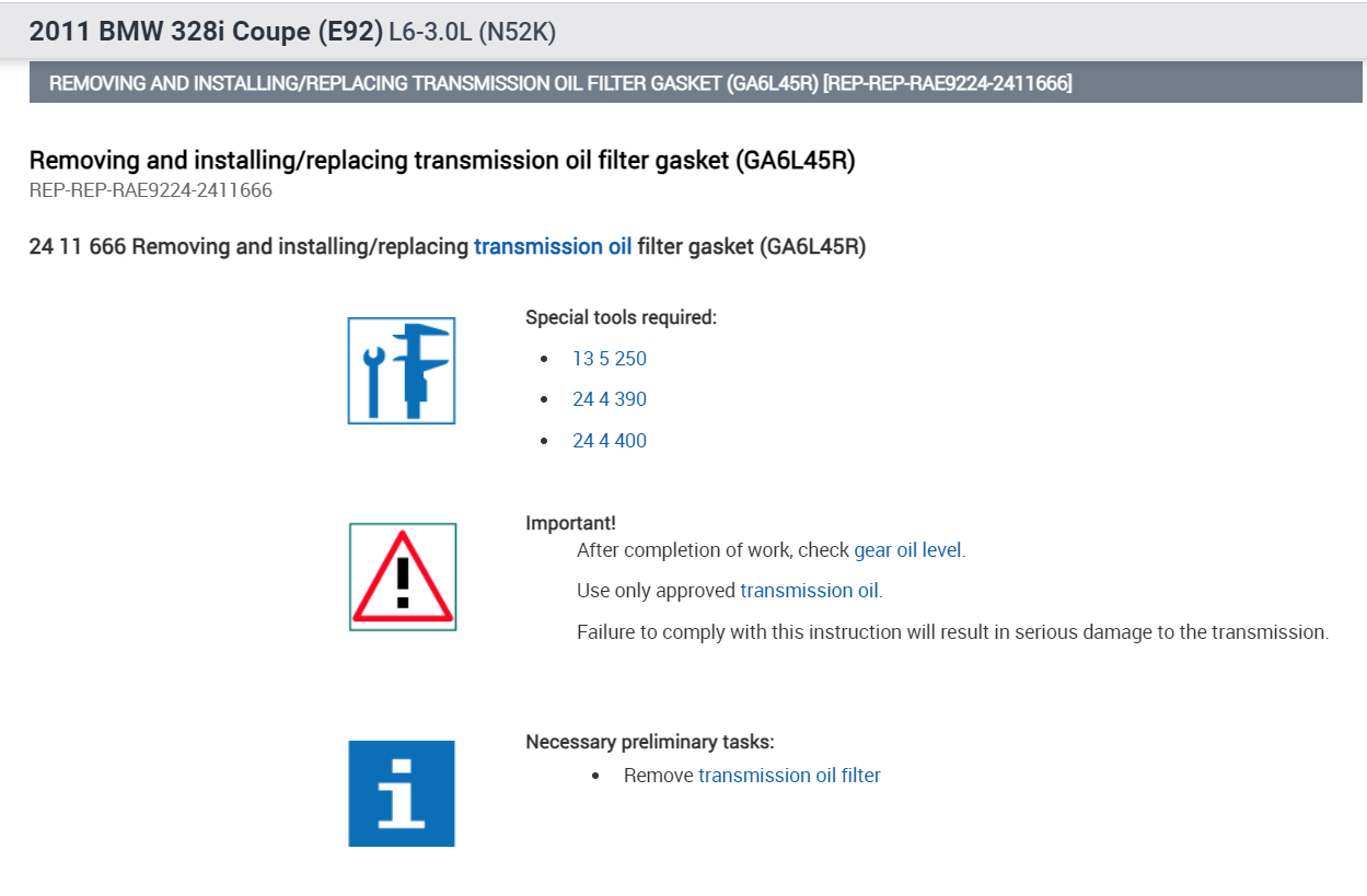

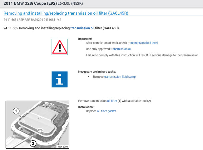

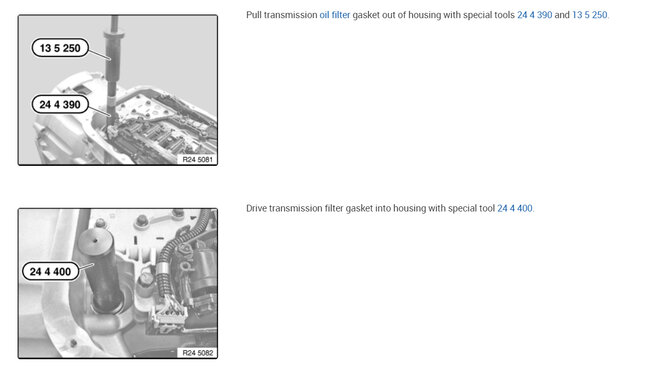

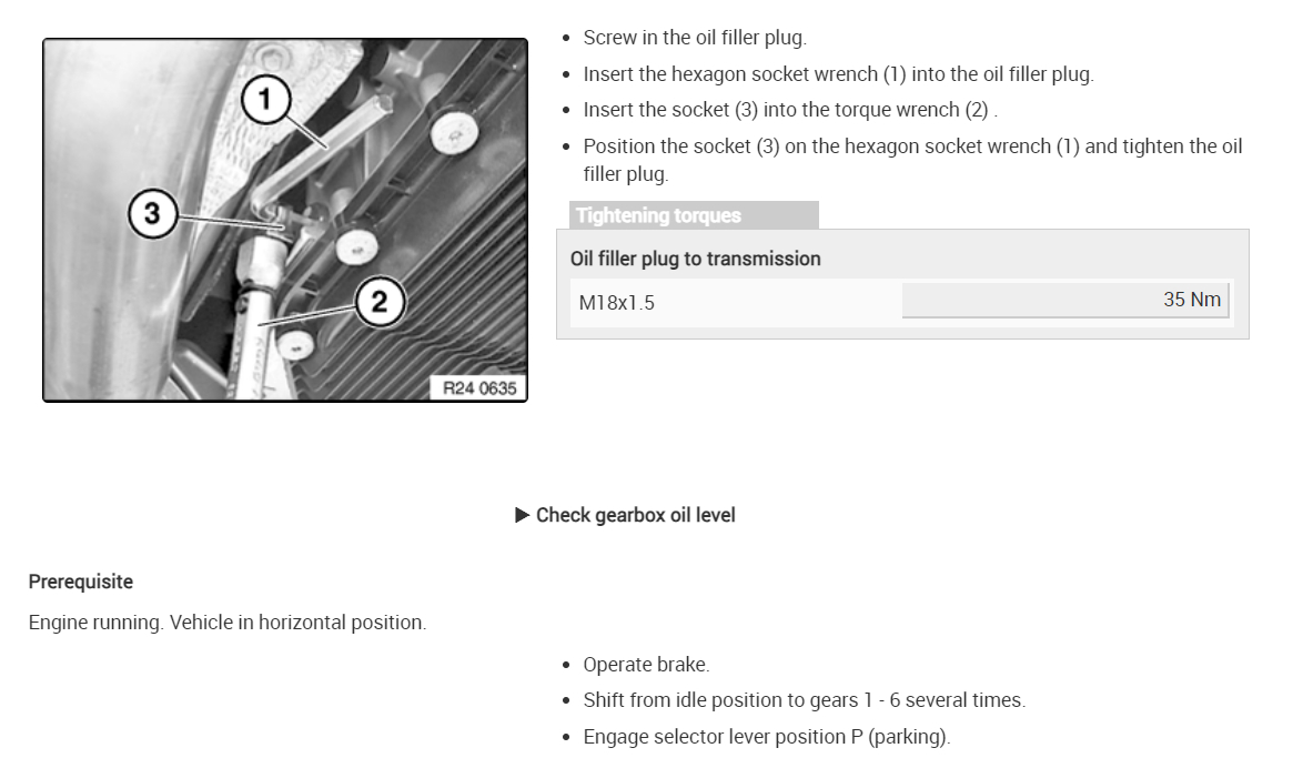

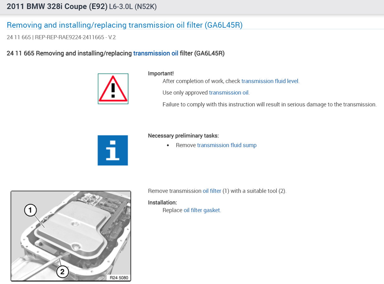

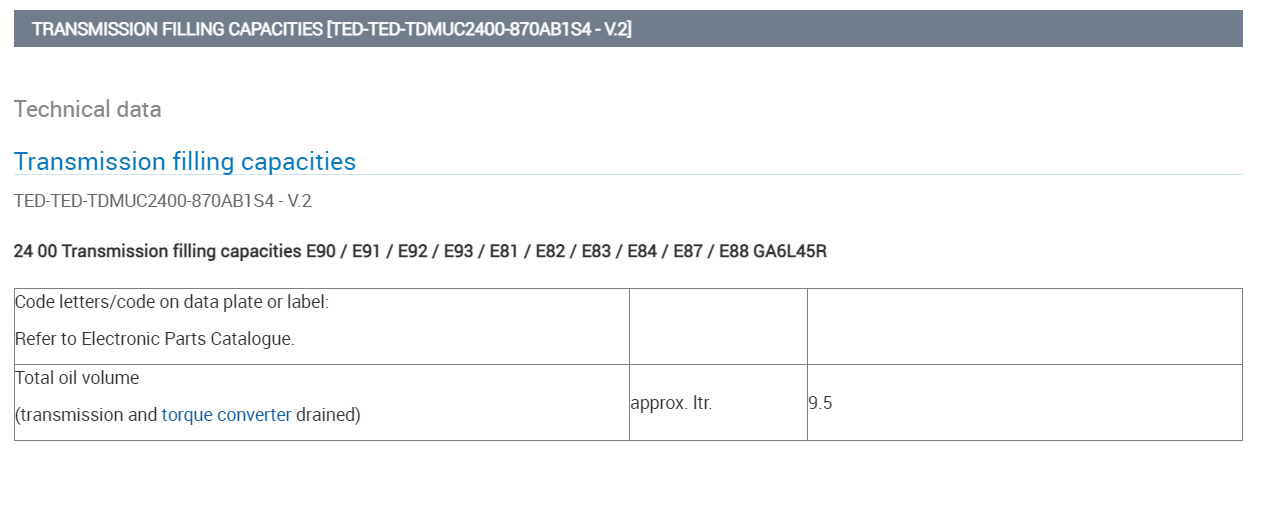

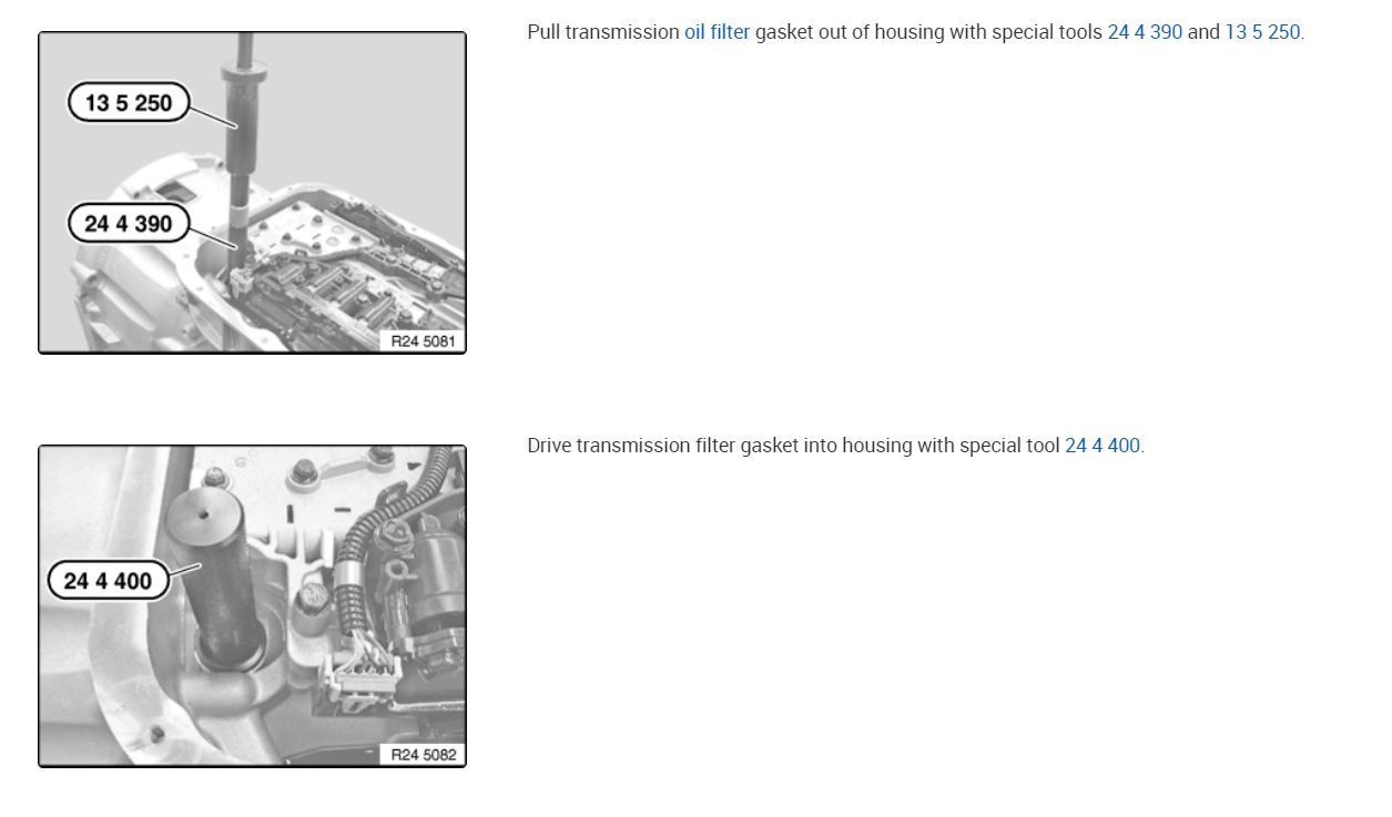

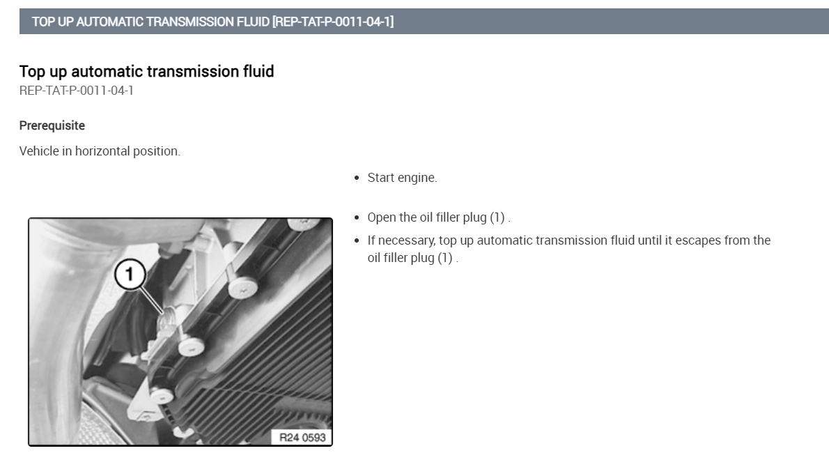

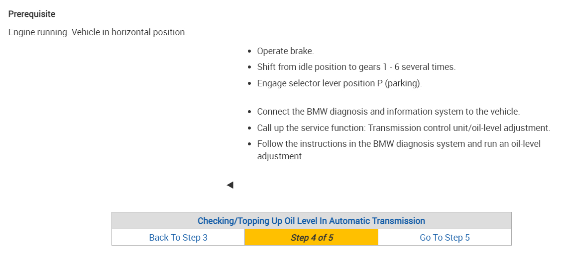

Thanks for the video, it helps. It sounds like the transmission filter is clogged up which can make the noise in the video and the erratic shift patterns. I would drop the transmission pan and change the filter out here is how the job is done in the images below and I have included a guide to help walk you through the steps.
