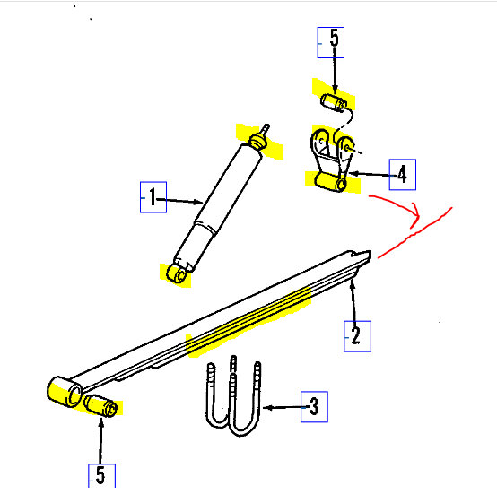

when going over bumps big and small i have this loud metallic sound like a bag of washers or loose linkage sound. i replaced sway bar bushings and end links i thought maybe the front half shaft was not disengaged fully. Also, the boot was ripped so changed half shaft i checked heat shields front brake calipers. Sound does not abate when applying brakes. I have been working on this for 2 weeks. So, today while my wife drove i rode in the back and it sounded as i described like loose linkage or bag of washers and from where i was riding it sounded like it was coming from the area between cab and bed. it's like a (chincky chink sound only when going over bumps sounds like something is really loose down there its very loud now... thank you

Is anything loose on the exhaust or fuel tank? There isn't too much in that area. If you take a rubber mallet and tap on things, can you reproduce the sound?
Also, if it is loud enough to record with your phone, could you record and upload it for me to hear?
In the interim, check to make sure there are no issues with the leaf springs (cracked) or the shackles where the springs mount. Check to make sure you don't have a failed shock or shock mount. See pic below
See pic below.

It was a dang shock bolt!!!
