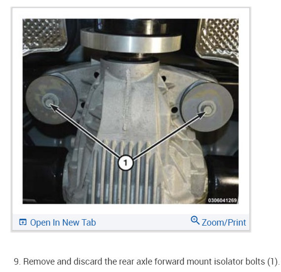

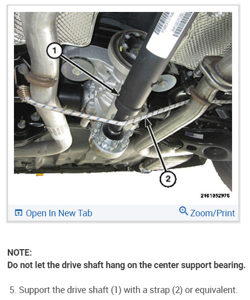

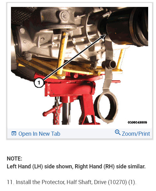

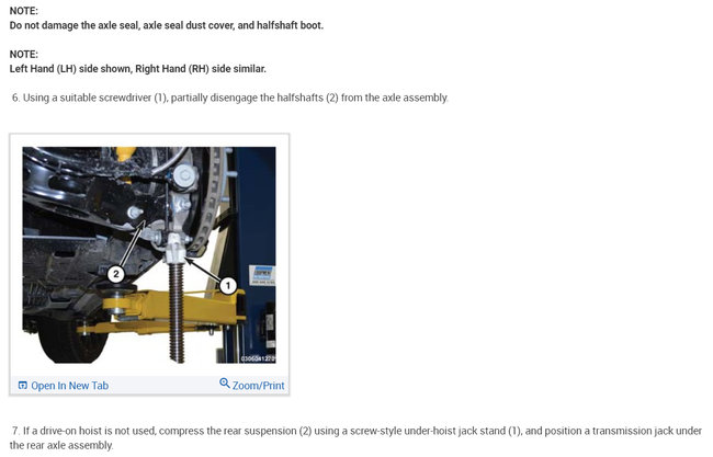

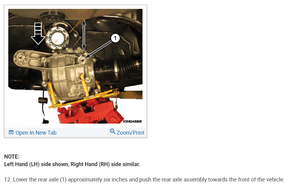

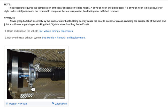

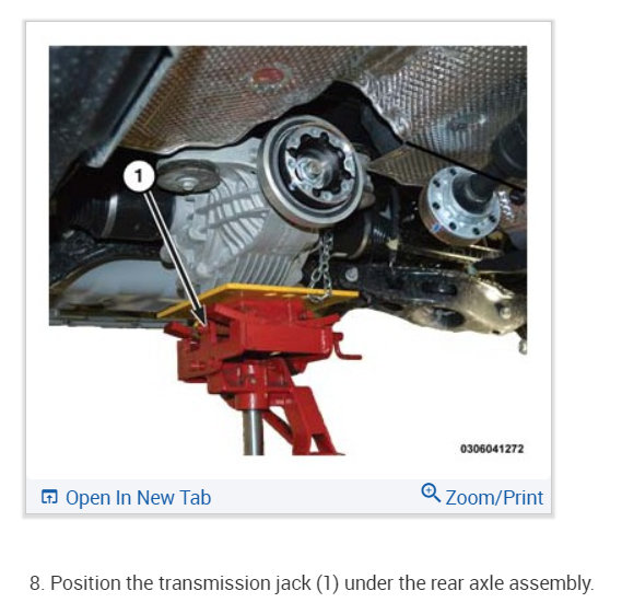

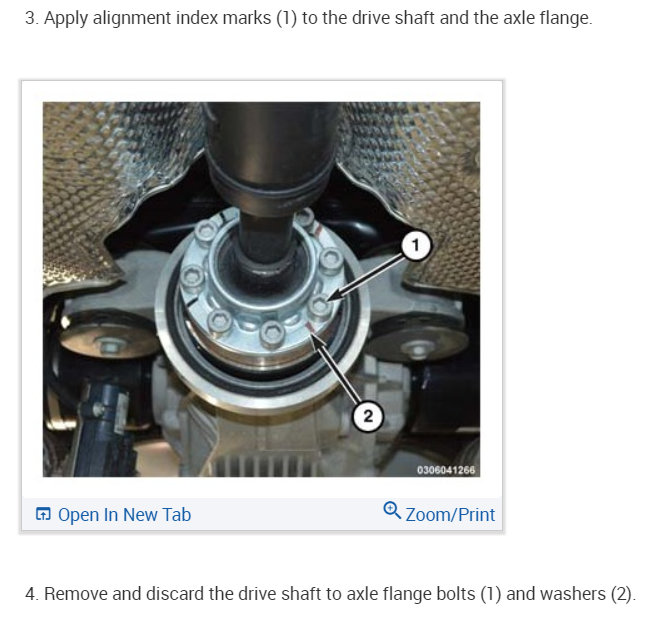

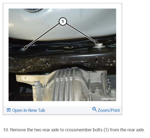

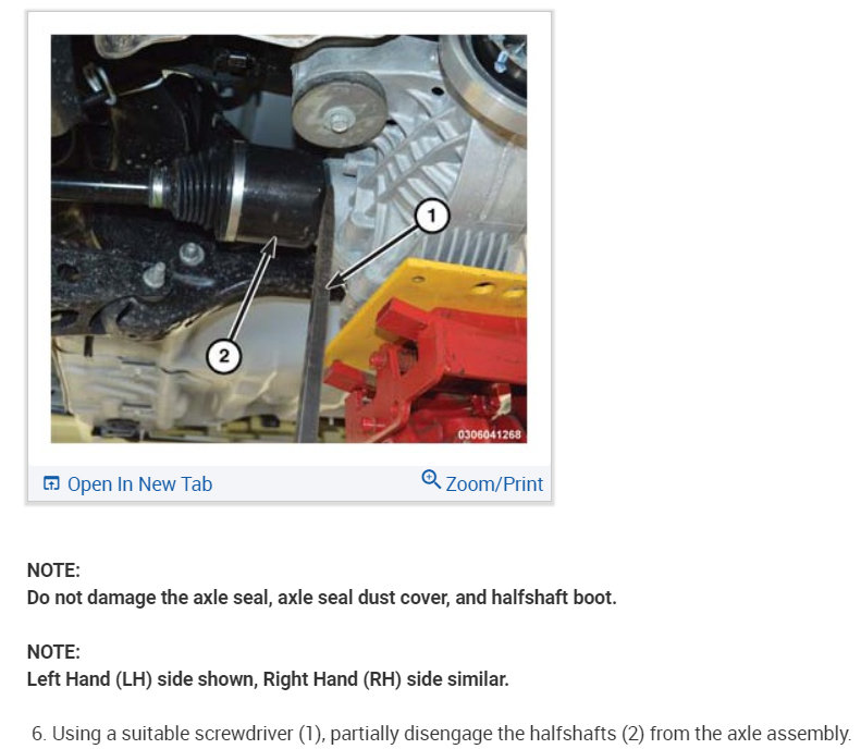

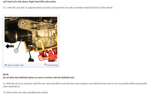

It does sounds like the rear differential is having an issue. Can you please shoot a quick video with your phone so we can hear the noise? That would be great. You can upload it here with your response.
If it is the differential here are guides to help you remove it and how to check the driveshaft coupler (make sure there is no play).
Check the fluid condition of the unit as well you can use the fill or drain plug to take a sample.
