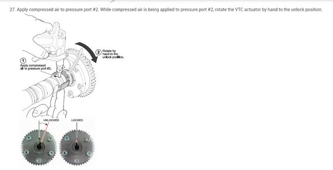

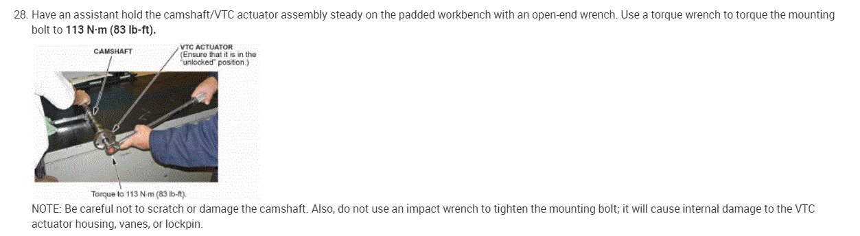

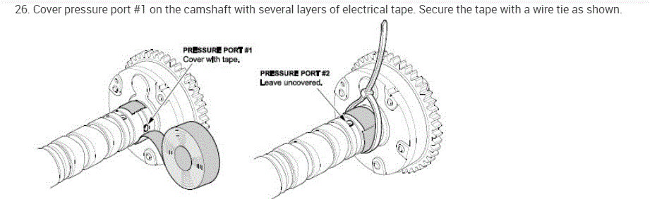

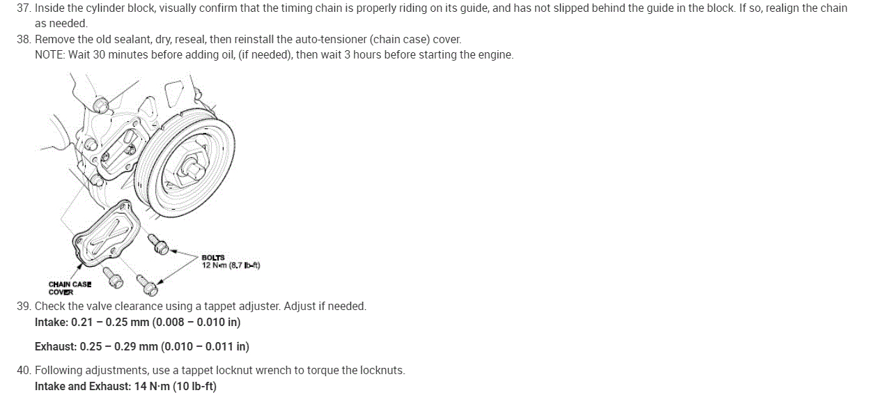

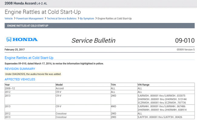

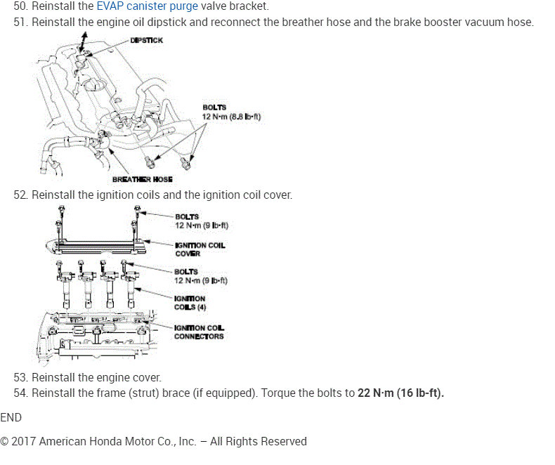

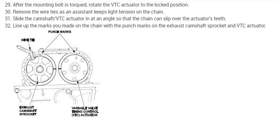

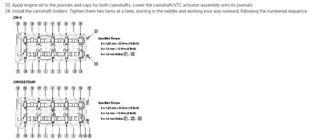

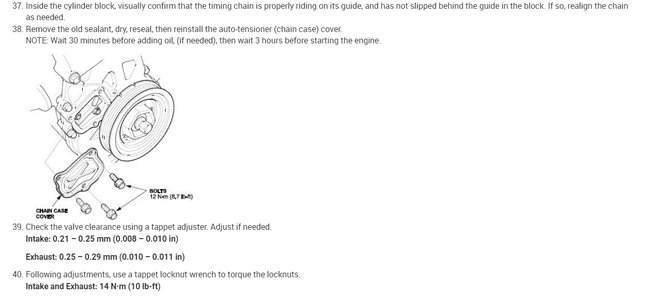

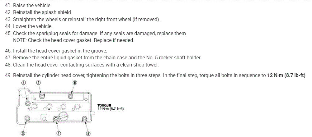

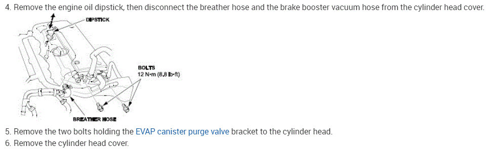

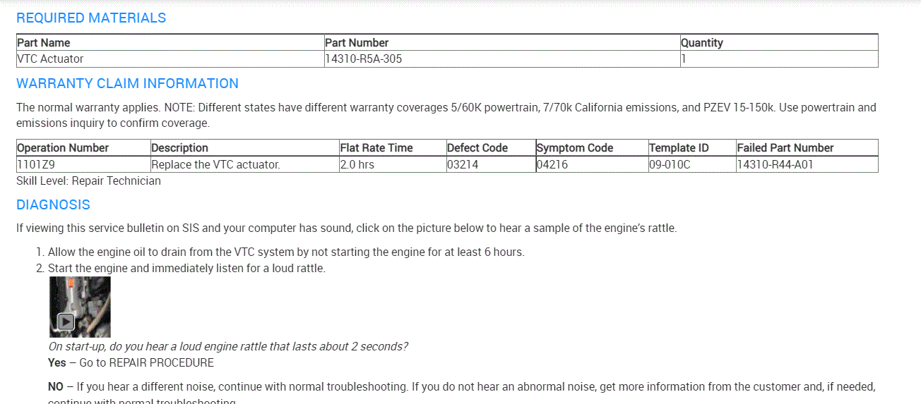

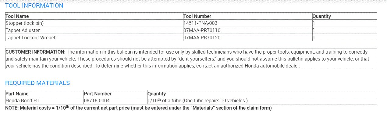

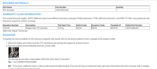

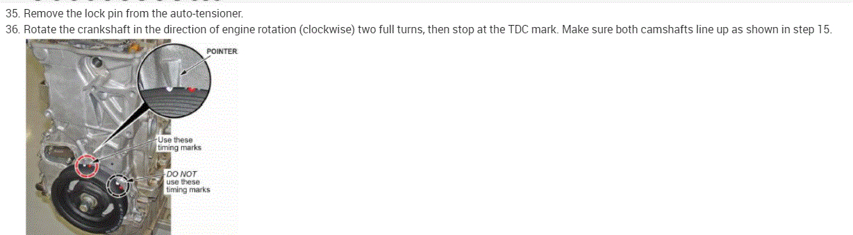

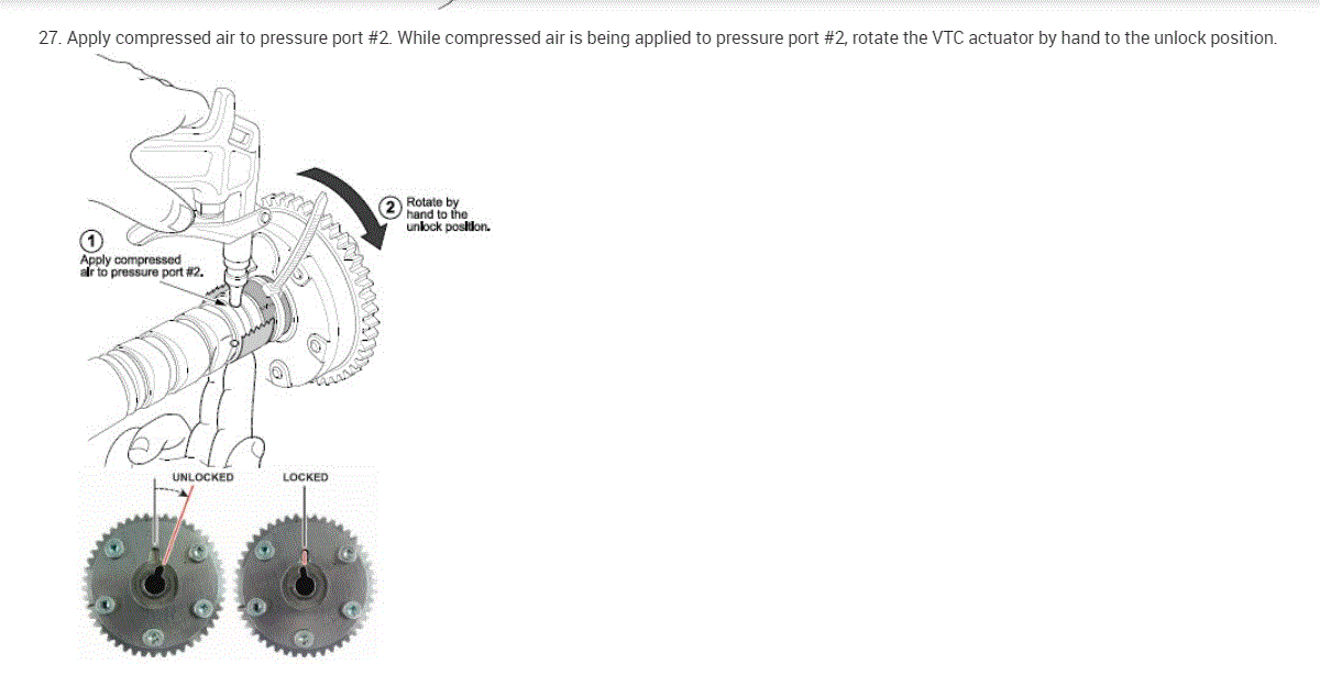

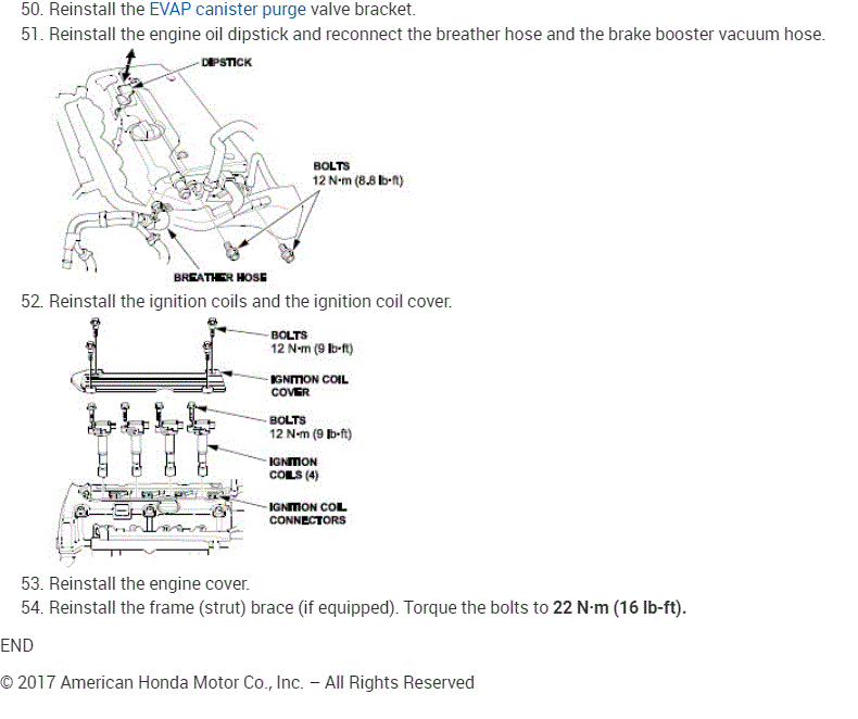

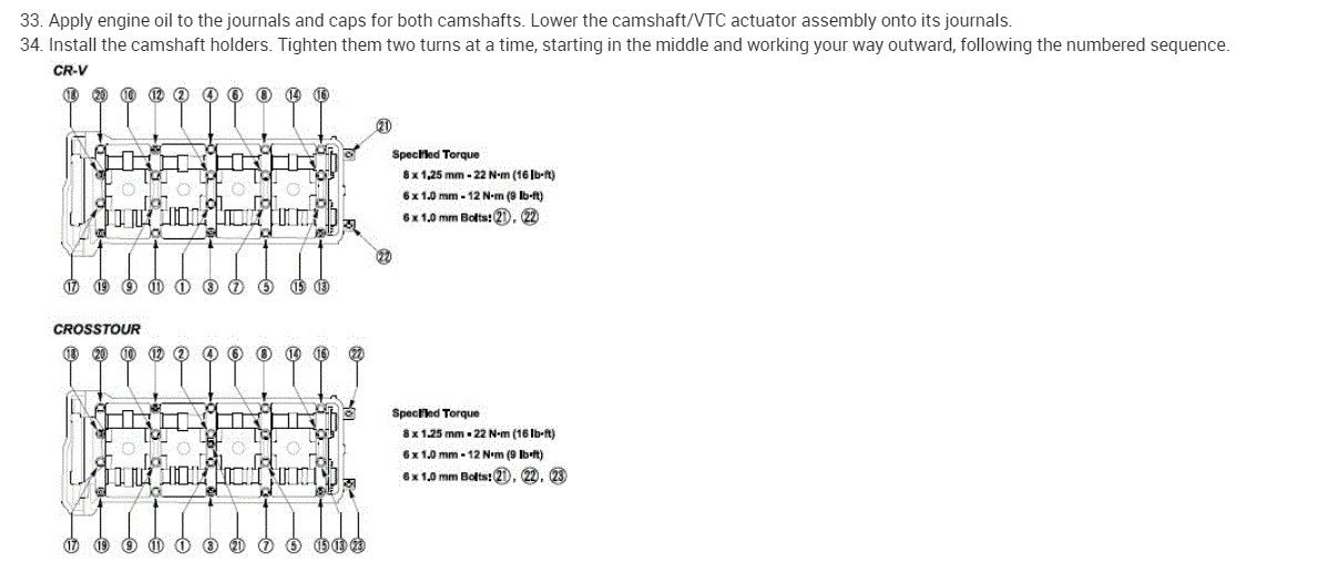

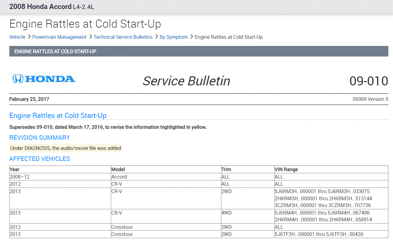

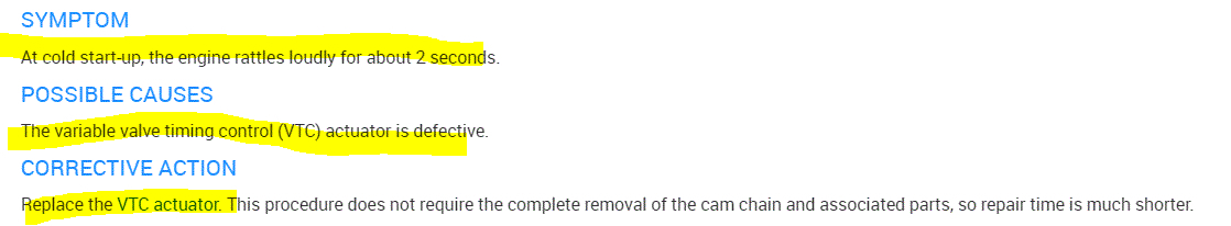

That sounds like the variable valve timing control (VTC) actuator is bad. There was actually a technical service bulletin (TSB) out related to this.

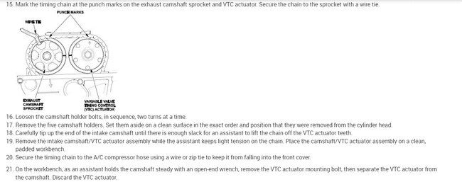

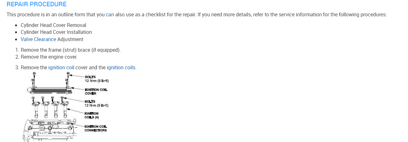

Based on what I am hearing, the VTC actuator needs to be replaced. I have attached the TSB below for your review. The TSB includes a description of the issue, how to confirm it is the problem (which I believe it is) and how to repair it.
Take a look through the TSB and let me know if you have questions. Additionally, let me know if this takes care of the problem.
