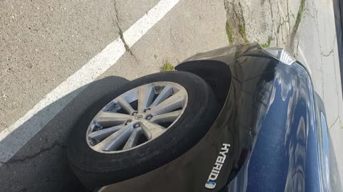

Makes loud noise from front was giving misfire for coils that's not problem. code shops don't know what's really wrong.

Yes, here is video let me know.
Mar 26, 2020 at 4:09 PM
MOH209
Makes noise when start and drives. makes noise loud noise. no heat up no leaks.

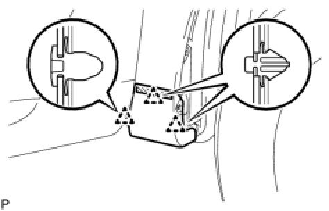

4. REMOVE FRONT FENDER MOULDING SUB-ASSEMBLY RH
(a)Remove the clip.
pic 1
(b)Using a 4 mm hexagon wrench, remove the screw.
(c)Peel off the front fender side protector and disengage the 3 clips, and then remove the front fender moulding sub-assembly RH.
pic 2

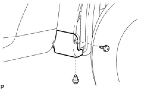

(d)Remove the pad from the front fender moulding sub-assembly RH.
(e)Remove the 2 clips No. 4 from the front fender moulding sub-assembly RH.
(f)Remove the front fender side protector from the front fender moulding sub-assembly RH.
pic 3

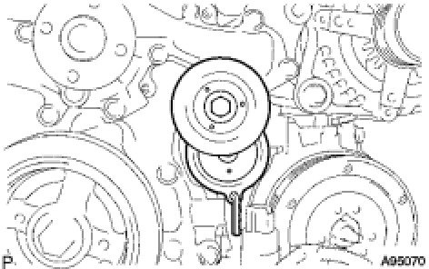

7. REMOVE V-RIBBED BELT

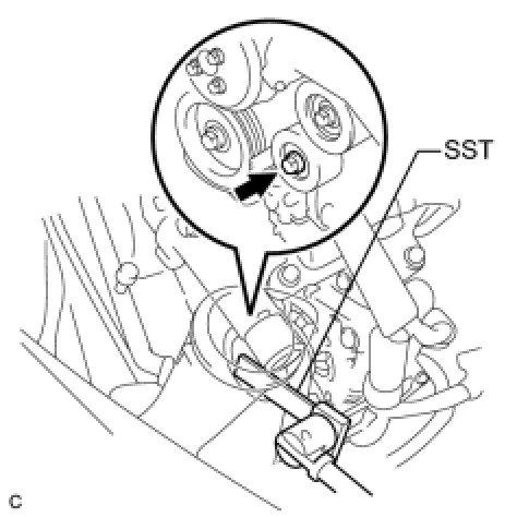

(a)Using SST, release the V-ribbed belt tension by turning the V-ribbed belt tensioner assembly counterclockwise, and remove the V-ribbed belt from the V-ribbed belt tensioner assembly.
pic 4
SST : 09961-00950

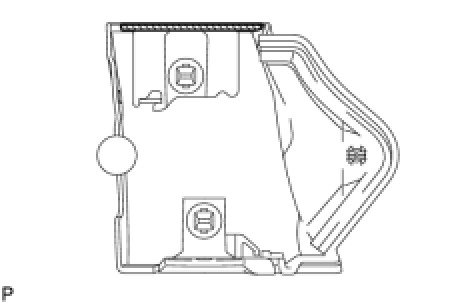

(b)While turning the V-ribbed belt tensioner assembly counterclockwise, align with its holes, and then insert the 5 mm bi-hexagon wrench into the holes to fix the V-ribbed belt tensioner assembly.
pic 5

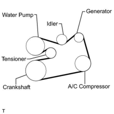

1. INSTALL V-RIBBED BELT
(a)Install the V-ribbed belt.
pic 6
(b)Using SST, turn the V-ribbed belt tensioner assembly counterclockwise and remove the bar.
SST : 09961-00950
(c)If it is difficult to install the V-ribbed belt, perform the following procedure:
pic 7
(1)Put the V-ribbed belt on every pulley except the tensioner pulley as shown in the illustration.
(2)Release the V-ribbed belt tension by turning the V-ribbed belt tensioner assembly counterclockwise, and put the V-ribbed belt on the V-ribbed tensioner assembly pulley.
